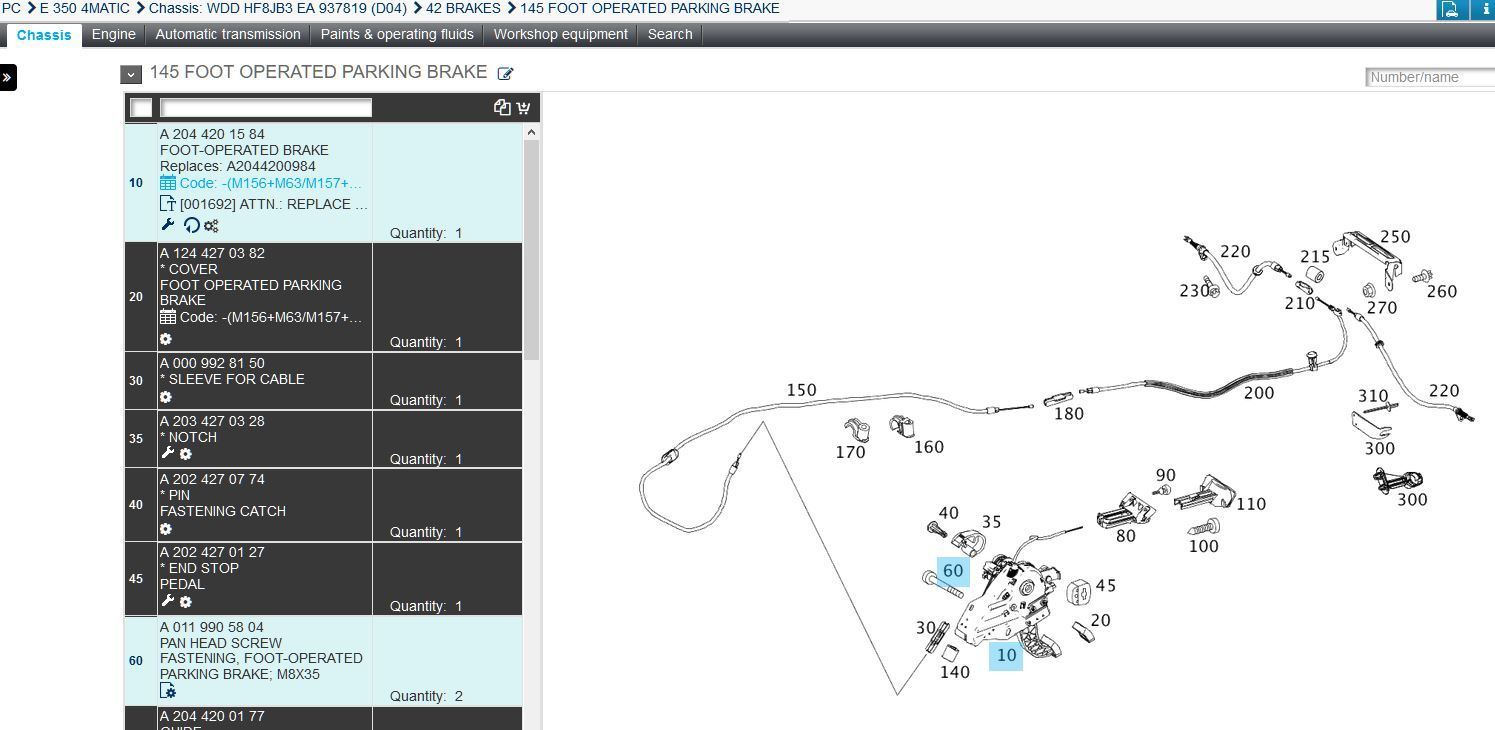

204-420-15-84 Foot parking brake
011-990-58-04 Screw w/socket drive

You can check adjustment @ rear wheels but most common problem assembly need replacement as mentioned. Part # is correct not sure why dealer replaced screws it is not required. See attachments for replacement.
