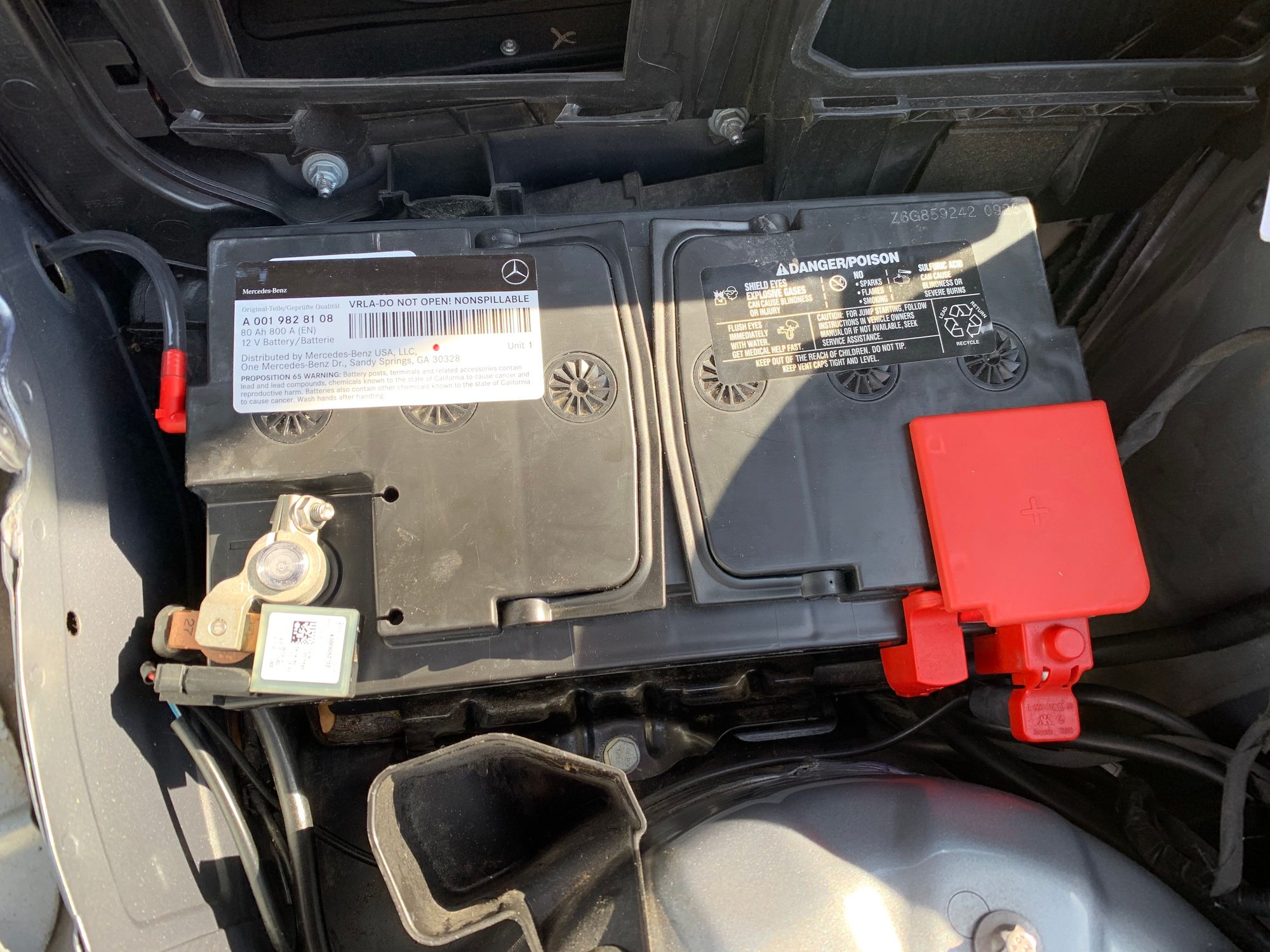

Installed the battery
one thing is the battery drain tube. where does it go? the tube is really short. got a battery from ExoParts and was around $350 CAD, genuine mercedes battery. and ECO Mode works! problem solved. Did not need to attach any battery tender, retained all memory i believe. will update later. but everything was easy!
