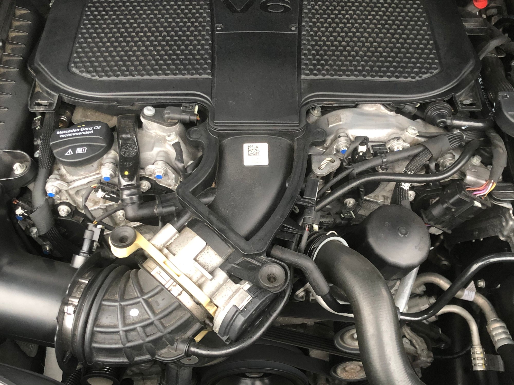

When you do a prepurchase inspection, open the two intake camshaft electromagnet connectors and use a bright flashlight to check inside for signs of oil.
The other 6 connectors (4 cam position sensors and 2 cam electromagnets) require varying amounts of disassembly to access.

Looking at this photo I am not sure I can even identify where to install the pigtails.

@LILBENZ230 Can you identify the 4 black plastic round electromagnets in the photo? On the front of the engine, on the front end of each cylinder head. Below the small screws with blue paint dabbed on them.
