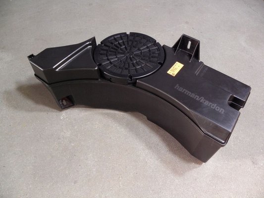

ok, taking this forward.... dug into the XEntry Parts Information for my VIN, and determined I have a plastic bass box A2128202202 somewhere in the back of the wagon... behind the left rear wheel?
it looks like this...
I read something that suggested these modules are connected with fiber optics? if thats the case, I would need to keep the module in this speaker, but remove the actual speaker, and replace it with a load resistor, wired to an amplifier to drive a real woofer put somewhere.
yeesh, thats kinda complicated. I like simple.

Pull up the forward panel (3rd row seat back), pull up and remove aft panel (3rd row seat bottom) and then pull up the storage compartment floor. That's where it is on ours, next to the spare tire.
