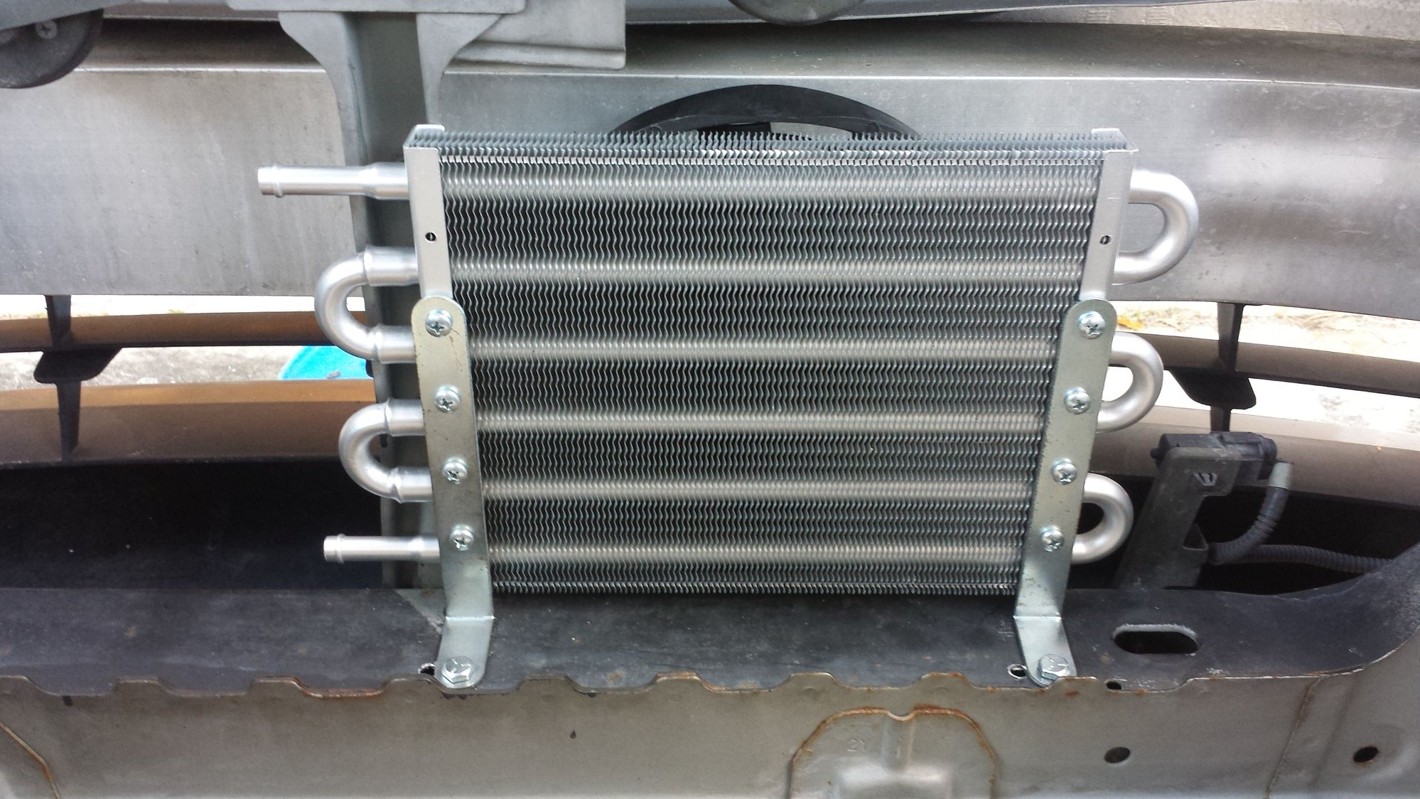

If you're concerned about a possible future failure, you can run an aftermarket transmission cooler and just remove the lines from the radiator and run extensions to the new cooler.
I ran an aftermarket Mishimoto tranny cooler with a fan on my 2003 Nissan Maxima during a 2016 engine swap project I completed a year and a half ago. Nissan used an integrated tranny cooler also. I replaced the stock radiator with a ginormous, dual row aluminum Mishimoto radiator that didn't have an integrated tranny cooler. I live in Tampa, so I didn't want any cooling issues.
Piping and mounting the cooler was about as simple as it gets. I haven't even wired up the fan and the tranny stays at or below coolant temp. Do you think the W212 would be safer in the long-run with an external cooler? Do you believe the risk factor is high enough to warrant an external cooler as a safety measure? I want to keep mine forever, and I'd rather not have to replace a $7k tranny that should last the life of the vehicle. Thanks!

I feel it's absolutely safer with an external trans cooler. There is NO WAY it can fail and mix the fluid if they are seperated. It doesn't seem to be a huge problem, but it certainly won't hurt anything either.
I agree. I really like the Mishimoto cooler that I have on my Maxima. There's also plenty of space between the condenser and the front bumper cover/grille. I'll poke around and look into it. First thing on my list with this new car is timing chain tensioners and cam solenoid O-rings. I have the dreaded oil leak on both banks at 85k on mine and it has never been done. I may order a passive heat exchanger rather than a fan-cooled unit for the Benz.

Thanks Senecan and nota amg, the local shop did the work and installed the OEM radiator with integral trany cooler. I'll see if there is room to install the Mishimoto cooler. I believe there is. They also installed new cam solenoids and o-rings as mine were leaking. 84k mile on it now.
