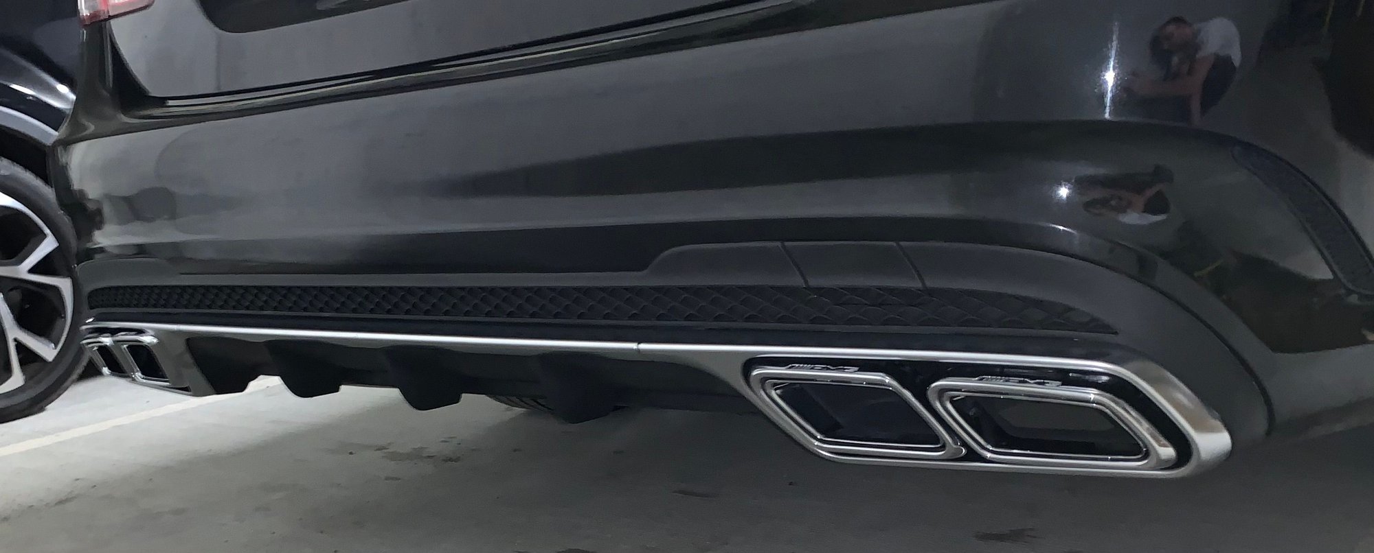

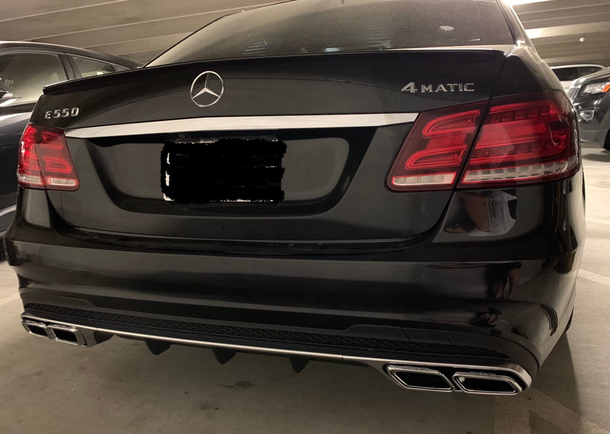

Terrible Mistake lol looks great sounds awful
It sounds nothing like an AMG obviously.. That being said I'm buying a pair of AMG mufflers off eBay this week or if anyone has them for sale on here please message me.. My one question to you guys is if I could find a pair of W213 E63 S amg mufflers vs W212 amg mufflers would there be any advantage over one or the other or do you know if one pair of muffler sounds better than the other I know that the comparison would be hard since the newer AMG's have smaller engines and they would be going on a non AMG car.. Also When I do put on the AMG muffler should I go ahead and have the primary resonators deleted?
I just put on the E63 diffuser and tips they look Great! But sounds like SH*T lmao
Right now I have a resonator delete + X pipe and muffler delete
Old Apr 18, 2021 | 08:46 PM
ghlkal's Avatar
Joined: Jul 2015
Posts: 1,071
Likes: 349
From: Fredonia, WI
2012 E550 v8-Biturbo
Looks great
Good luck with the project
Old Apr 19, 2021 | 11:18 AM
RA72825's Avatar
Joined: Oct 2005
Posts: 4,957
Likes: 1,640
Looks great, but does kind of sound like a pissed off bear.

[QUOTE=DaveS500;8317901]It sounds nothing like an AMG obviously.. That being said I'm buying a pair of AMG mufflers off eBay this week or if anyone has them for sale on here please message me.. My one question to you guys is if I could find a pair of W213 E63 S amg mufflers vs W212 amg mufflers would there be any advantage over one or the other or do you know if one pair of muffler sounds better than the other I know that the comparison would be hard since the newer AMG's have smaller engines and they would be going on a non AMG car.. Also When I do put on the AMG muffler should I go ahead and have the primary resonators deleted?
[QUOTE]
Downpipes change the sound completely but that didn't sound horrible. Where did you get that diffuser from? that looks nothing like my factory ones on my 16

[QUOTE=BlownS4;8318683][QUOTE=DaveS500;8317901]It sounds nothing like an AMG obviously.. That being said I'm buying a pair of AMG mufflers off eBay this week or if anyone has them for sale on here please message me.. My one question to you guys is if I could find a pair of W213 E63 S amg mufflers vs W212 amg mufflers would there be any advantage over one or the other or do you know if one pair of muffler sounds better than the other I know that the comparison would be hard since the newer AMG's have smaller engines and they would be going on a non AMG car.. Also When I do put on the AMG muffler should I go ahead and have the primary resonators deleted?
https://www.youtube.com/watch?v=KWd47NSTArQ
Yeah I need e63 mufflers ASAP and then I’ll have them delete the resonators right after the cats so then it will be straight pipe from the cats to the mufflers
The diffuser along with all of the parts are OEM straight from the local Herdrick Benz stealership here in NC
Here’s the thread where I got the part number list from one of the members, except for the diffuser trim I decided to go with the brushed stainless look instead of the midnight package. What does your diffuser look like?
https://mbworld.org/forums/e-class-w...ml#post8318421
