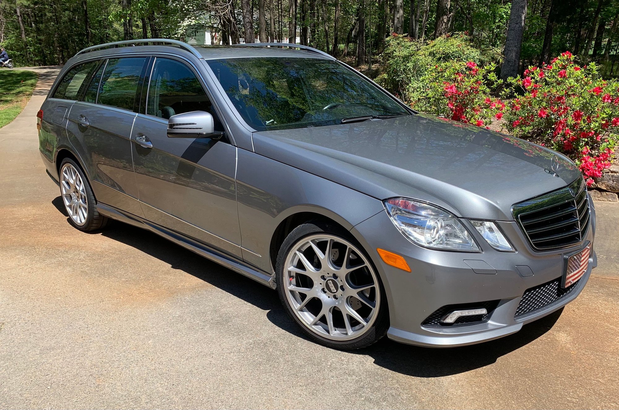

Running Cup 2s on my 2011 E350 4matic wagon
245/35-ZR 19 on 19x8.5 offset: 40mm wheel - front
265/30-ZR 19 on 19x9.5 offset: 45mm wheel - rear
No problems at all...
