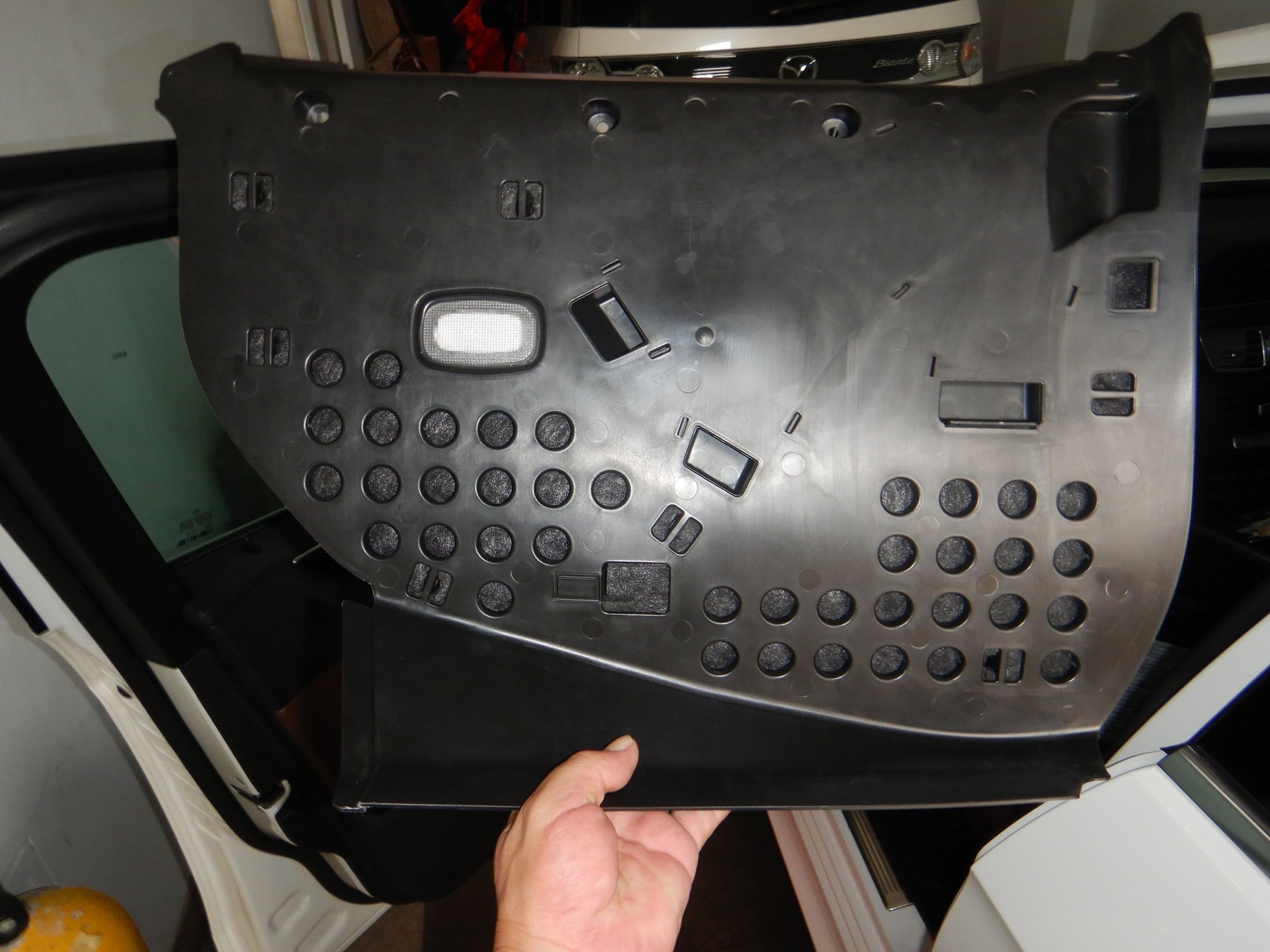

I found this video which shows both connectors clearly. Thanks again, Zavato...

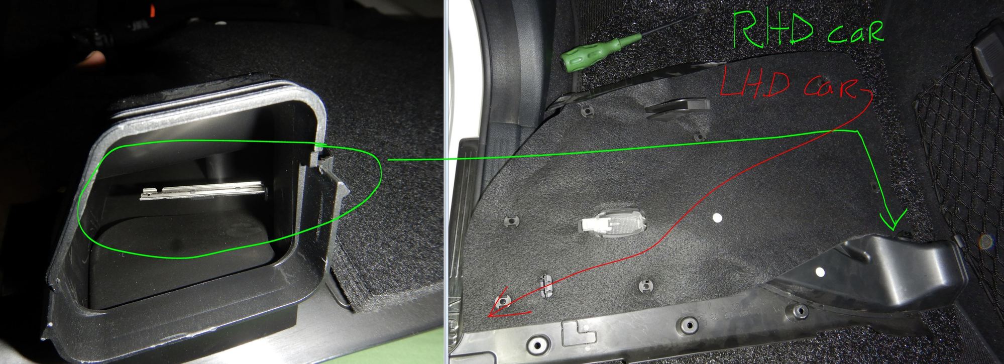

Here u go...........
Yes.... please play with your icarsoft MB V3.0 and let us know what it can do more than the V2.0 and hopefully more sensors it can read.

This morning (when it was cooler) I was able to get into that footwell and drop the panel. Just as CaliBenzDriver and Zavato predicted, the left-hand sensor cable was dangling loose, saying "please reconnect me." Done. It took more time for me to find some concrete floor padding for my ultra sensitive knee replacements.
Thanks to Zavato, CaliBenzDriver and S-Prihadi for all the help.
I then retested the module using the new scanner and it came back "passed." I took some pictures of all the screens offered with the V3.0 and will post a new thread to describe them later.
