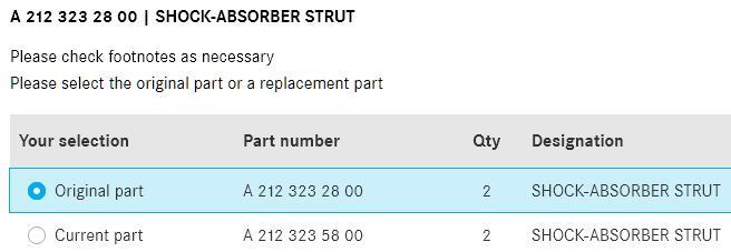

Here's what MB parts catalog shows.
Thanks for this info However I am worrying about the different shape of the mounting points between knuckle and the damper; current damper is connected to the knuckle with two bolts in a longitudinal direction, but the picture of the catalog shows the bolts in a lateral direction...
This was the reason why I try to find the new damper with the exact damper part number..

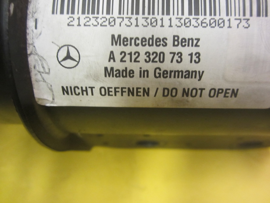

Here is another picture for the same part number, but we can now see the OEM manufacturer; SACHS, and their part number.
NOTE: look at the RED rectangle, it seems MB put a sticker on top of another part number A 212 32x yy zz.. Does your part have the sticker? perhaps carefully removing it will show another part number. Fingers crossed.
What surprises me is that the MB online parts does not even show this part number is obsolete, and replaced by something else (as usual). The datacard posted by Konigstiger indicates the car was produced for the USA/CAN market, so it should show in the MBUSA databases.

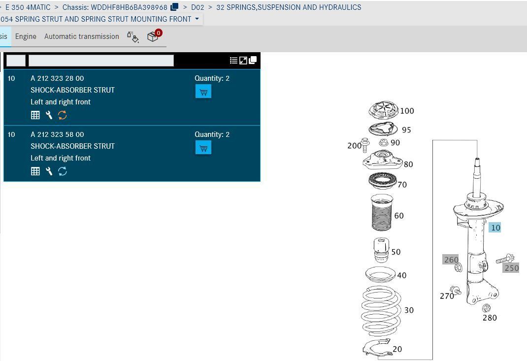

4matics do in fact have a different connection to the knuckle… that said, I wouldn’t put too much stock in the line-art of the parts catalog.
What Konigstiger provided is what any dealer would use to determine the “correct” part. If your still worried, order from a dealer with VIN provided that way if there’s issues, shouldn’t be, they’ll take care of it.

2123232800 looks like a proper 4matic strut
https://lmgtfy.app/?q=2123232800&t=i
For me too!! Wow thanks a lot
