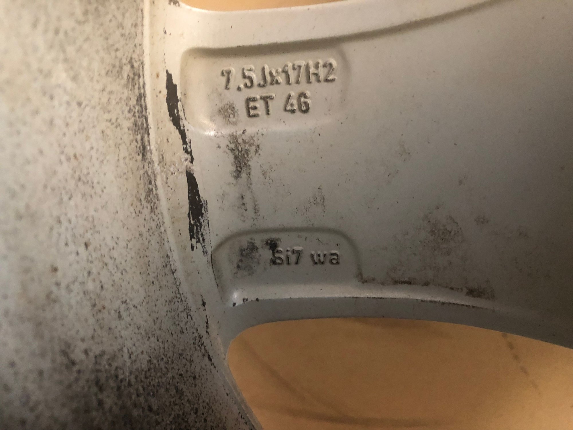

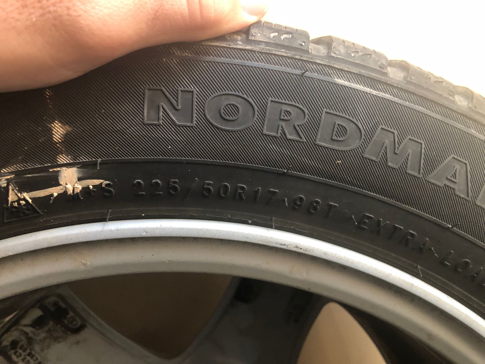

I am running a 225/50/17 on a 17x7.5J ET 46 wheel. For snow (VT snow, not your once every 5 year snow in TX), it is preferable to have a narrower tire for traction. The extra sidewall is a bonus and it does ride softer than stock 245/40/18. It doesn’t handle as well but it’s silly to consider a studded snow tire for it’s handling.
I purchased the wheels on EBay, I believe they were off a 2004 S500. The depth of the lug holes were different so I had to buy longer lug bolts. If you’re buying aftermarket the other important measurements are bolt pattern (5x112) and centerbore (66.6). I found wheel-size.com to be a very helpful website when researching what wheel fits what. There are lots of Mercedes wheels on EBay. I bought a set for winter for my Wife’s GLE that look identical except 1” smaller in diameter.
As others have pointed out it is the ball joint that is the limitation on 4Ms, not the brake components.

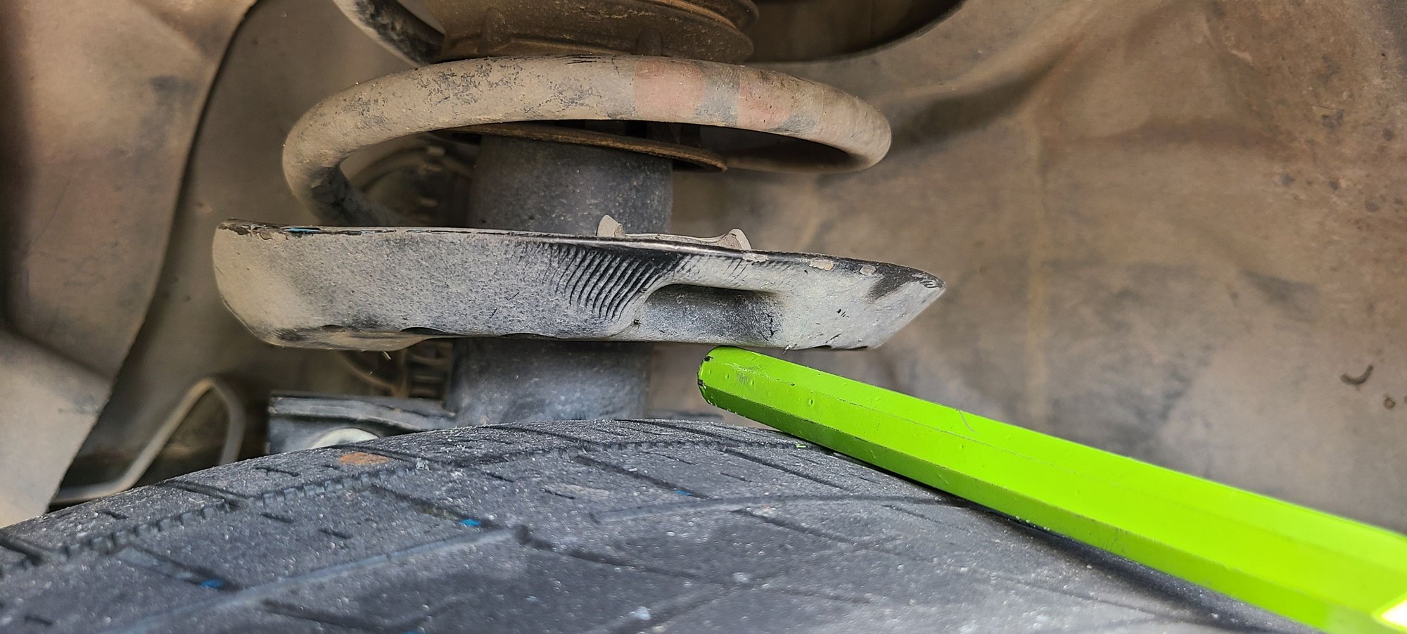

huh, I thought I had photos of the rim clearance on the front 17" wheels on my 2016 E350 4matic 'luxury' wagon... but I can't find them. anyways, its close, like a couple mm close. but it never touches.
I am quite positive these wheels would fit on any facelift 'sport' E350 sedan or wagon, 4matic or not. no, I doubt they fit on a V8 or AMG car

This is a picture of the driver side front ball joint with a 17" wheel installed.
