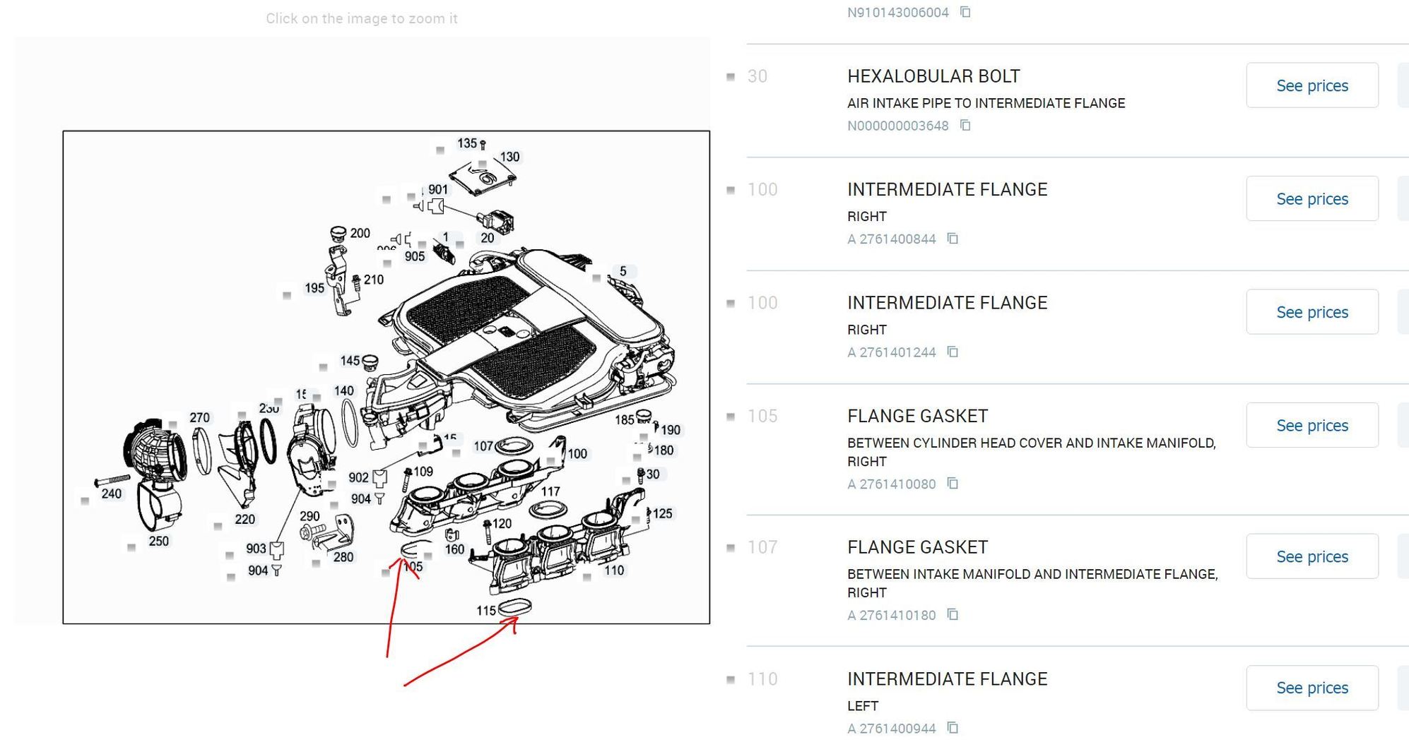

Buy the seal #105 for intermediate flange, you need it anyway and use it as a template. That seal would be probably maximum 3-4mm bigger all around than actual port opening on the engine.
Go to my link below and you will know what I mean, yes my engine is the M276.820 3.0 Turbo and not 3.5 NA.
https://mbworld.org/forums/e-class-w...eaning-p2.html
Item 105 : https://www.fcpeuro.com/products/mer...ing-2761410080

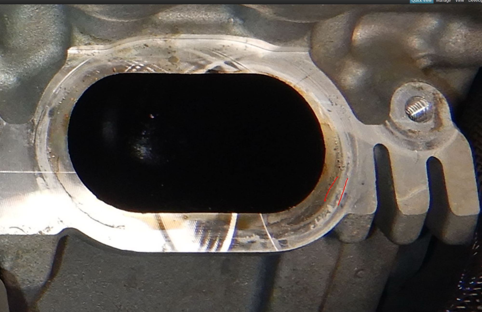

See the traces where my equivalent seal #105 was sitting on the intake manifold.
Below : Guesstimate where the seal #105 was seating at

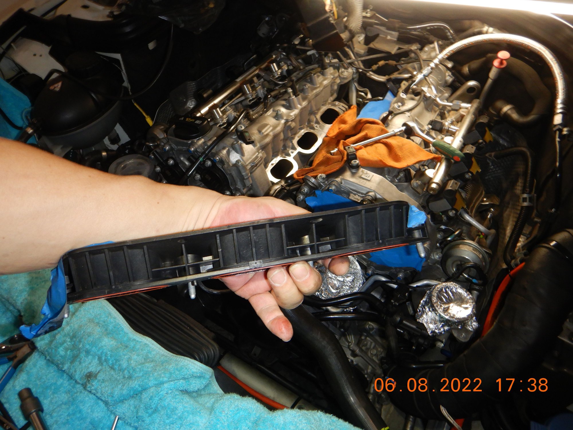

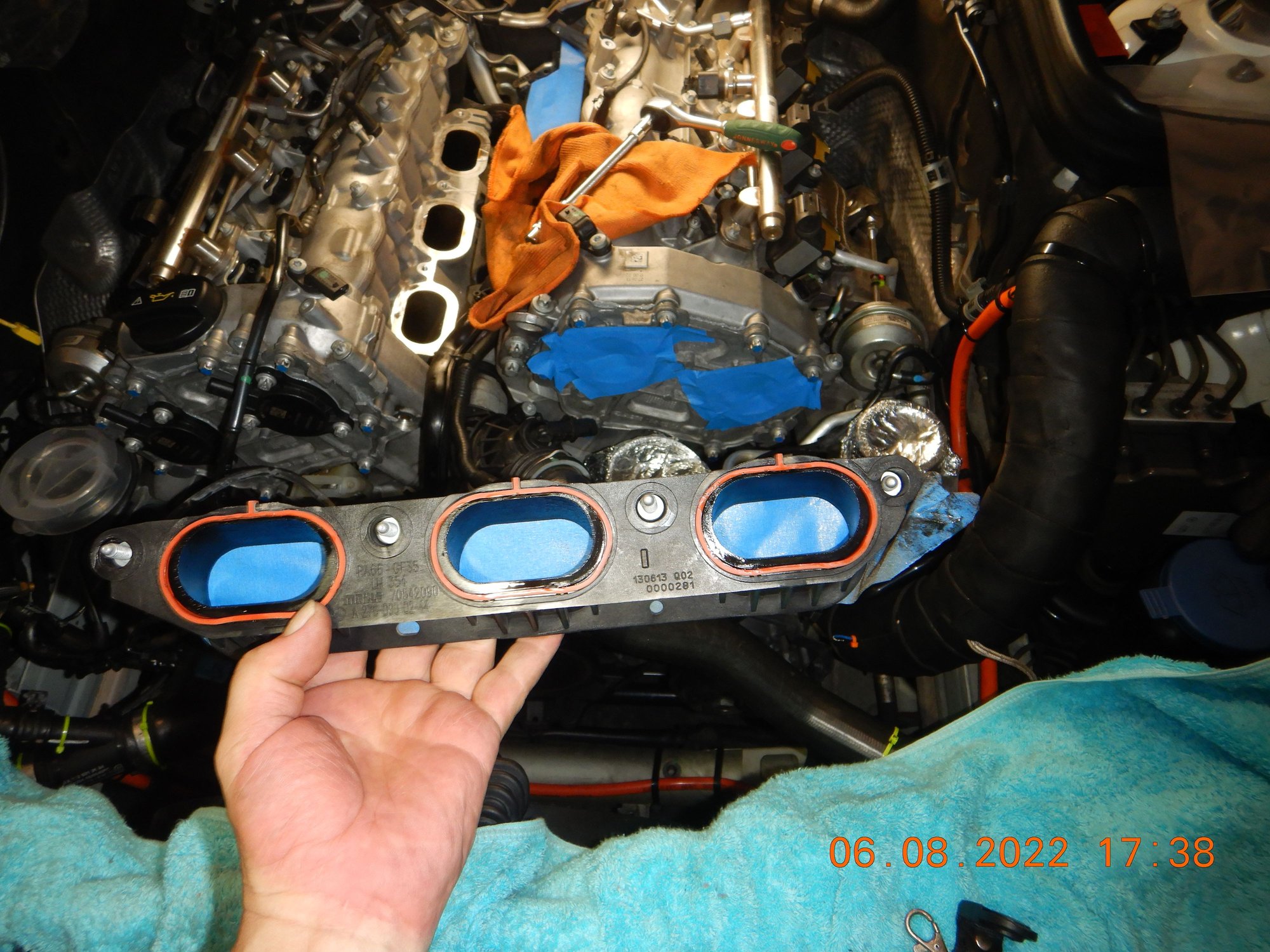

This is the equivalent of my seal of #105 if it were for your engine

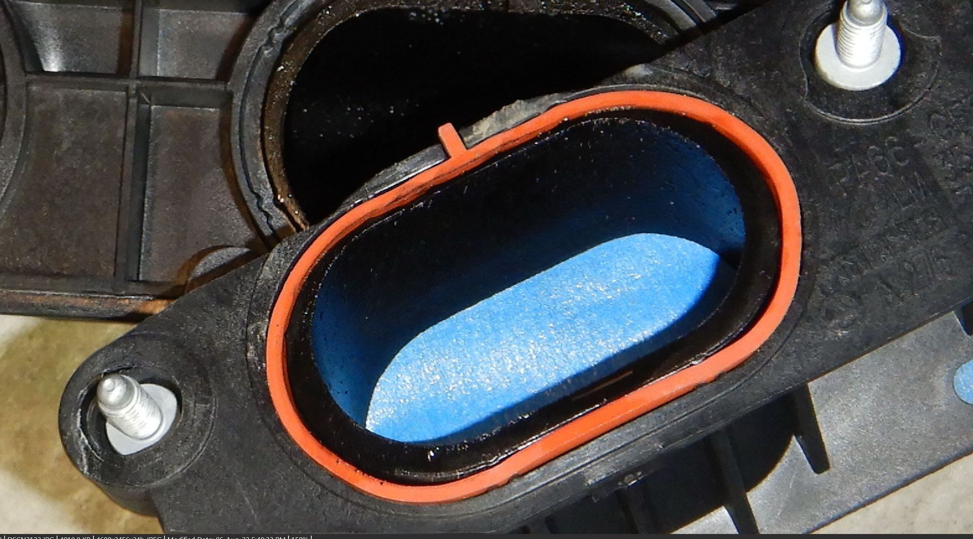

Close up
Wide angle
