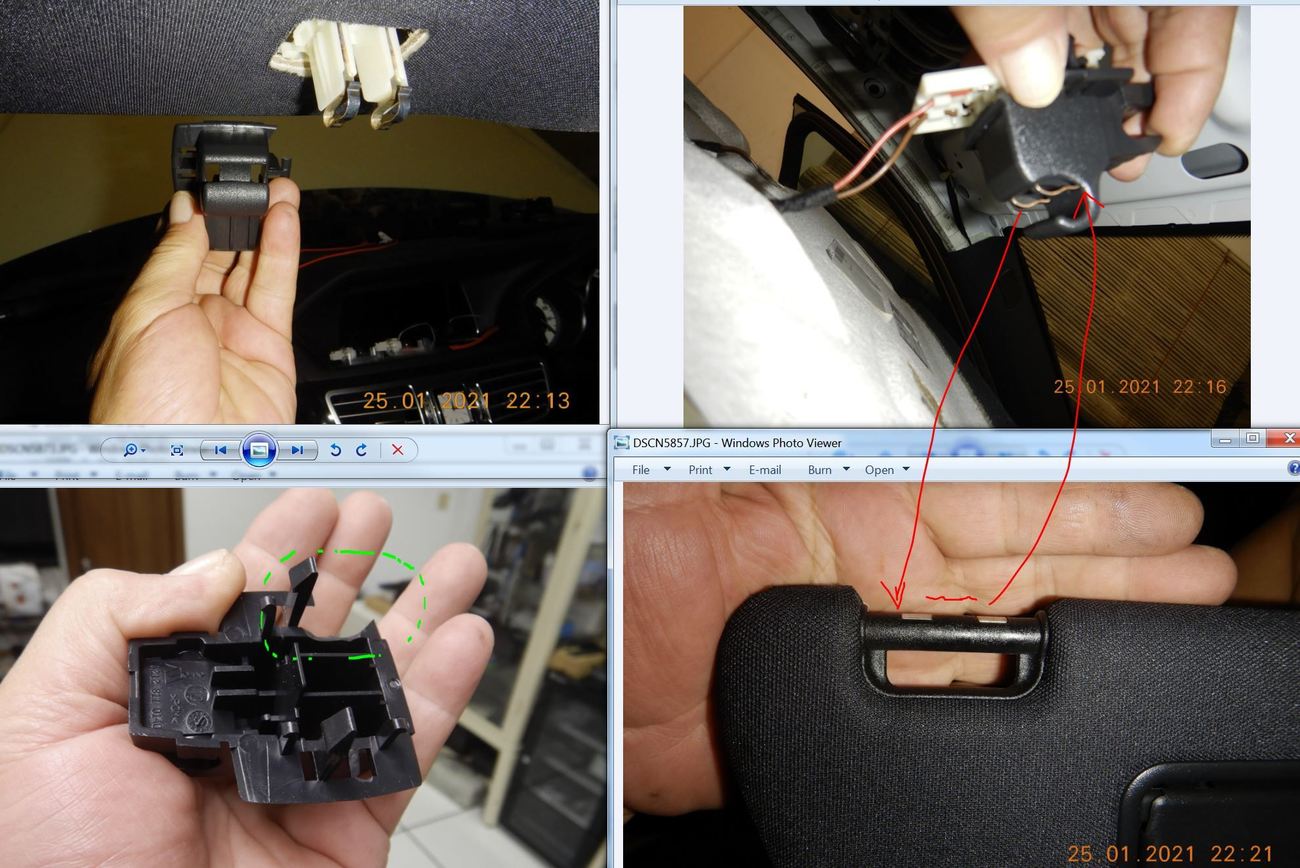

I am out of country, meaning no PC access, so no photo database.
However, I recalled doing the roof liner removal to tighten my dumb-azz pano roof frames.... I had to remove BOTH sun-visors and broke the parts below:
https://cimg5.ibsrv.net/gimg/www.mbw...cec841eb96.jpg
Original post is here on the pano :
https://mbworld.org/forums/e-class-w...very-much.html
Let's call this broken part as a C-Clip, it does offer friction , so it can prevent sagging on sun-visor. I broke mine when removing it. LOL
The other attachment of sun visor to car roof is the "rod" of the sun-visor , I recalled it has o-ring...yes rubber o-ring.
I forgot the o-ring is at which part of the L rod, the spin-left-right function or the up-down function.
I honestly can't remember a 100% how my sun-visor looks like , but I believed it has a smaller blade/2nd-visor too for driver side, like below unit :
https://www.ebay.com/p/525391506
If you slowly inspect , how the sun-visor really works in terms of friction generating areas, you can correct your "sagging" problem.
It is all in the friction, the lack of friction for your case.
Good luck
