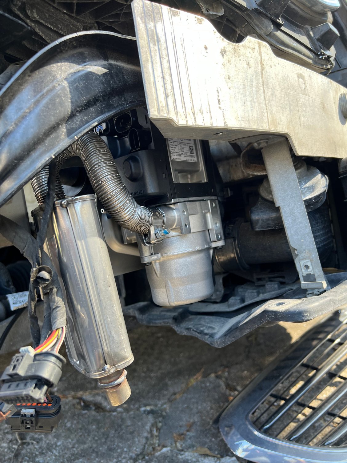

Stationary heating is not available on the USA. Webasto manufacturers a heating unit that Mercedes’ uses for cold climate countries. The unit fits under the front right headlamp assy. It uses fuel from the tank to ignite a burner element that heats coolant. This warm coolant is circulated to warm the engine and interior cabin. I will break down installation into three stages.

Heating unit mounted Two plugs are installed on heater.
Front view showing muffler.

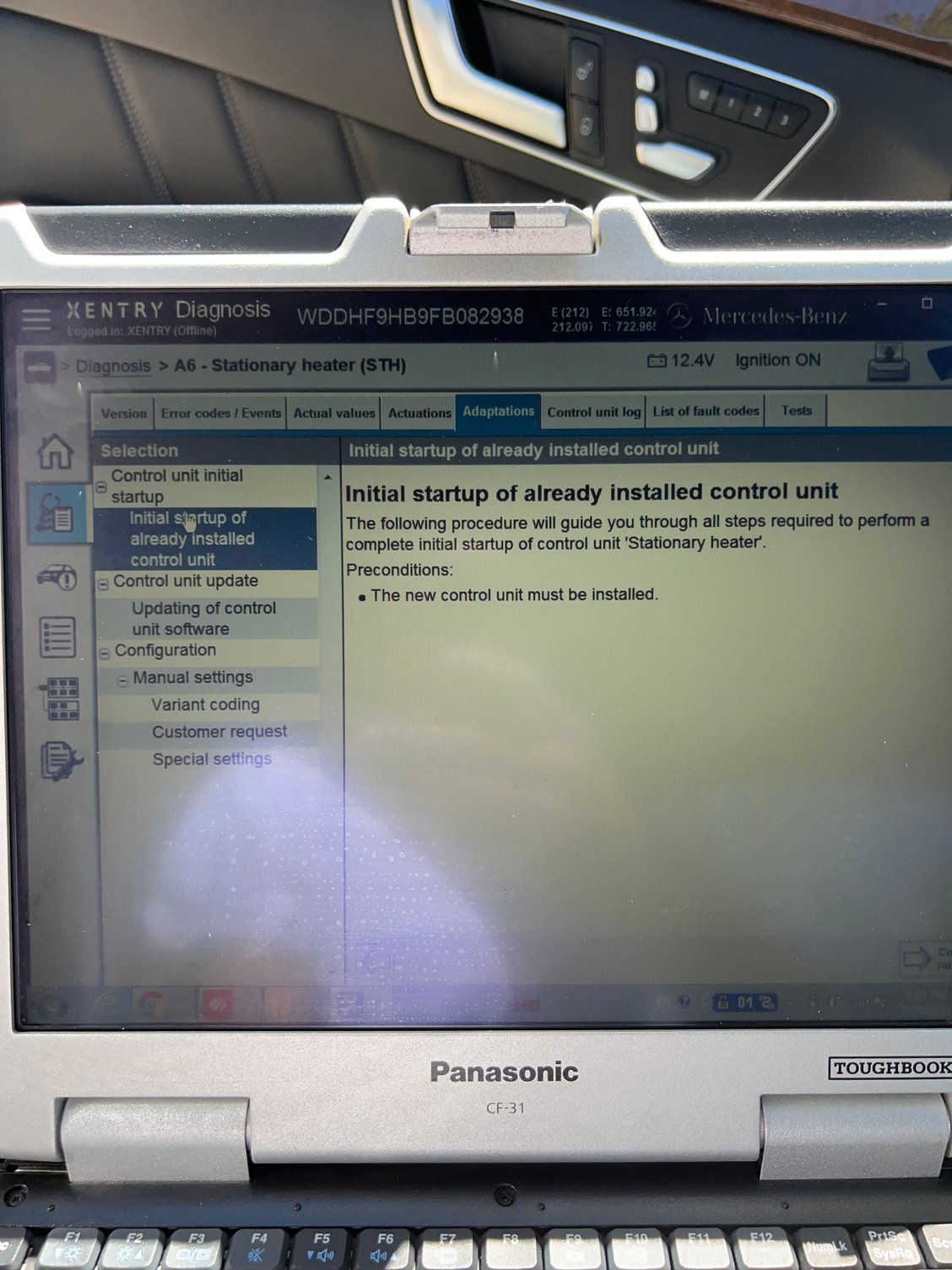

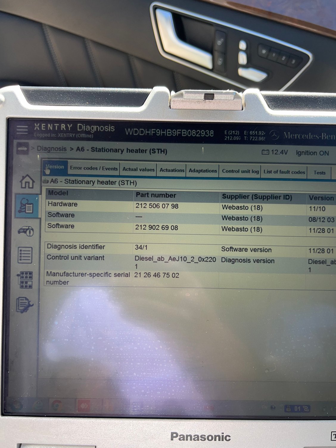

Initial startup will be done once fuel line is installed.
Initial connectivity using xentry shows the module is visible with current firmware installed.

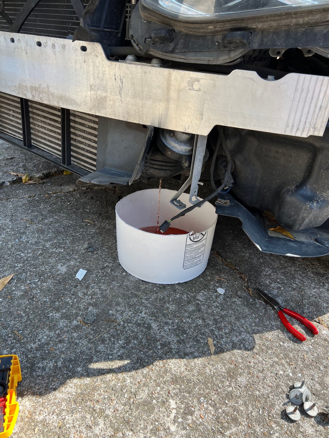

Started installation of all coolant lines. First drained all coolant at pet **** on driver side.
New silver line connected to black hose from heater core connection under wiper motor
Running this line along firewall was painful

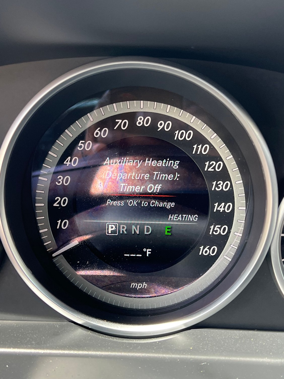

From: Houston, TX
2015 E250D
After proper coding of the central gateway, the parking heater menu shows up in instrument cluster. This allows activation of the heater on predefined times.

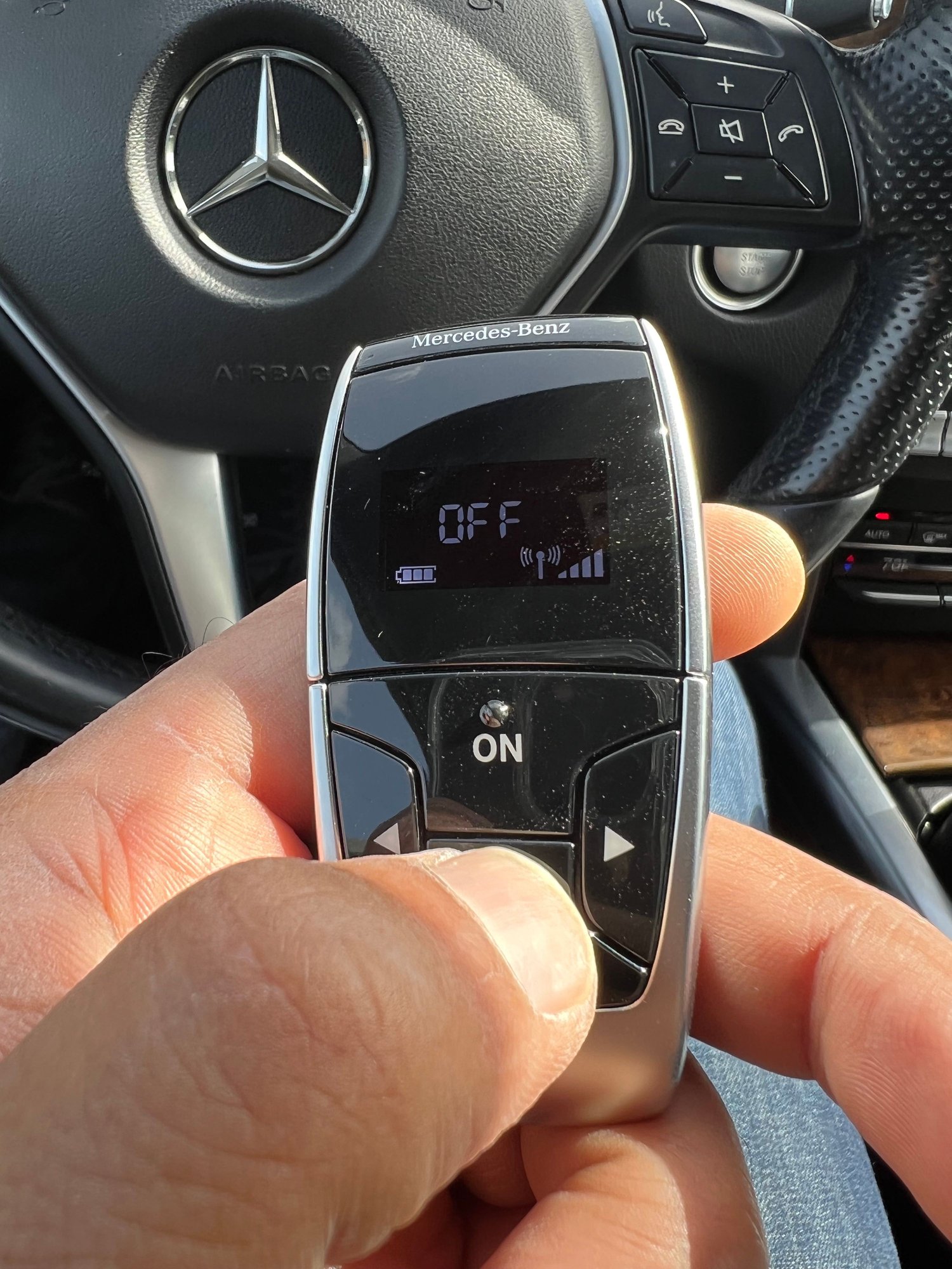

small update. I was able to install the receiver in the trunk floor and marry the remote to the car using xentry.
