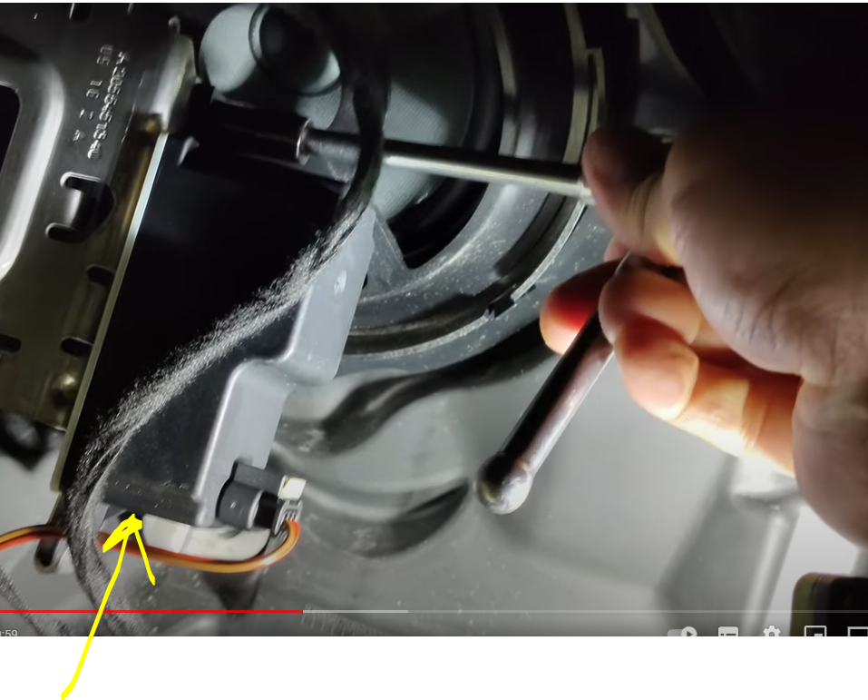

amazing upgrade...
I think at some point MB vendors nailed a better design.
They converted the good AUX AGM into a module stuffed with 4 or 5 capacitors of 1Farad.
When that module gets stressed, it chacoals its PCB... no repair! Unlimited currents cooks all.
New unit only (not used!)
Located at front passenger footwell, yes?
The question becomes : How To Prevent Killer Currents?
- test for disfunctional yo-yo voltage
- clean GND including main strap.
Guess you referring to the one above, like used in the GLC300. Here is a video as it is installed in the GLC
Old Feb 6, 2024 | 05:30 PM
CaliBenzDriver's Avatar
Joined: Apr 2019
Posts: 11,923
Likes: 6,776
From: Silicon Valley
W212 MY'14 M276-3.5NA @75kMi
yes, exactly! That's the new virtual lead-free battery.
My 2¢ says you don't need to mess with the side carpet or the plastic threshold piece.
Go ahead have a look, I recall the footwell carpet pulls back from the top.
Of course one can remove everything out carefully, replace the broken plastic threshold pieces, roll the carpet nicely...
or take a quick shortcut.
