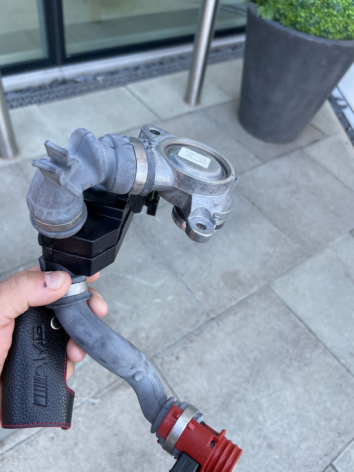

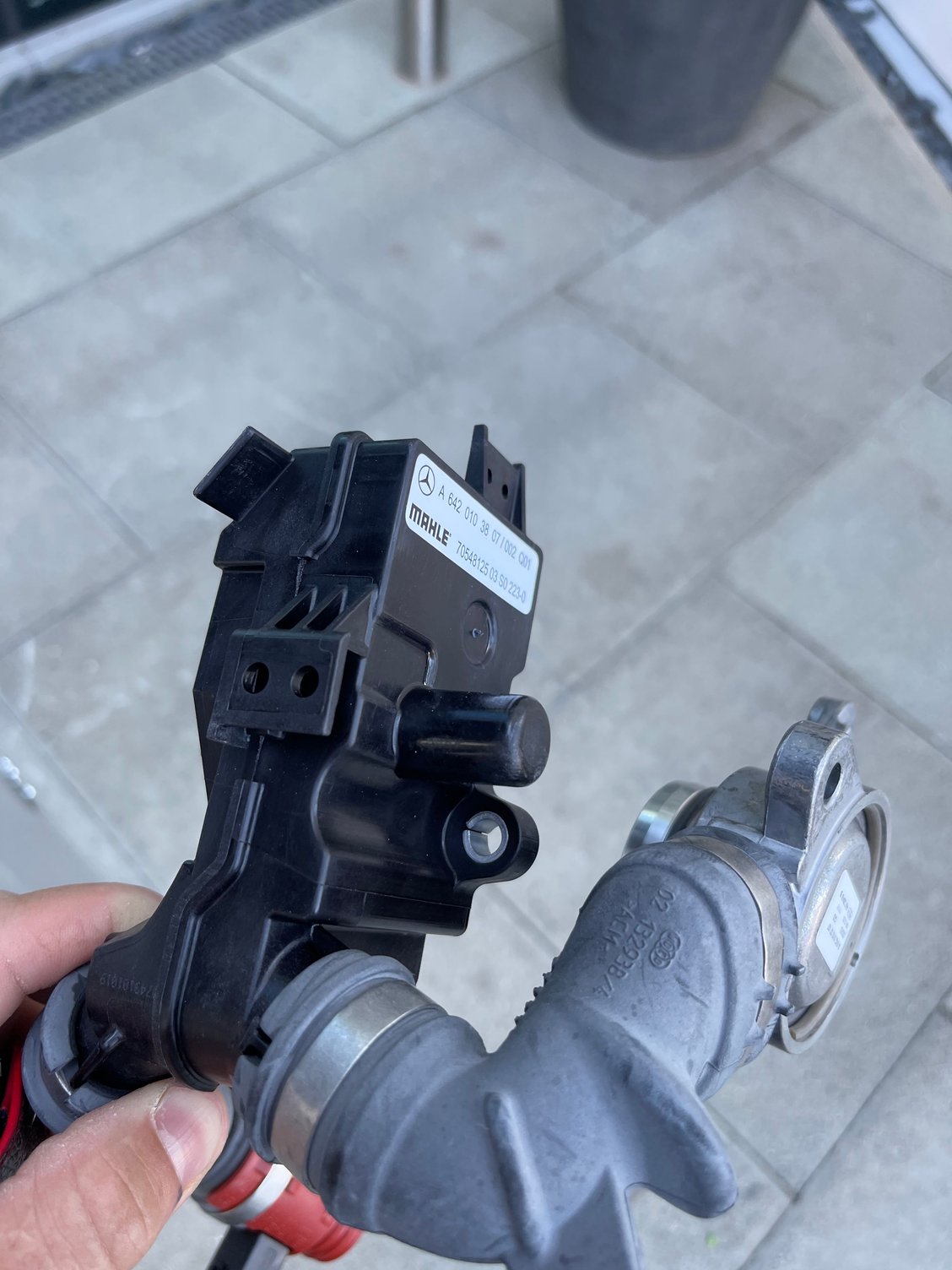

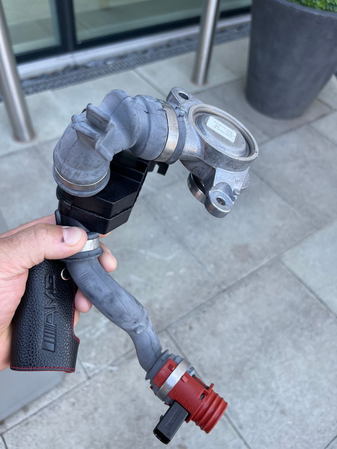

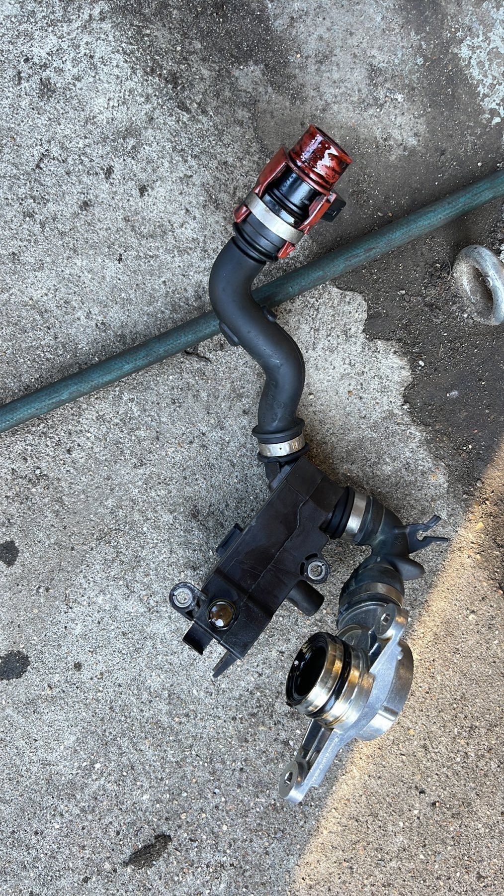

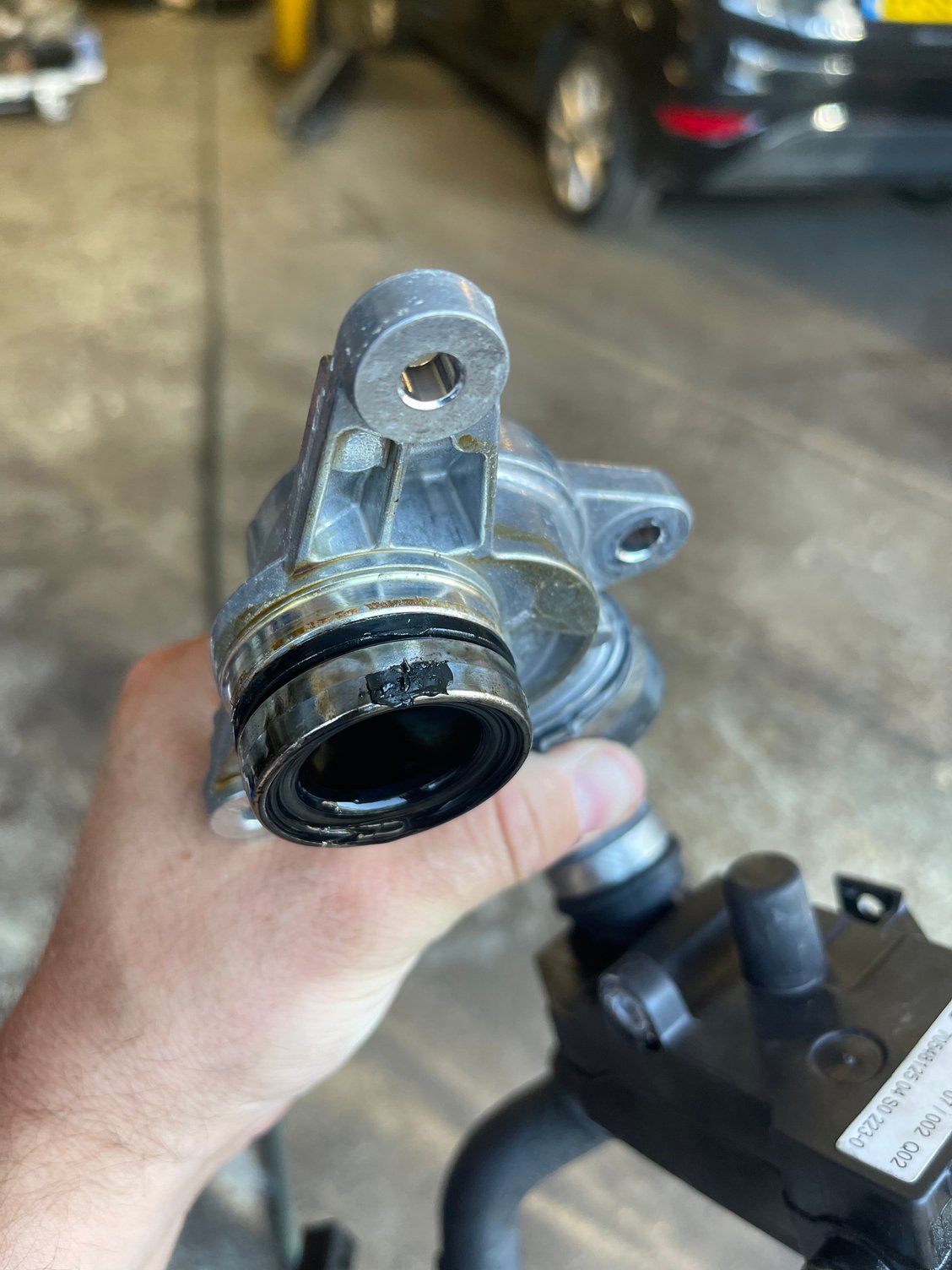

Hi I don’t know if you remember me or you can see that the chats we have today is ago about the problem I was having with my car
I did change the PCV valve
seems to runs better than before and starts better than before but I was just on undering if I still have to change the airflow meter
thanks
This is my new PCV valve
And this is the old one
