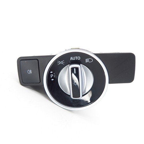

My rotary light switch is this one : There is no OFF ( zero )

On Auto with the light feature enabled then all the lights are on and the only way to get the LED stripes active is to turn the dial to the left so only Parkers are selected and active, it's looking like another weird Jap only feature.
