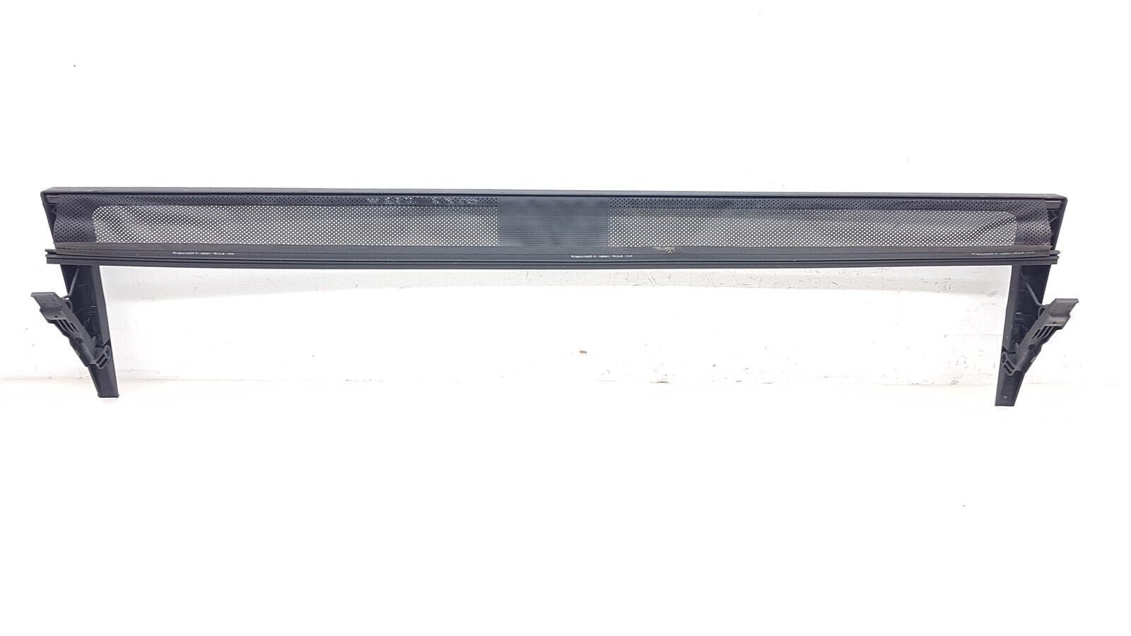

Hello. I've been chasing a rattle in my 2011 e63 pano roof. The noise my car makes sounds like carrying a plate of dishes when going over rough roads. Turned out to be the wind deflector banging against the pano roof in the front. I layered up some duct tape and put it on the underside of the pano glass in the center of the car. Now the wind deflector hits against the tape and doesn't make the rattle noise any more. I guess mercedes forgot to install the duct tape at the factory!

So when your wheel bolts female thread at the hub get loose from thread damage, I guess you can duct tape it too
The deflector has a spring to keep proper tension when erected ( pano open ) or when pushed down by pano front roof ( pano closed ).
It has also a small leverage arm to hold that spring. Check any of these 2 are broken or loose or whatnot.
Go here to see how the wind deflector is when removed. https://www.ebay.co.uk/itm/175846305068
ABOVE : That fabric like a fish net, its bottom end must be attached to the front small glass. I never removed this wind deflector, so I can't explain the fabric end method to be locked to the small
front glass #100 in EPC at bottom of this post.
Below is what can make the wind deflector loose its ERECTION Inspect the spring and this small leverage arm
You can buy the spring stand alone #120, but not the small leverage arm, which you need to buy the entire wind deflector item no #110
You know, I have to thank you for this post. Because of you, I actually took a visit to Pano Roof EPC and learnt that the seals of the glass edges #210, #220 and #230 can be bought stand alone,
I have always thought it was part of the glass and can't be bought separately.
Still, go and fix you wind deflector properly and don't teach people bad MacGyver method.

Thank you so much for sharing this information! I will check the spring mechanism. I assumed it was not serviceable and only sold as an assy. I'm not really sure if the spring is weak or the rubber seal is not as thick as it was new. The duct tape did resolve the noise for me and was free. I would not recommend tape to fix real car issues, but for rattle repair, I don't see any concern. I am familiar with McGyver, and I will definitely take that as a compliment!
