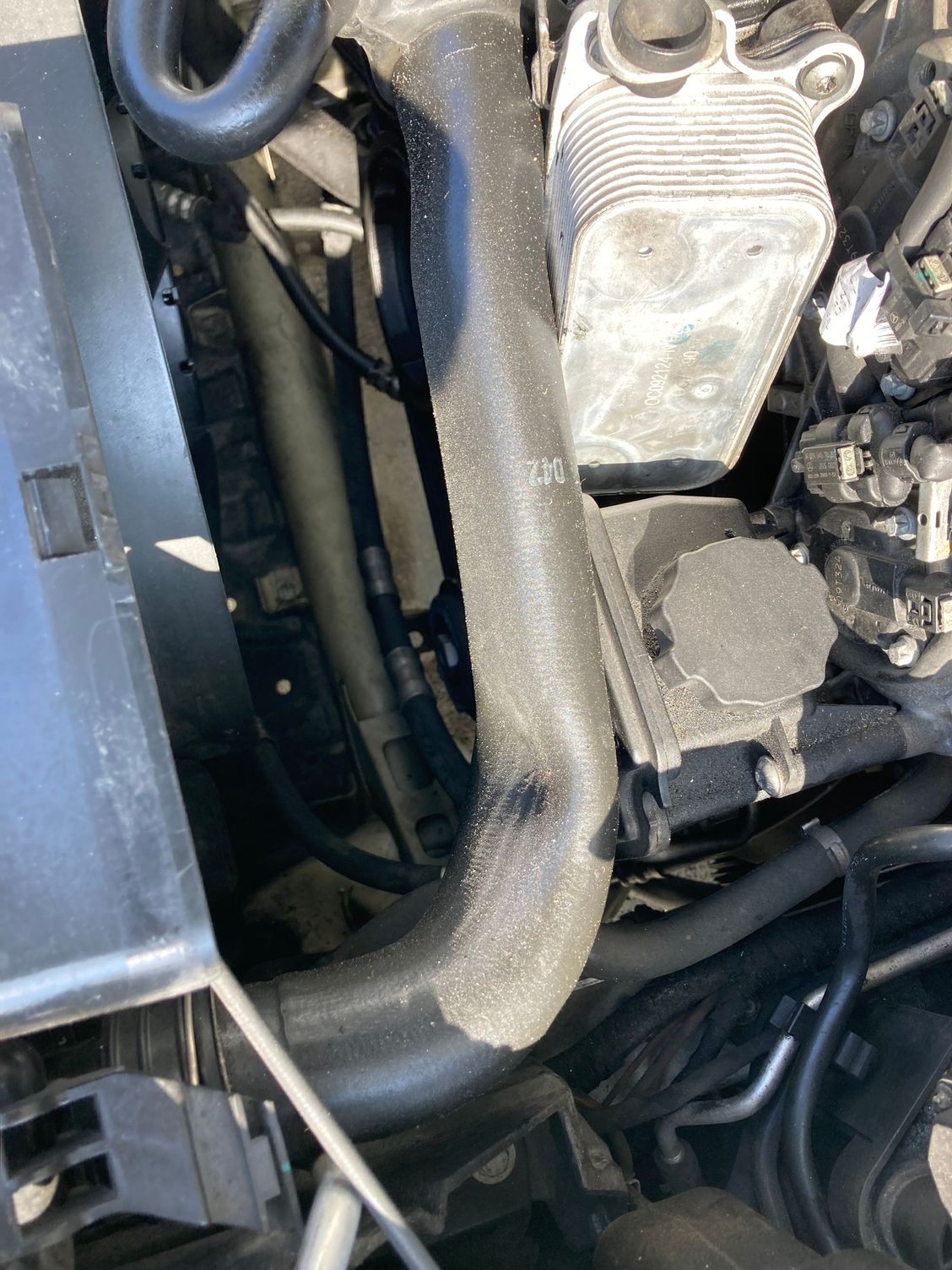

Hello, first-time MB owner over here. I have tried looking for images but I can't get a good glance to compare.
Are these hoses healthy or are they due to be replaced? Are they even the correct ones? I find it weird that they are skinny at certain angles. My gut feeling tells me something is odd but perhaps this is a MB design.
Thanks in advance.

Do you have the service history of the vehicle and what is its mileage? Is there evidence of a coolant leak in the engine compartment or underneath your vehicle? If you have just acquired the car as preventative maintenance I would drain the coolant and replace all radiator hoses due to the age of the vehicle if it hasn't been done previously. I try to diy as much as possible on my vehicle and have so far replaced the thermostat which failed and the coolant at 90k miles. I'm planning on changing out all the coolant hoses in the spring or summer. In the first photo, there appears to be a depression in the hose but as long as there isn't evidence of a leak, I wouldn't be overly concerned.

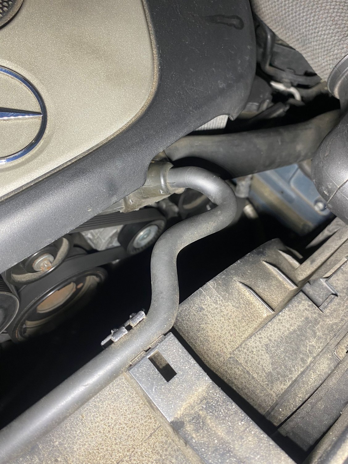

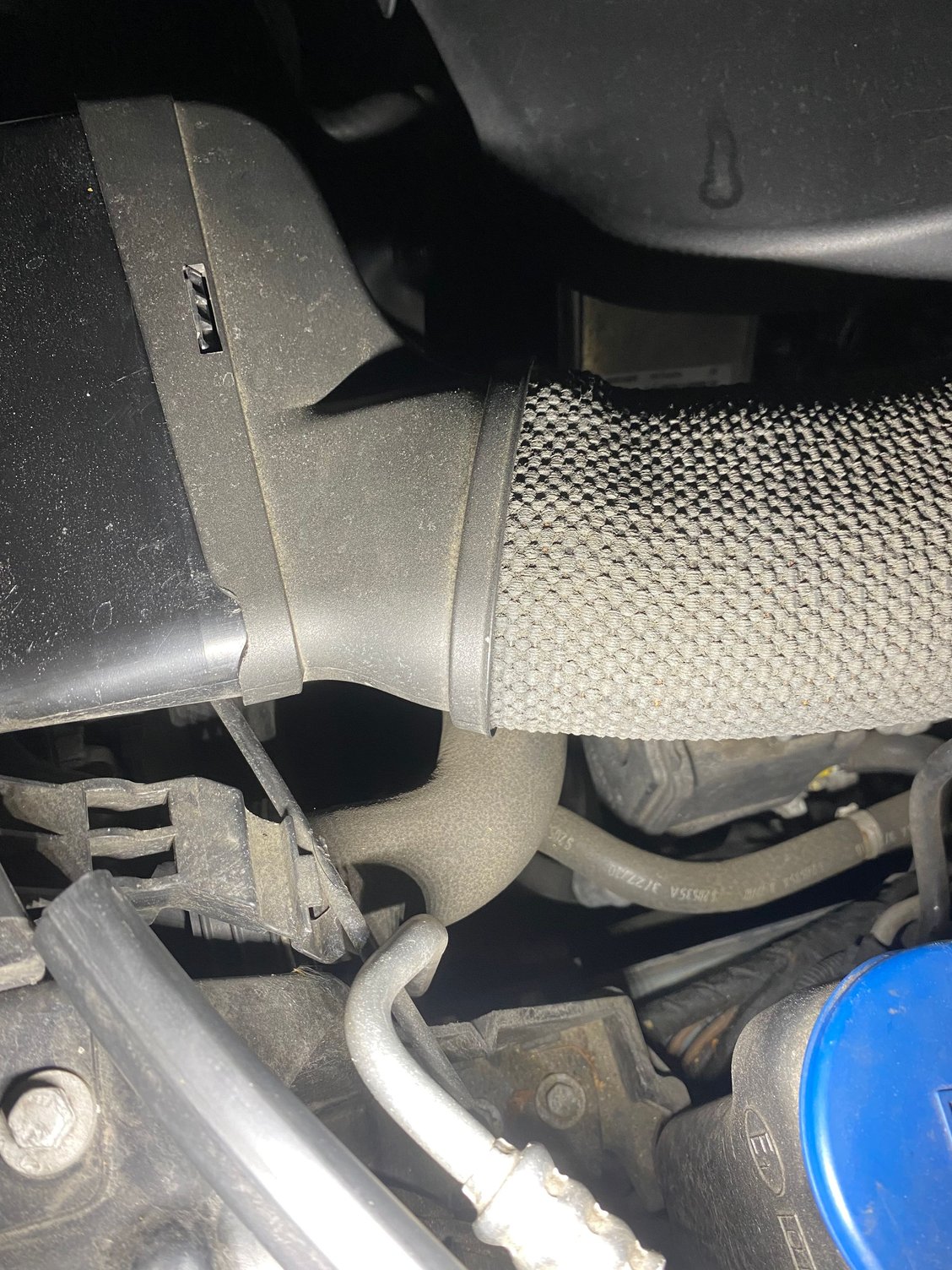

Out of curiosity, I went out to my vehicle and checked the hoses you're concerned about.
This hose isn't showing the depression that is visible in your hose.
This hose looks similar.

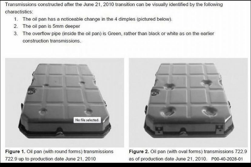

These vehicles thrive if you follow MB maintenance specs regarding fluids. I would service the trans fluid if you can't ascertain last trans service. MB changed trans fluids type sometime in 2010 to blue type prior fluid was red. Red trans fluid requires 40k intervals and blue requires 70k intervals( I personally change at 50k intervals). Run the vin thru local MB dealer parts counter to determine fluid type. Attached a photo showing how to determine by checking the design of the trans pan but to be safe still verify with vin...
Figure 1 pan would require red fluid
Figure 2 pan would require blue fluid

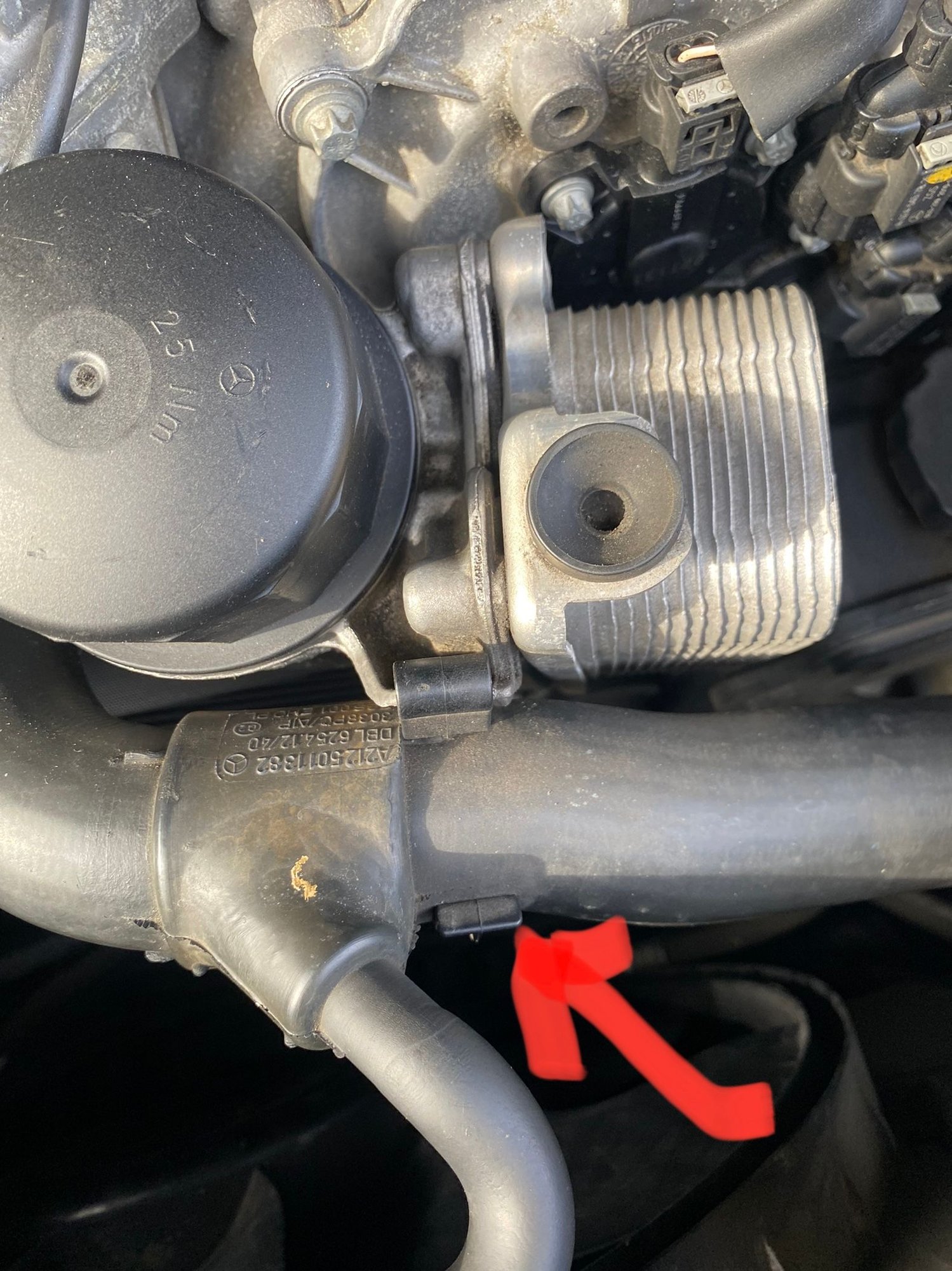

Going back to the coolant hoses. I notice mine is pretty much touching the oil cooler. Do you have a plate between or is the hose stiff enough that it doesn’t flex onto the cooler?

There is a bracket attached to the coolant hose and oil cooler/oil filter housing preventing the hose from touching the oil cooler.

Thanks a bunch, Raj. I am missing that bracket. I will try to source it.

The hoses definitely shouldn't look collapsed like that. I agree that they should be replaced just based on the age regardless, but it being collapsed is a different issue. Do they go back to their normal shape when you remove the radiator (reservoir) cap? If so, get a new cap. It's supposed to let the cooling system breathe to some extent and may not be working properly.
Does the temperature stay at a good level while driving? It should hover around 90* C

Is there a trans cooler? That might answer the collapsed hose and slipping transmission.
