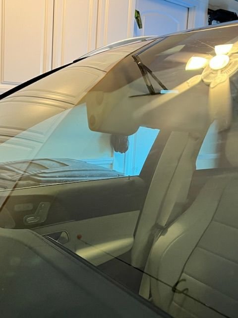

Here is what the fitcamx looks like on the GLS. Sorry I couldn’t get a vary clear shot through the windshield via the glare.
we actually needed it this week. Construction truck who didn't clean off his trailer prior to going in the highway, throwing loose rocks off of it, got our windshield. Camera caught it all, including the logo and phone number on the truck. Needless to say that redneck denied everything and hung up when i sent the video to the company’s website email address. Told him my insurance company will get it too, along with the state DOT and anyone else. Clearly showed the debris covered trailer and small backhoe he was carrying on it. By law they’re supposed to clean the trailer of that stuff prior to hitting the road…
