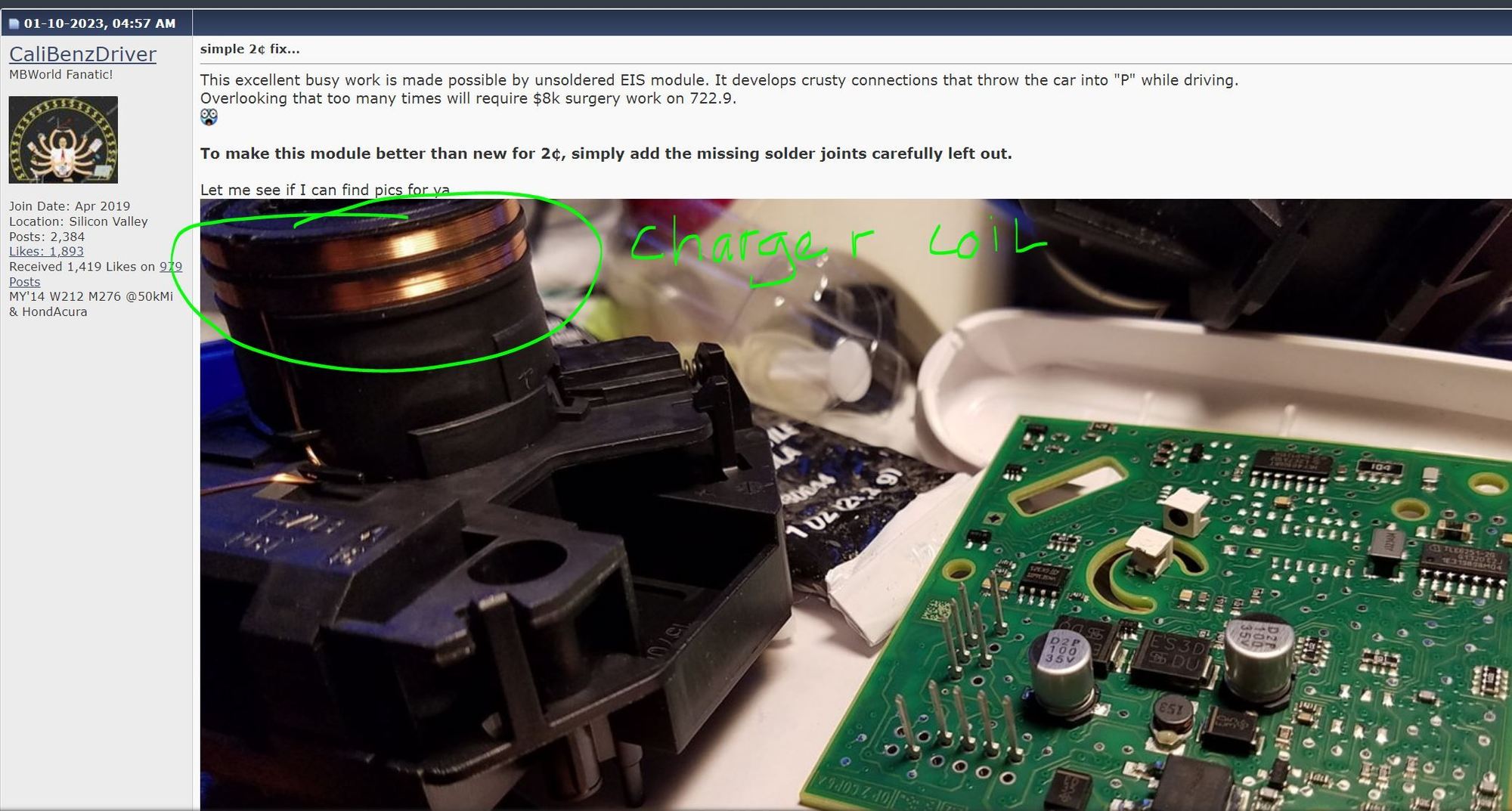

Something interesting I found out while reading N73 for Juan PARK issue.
So the key when inserted uses no battery because it is wireless-ly being supplied power via induction coil.... aha. I initially thought simple RDF chip like key card entry to office/home.
Simple working of RDF https://en.wikipedia.org/wiki/Radio-...identification
No wonder the N73 has coils which I thought is the antenna .... LOL
So, NOT using push button I think is actually safer from car theft with 433Mhz radio sniffer, which the key FOB is using in wireless mode aka PUSH BUTTON.
My key FOB stated 433.92 Mhz frequency.
This frequency is a *****, so many devices uses this frequency. https://en.wikipedia.org/wiki/LPD433...PT%20countries.
I think if one is in area with very strong radio interferences and using push button aka wireless-ly, there could be times glitch may happen and resulted in a fraction of a second loss of drive authorization.
I wonder if tranny can go to PARK mode on its own ( when at low speed below 8 KM/H ) if LOST-COM occurred to key fob ?

My Lord, this amazing KeylessGo module can really deliver wholesale chaos:
  • Sleepless SAM, main battery drain
  • Delayed unlock response
  • Lotery ninja-kick trunk opening
  • Moody ignition key & 3V coin cell
  • Alarm active after unlocks
Do you wonder why...
the KeylessG controller
KGo is one of the module that makes frequent "battery reboots" an extremely good habit.
This module receivers are always partially powered to eventually ask F-SAM to wake up EIS for key authentication.

On a separate note, but directly related to replacing these coin batteries and I am certain many of you use laptops.
It is a very common failure for laptops to get into a non-booting state, and misdiagnosed as damaged, boot loop error, corrupted BIOS, piece of junk brand, etc. The symptom is: Fan spins for a moment after pressing the power button, and it shuts down regardless of battery charge.
That state is because the BIOS got corrupted due to a low voltage (auxiliary/buffer/standby) coin battery, I have seen laptops disposed of, or sold for 10's $ and they only needed a new coin battery. You should proactively change your coin battery before the device relying on them gets confused
My 2c.
