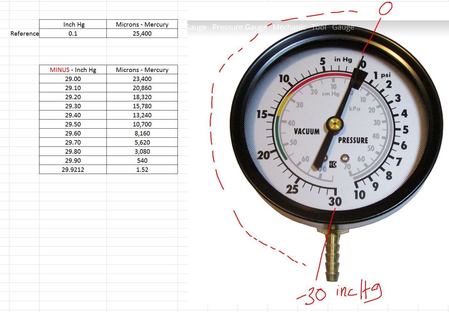

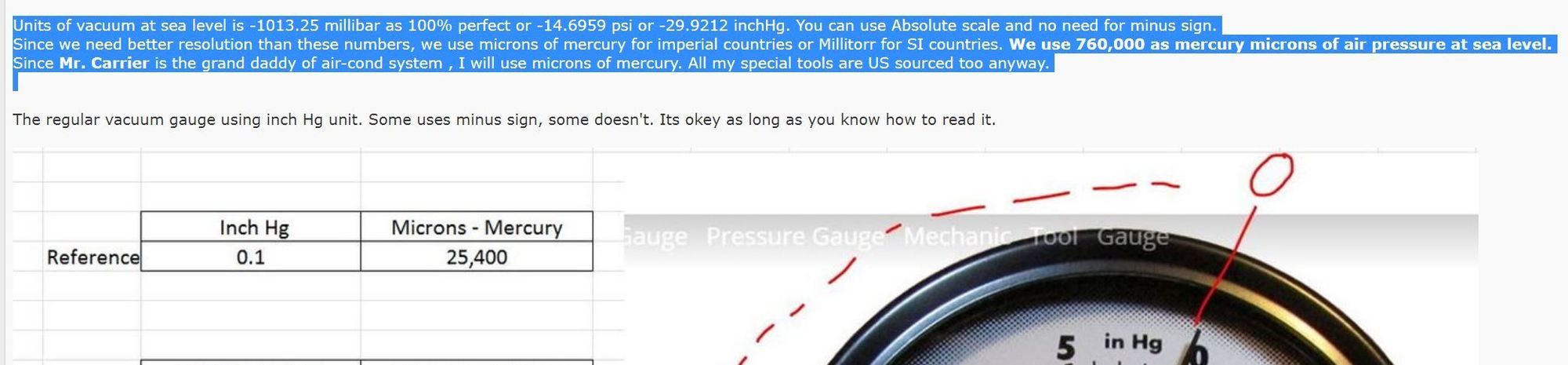

Units of vacuum at sea level is -1013.25 millibar as 100% perfect or -14.6959 psi or -29.9212 inchHg. You can use Absolute scale and no need for minus sign.
Since we need better resolution than these numbers, we use microns of mercury for imperial countries or Millitorr for SI countries. We use 760,000 as mercury microns of air pressure at sea level.
Since Mr. Carrier is the grand daddy of air-cond system , I will use microns of mercury. All my special tools are US sourced too anyway.

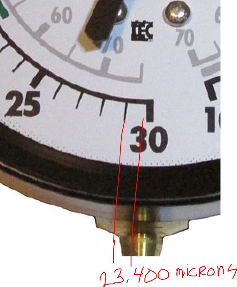

The regular vacuum gauge using inch Hg unit. Some uses minus sign, some doesn't. Its okey as long as you know how to read it.

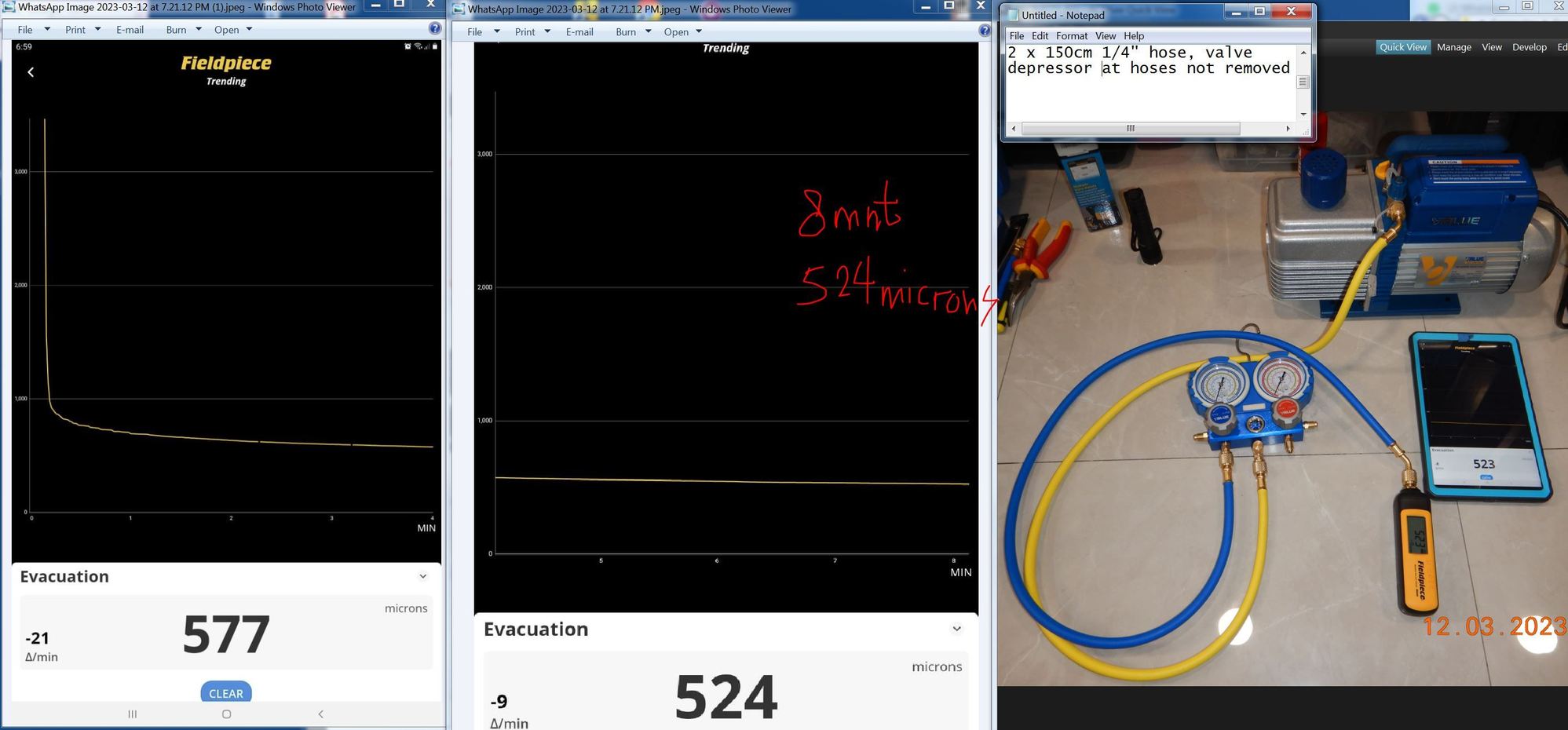

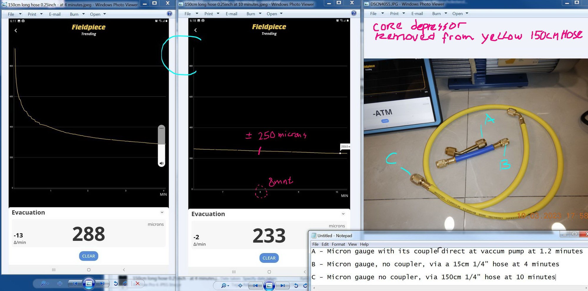

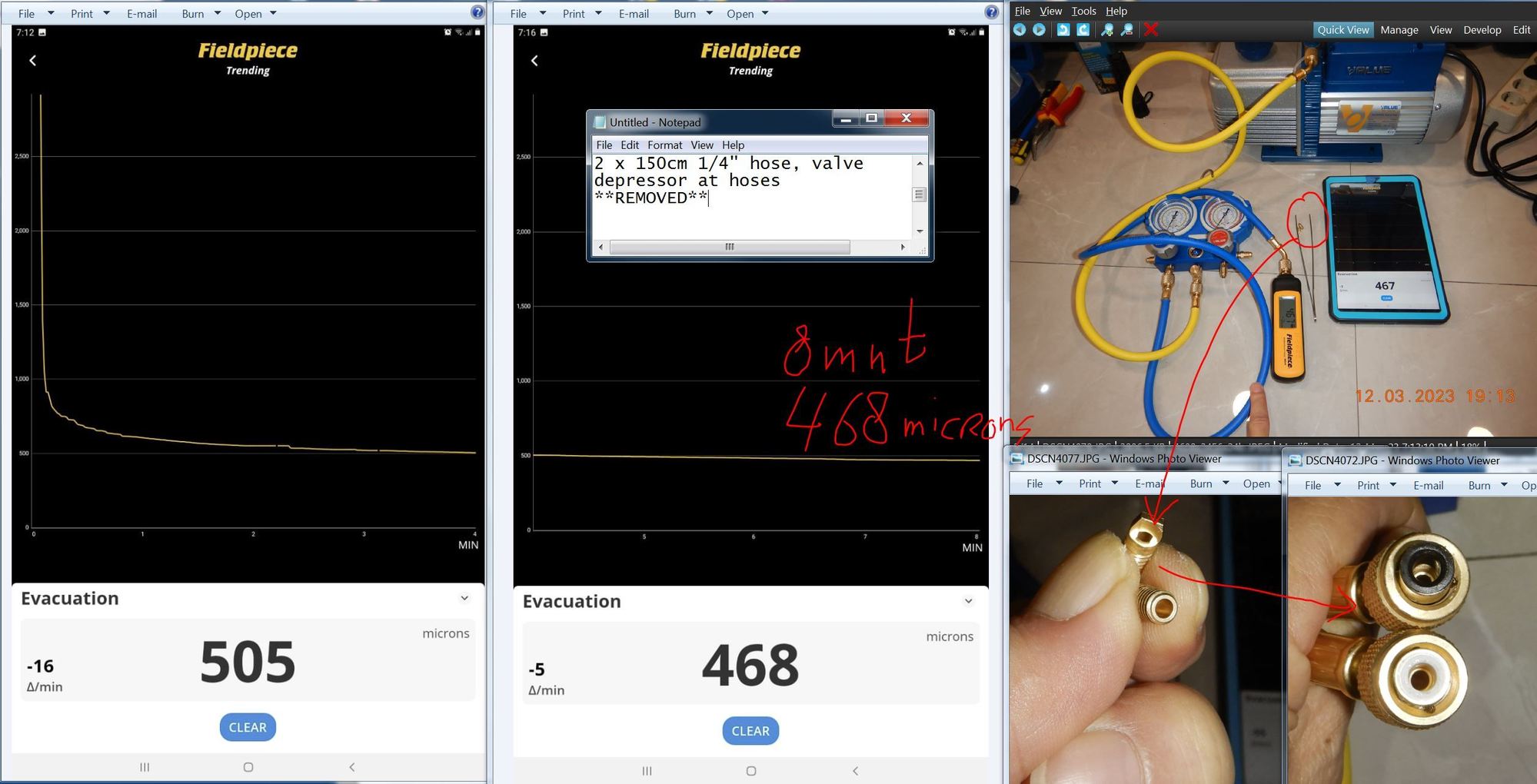

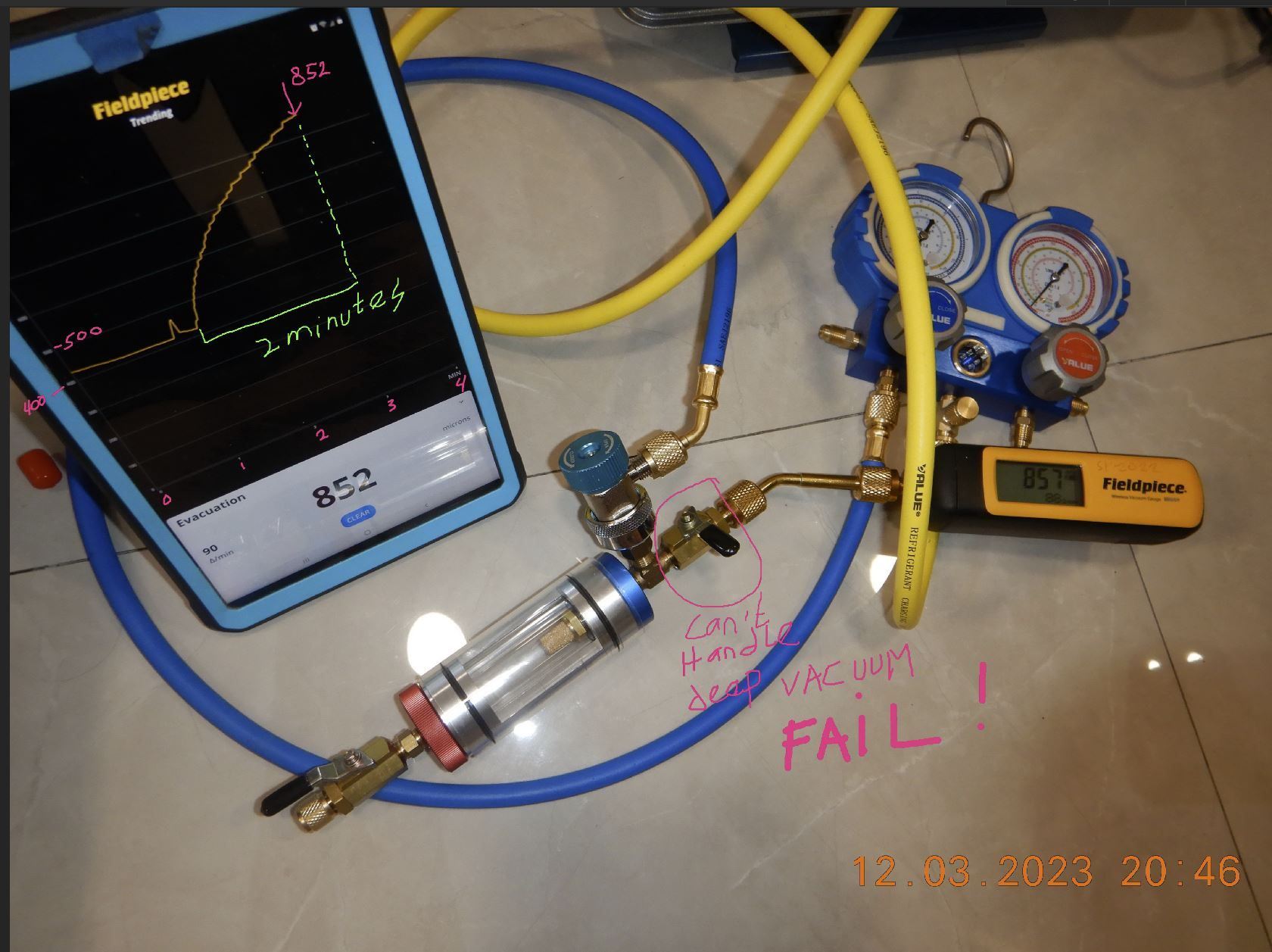

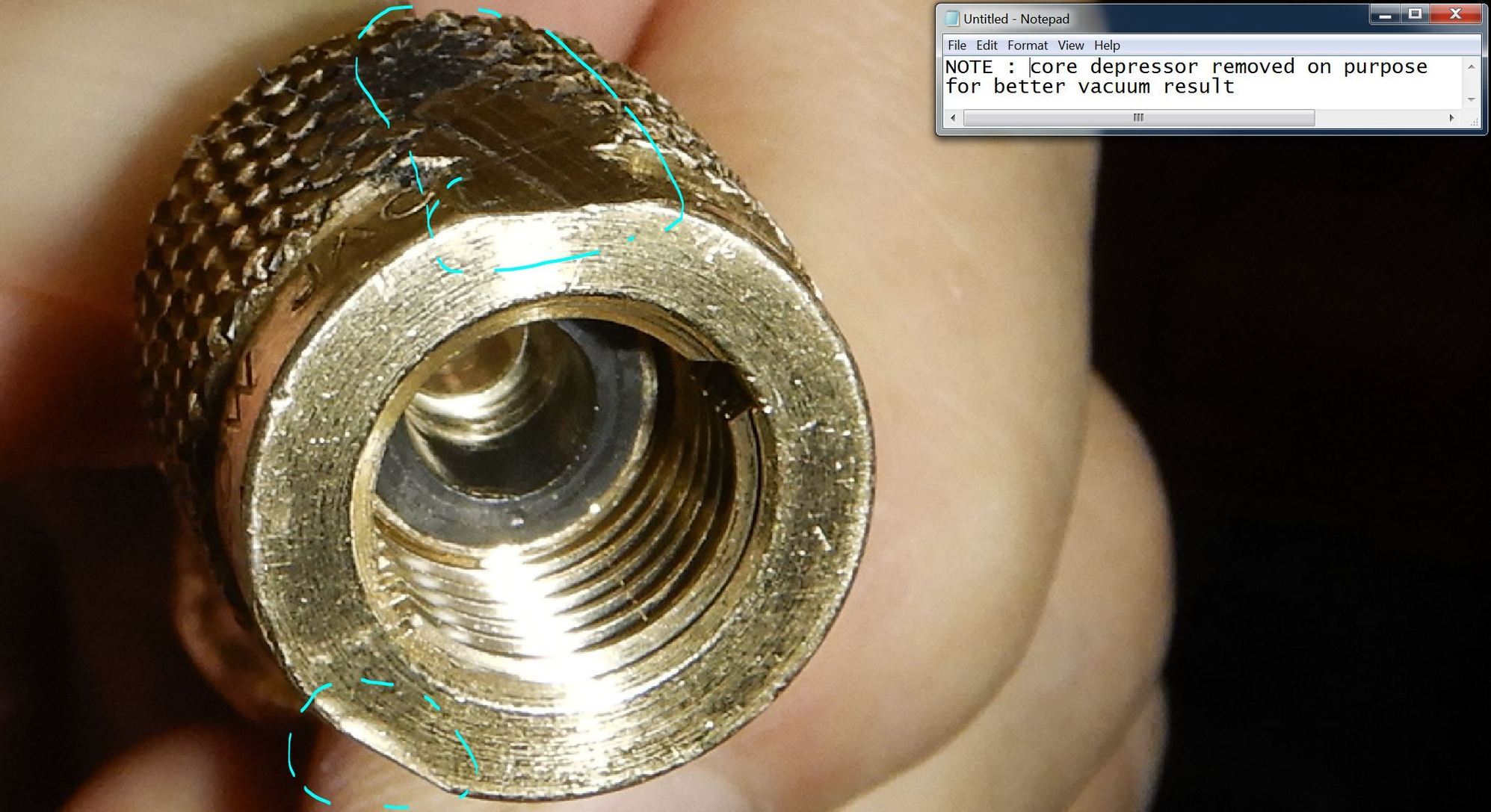

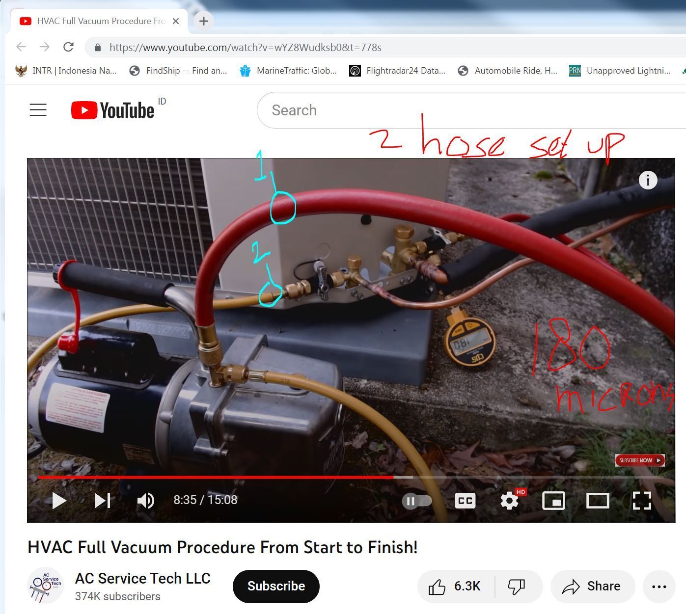

Now, the target deep vacuum is 500 microns or better at the HVAC system port itself.
How the hell can we see that value using an analog gauge ?

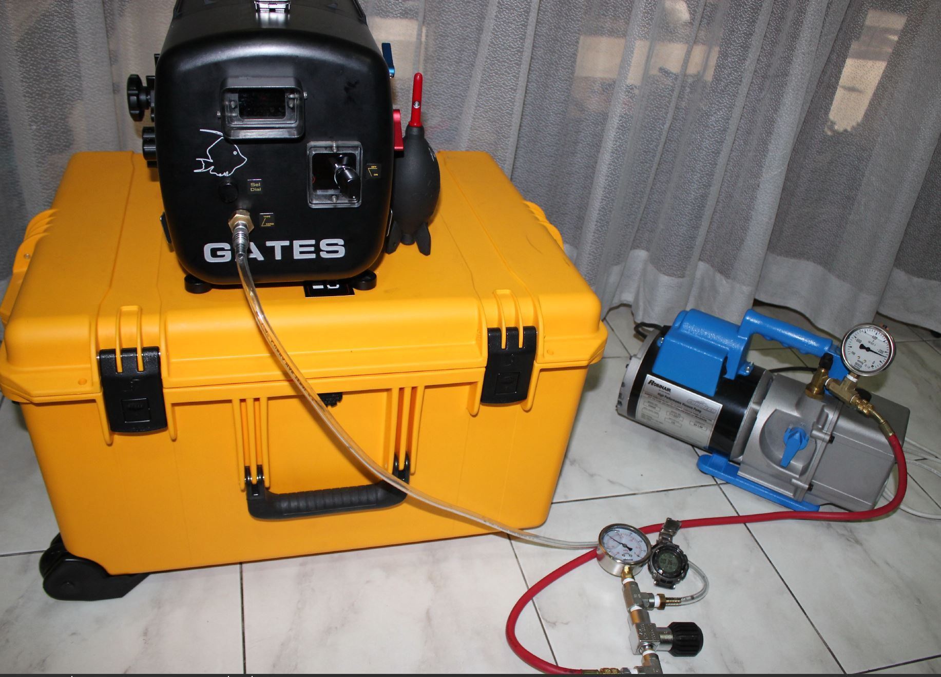

I use my RobinAir 3/4HP vacuum pump for vacuuming down underwater camera housing to test for leak by way of seeing if there is a vacuum decay over X minutes. That was why I bought it many many years ago.
All I need is -25 inch Hg and that is enough.
Later I used this vacuum pump for radiator air pocket removal and I accidentally sucked coolant into it ... LOL.
The intermediate liquid catch/trap bottle was too small and this pump is so fast.
I overhauled the vacuum pump all rubber seals and assume all was good. Sure in analog gauge visual all looks good.

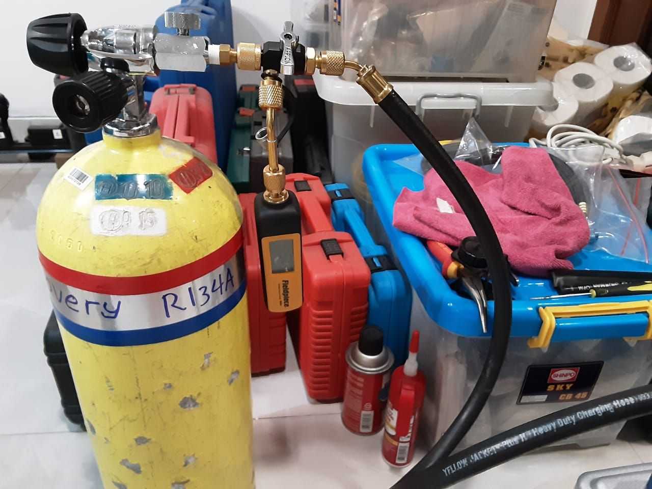

So one day I bought a micron gauge from Amazon.
Amazon Amazon
I want to learn of HVAC and I must have this micron gauge.

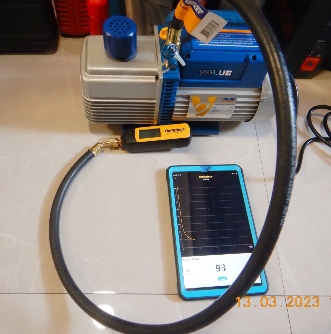

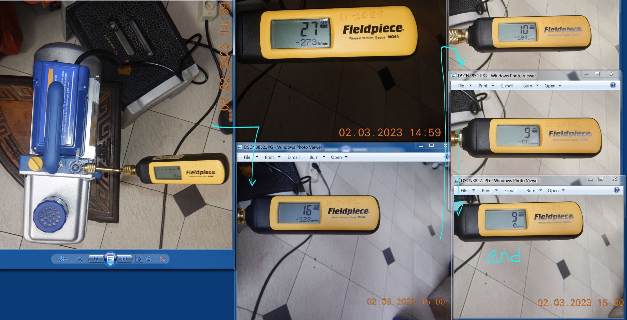

Hold and behold , my Robinair accidental ingesting of coolant has scored a tiny tiny bit of its dual stage vacuum pump head and best I can achieve is no better than 1,000 microns and not stable too.
I would say 2,000 microns as stable. USELESS FOR HVAC WORK !!!!

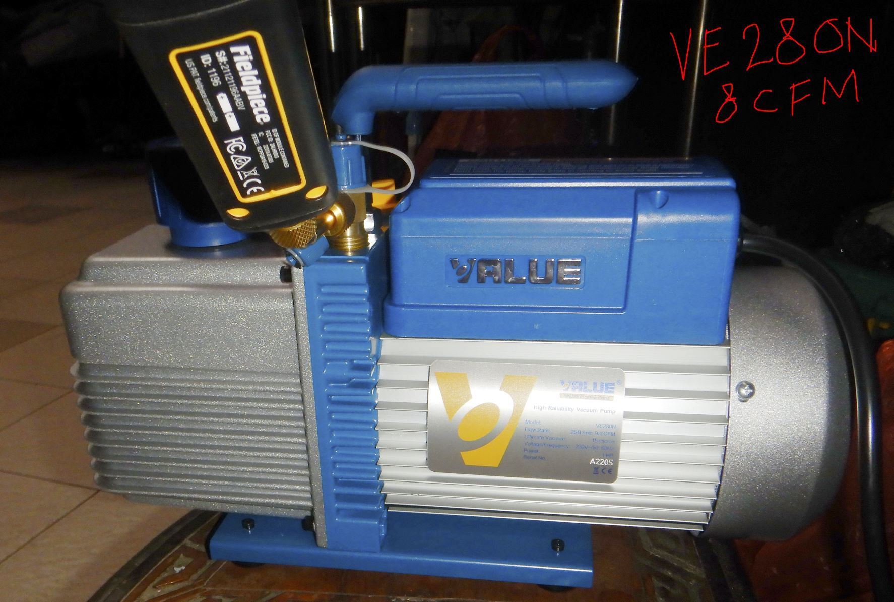

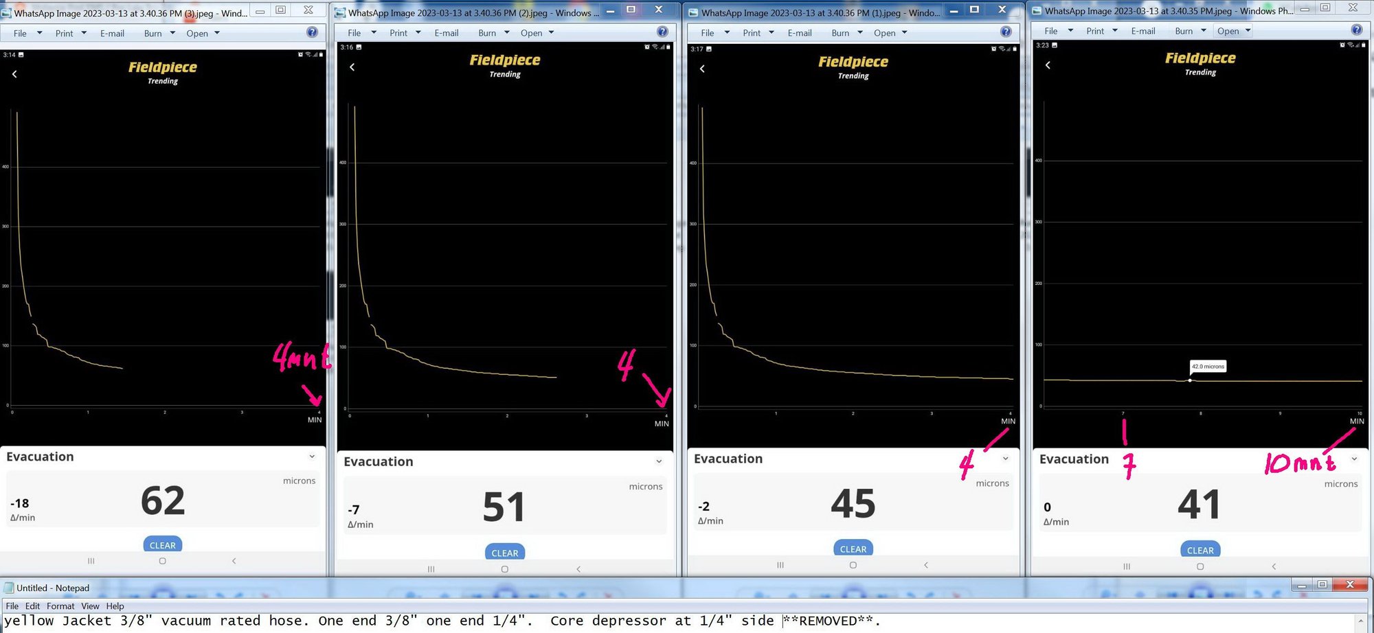

So I must buy a new vacuum pump ..DUGGGGGHHHH
And I did got it yesterday.

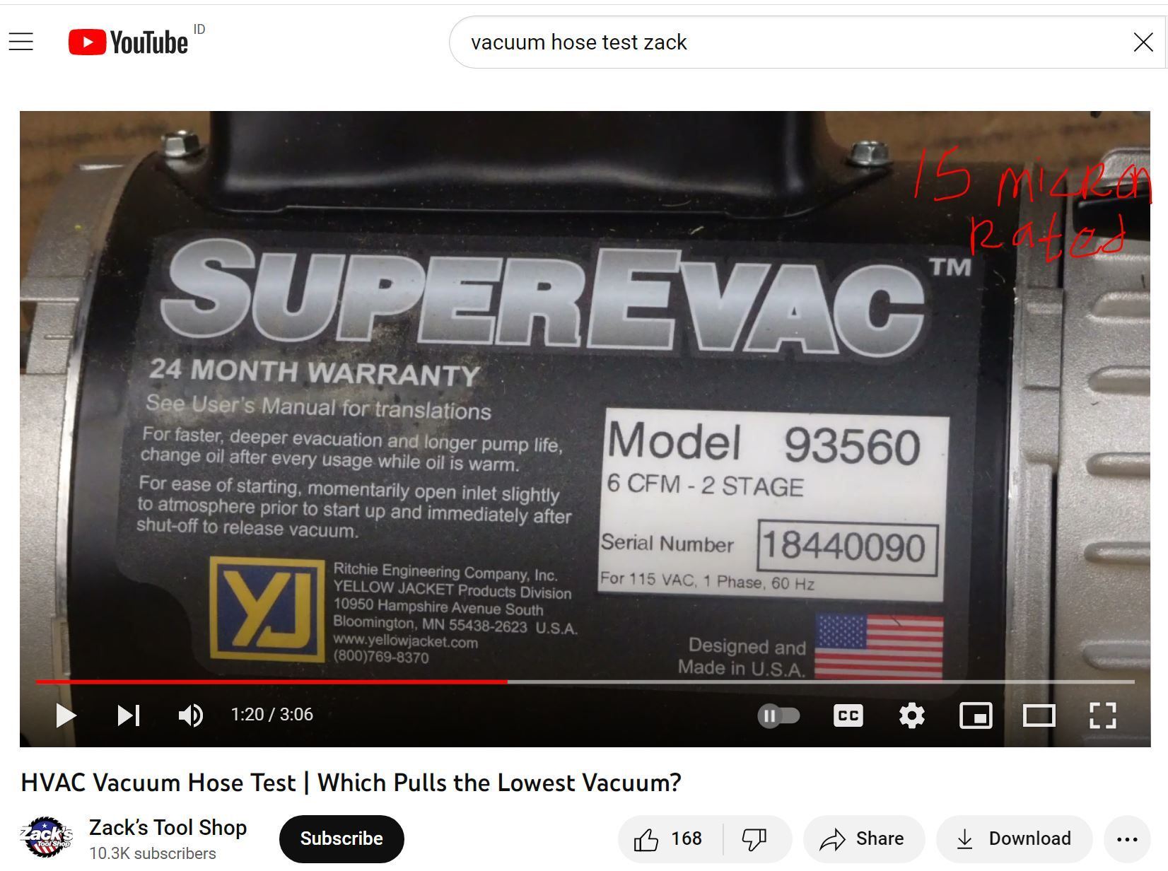

Holy cow, 9 microns at the pump head..YIPEE !!!!
This is a better china made unit, not garbage unit. Advertised as 15 microns at pump head and say 5 micron gauge accuracy, this freaking 15 microns pump is so smooth and powerful and affordable.
US$194 only locally and will be locally US$450 - US$550 if RobinAir 8CFM which is also China made for today's range.
Amazing. See their products here : https://www.worldvalue.cn/

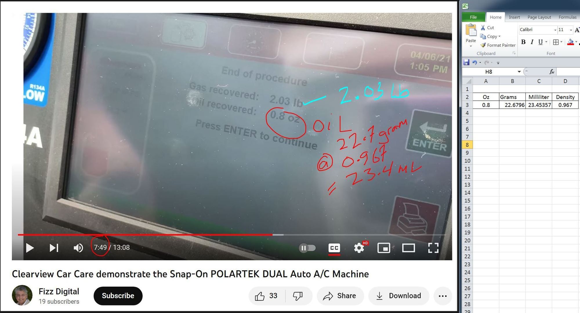

03. ALL COUNTRIES : All refrigerant removed may/will contain compressor oil and whatever quantity being removed, must be returned to your car HVAC system. DAMN !! How do we do that hardware wise ?
Most W212 models are filled with 120ml/cc of compressor PAG oil by MB.

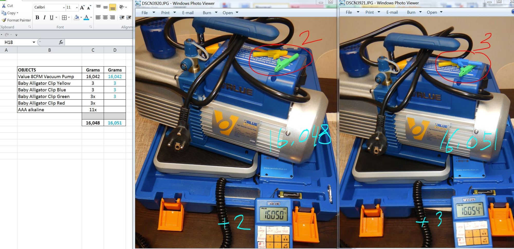

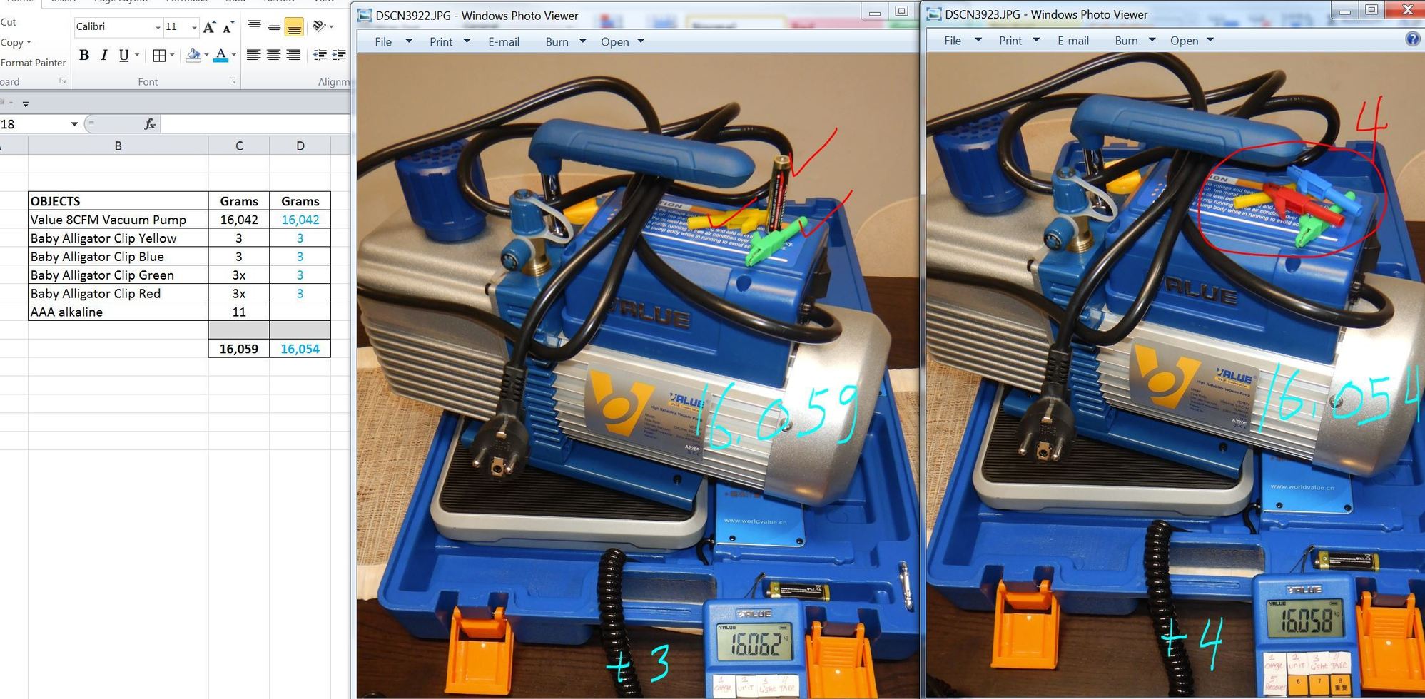

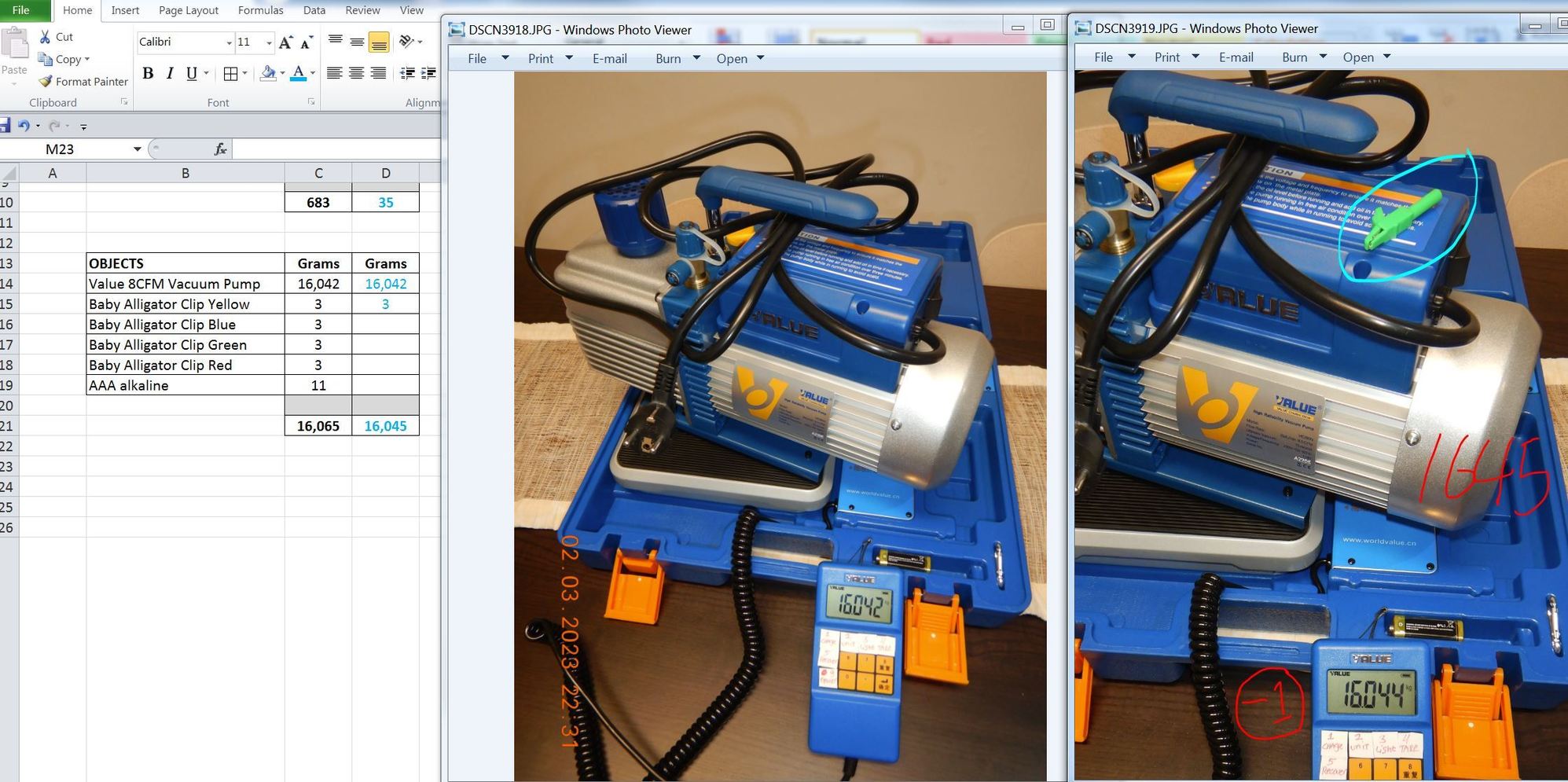

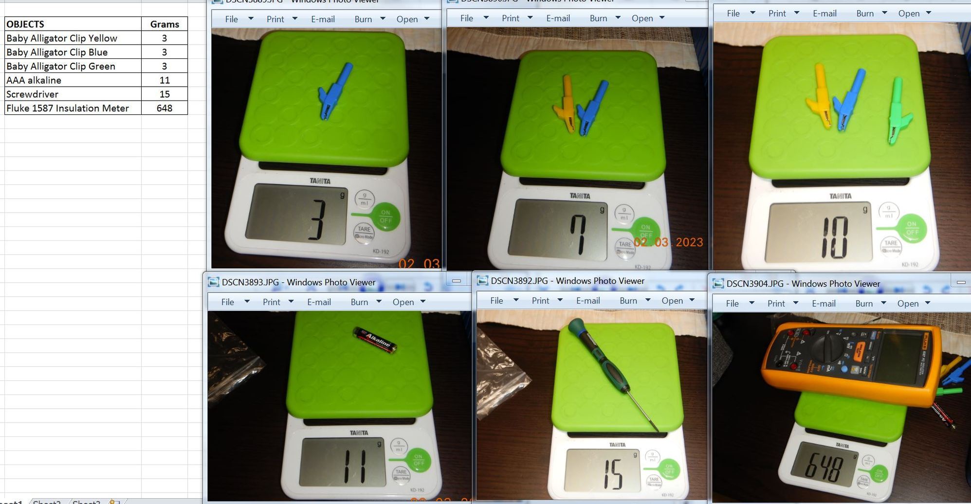

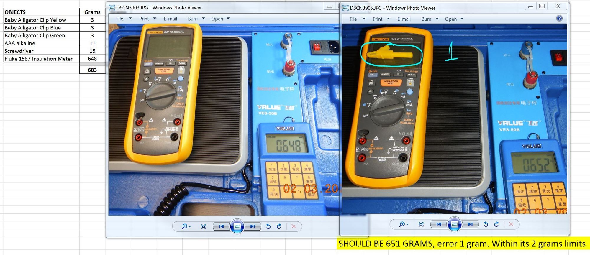

And we need a very accurate refrigerant scale. For me US$221
This is a 50KG unit. Older model from VALUE China. But this has a solenoid to trigger shut down when certain quantity reached.

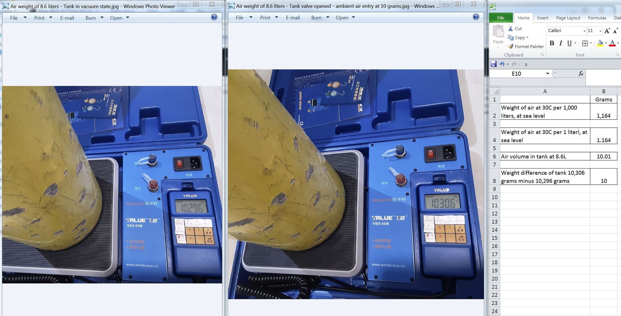

I tested ts accuracy last nite and I am so impressed at the progress cheap semiconductor has brought us for the weight sensor.

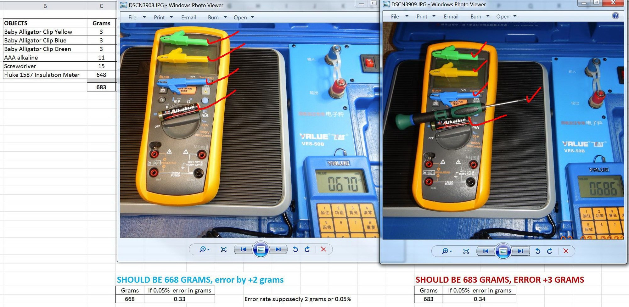

VALUE VES-50B Refrigerant Scale............ I am beginning to have more trust with this VALUE brand as of today.
Supposedly 0.05% accuracy or 2 grams. To US boys, 1 ounce is 28.35 grams.

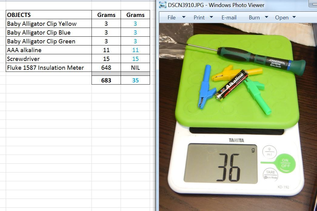

First I verify weight of the test objects using Tanita 2,000 grams scale. This is also a 2 grams accuracy and Tanita is Japanese brand.
I get 1 gram overall accuracy.
So now, let's test the China made unit.
Above test is for object under 1KG. Impressive for a 50,000 grams scale to be this accurate at 700 grams worth of objects. Target is 5 grams maximum deviation.
Lets use a heavier object which will be close to a new 30lbs bottle of r134A.
Holy cow, 5 grams accuracy target can be achieved !!!!!

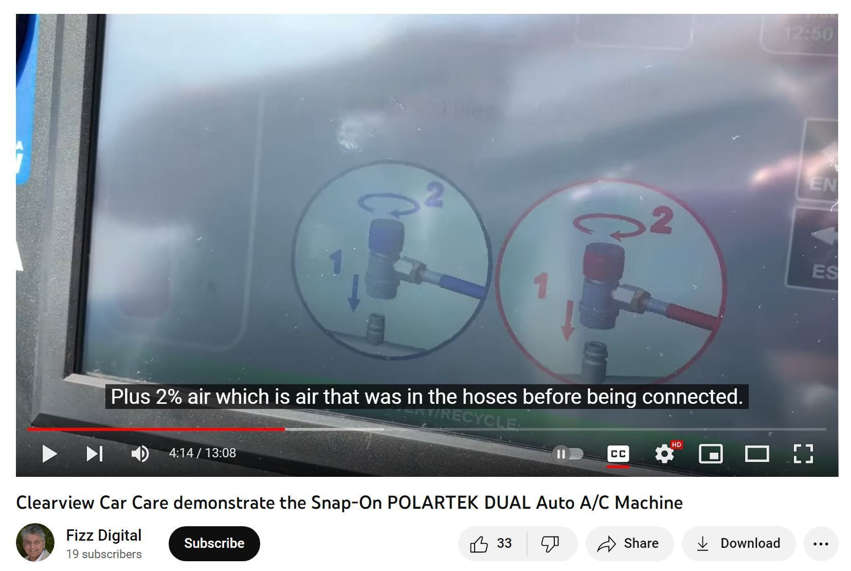

Here is an example if we as a car owner ( Mercedes too ) does not understand and not wanting to learn, we can get whacked by a car care workshop using the best US$22K Snap On dual gas 3R HVAC machine 334B.......... because the hvac operator is not properly trained and the vacuum pump of the 3R machine is not well maintained too.
I guess as Tom Lech put it, spend money to train your staff at proper HVAC training seminar/school is so true and a must. US$22K machine is useless if operator is un-trained.
https://www.youtube.com/@coldfinger459sub0/about
Here is the case study I want to share :
Click the youtube link on the above image and you will go direct to utube.
Lazy to read HVAC techy the provided fill charge label and probably grams in an alien word to him
So this is a W166 without rear EVAP

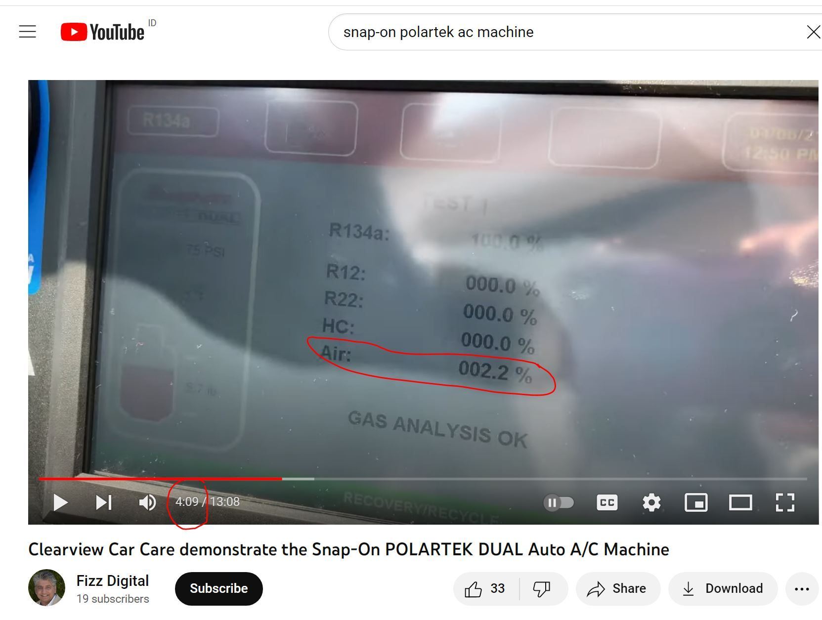

2.03 lbs recovered/pump out
2.08 lbs recharge/put back because techy recalled 2.08 was the recovered.

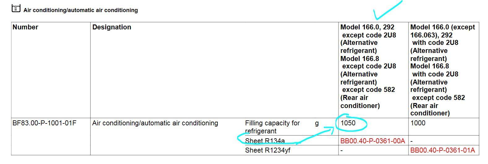

2.03 or 2.08 are WRONG !!!!! Fully evacuated/recovered system W166 is to be put back at 1,050 grams or 2.314 lbs !!!!
This W166 assuming MB USA done the refrigerant charging well and this W166 first ever refrigerant recovery is on this video, this W166 has lost 12.29% since brand new.
Well natural leak rate of any dynamic seal is real.
Techy does not understand that 2.2% air is already BAD.

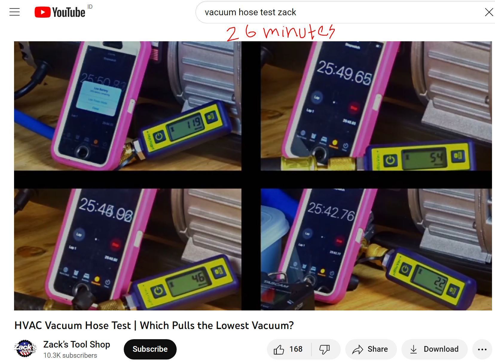

Probably bad practice not evacuating the hose using the vacuum pump properly before use.
Dont get confused by 100% r134A and then 2.2 air is equal to 102.2% which does not make sense being over 100%
The 100% r134A is the purity of the gas. 2.2% is the overall air content within this W166 HVAC system.
When you go for EPA HVAC training, they teach you all this.
See techy is honest but does not realize he should be doing proper evacuation of the hose to avoid air* as contamination ( *non-condensable gas )

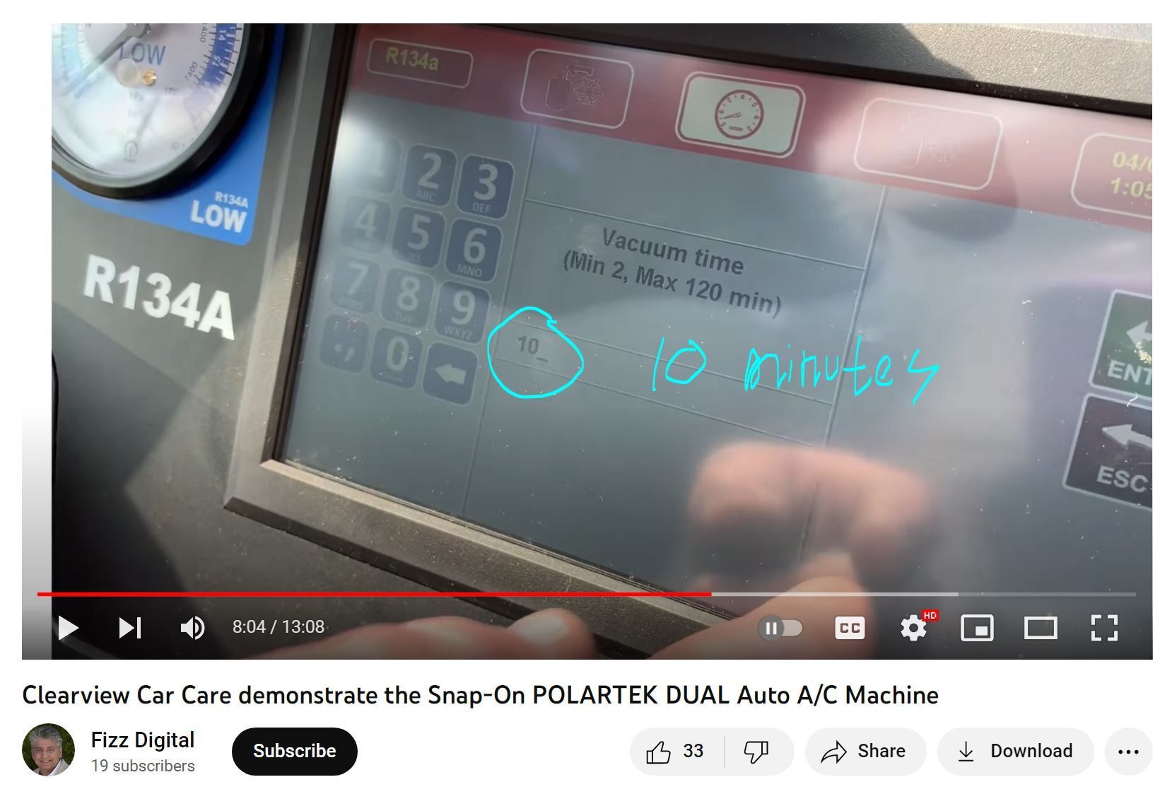

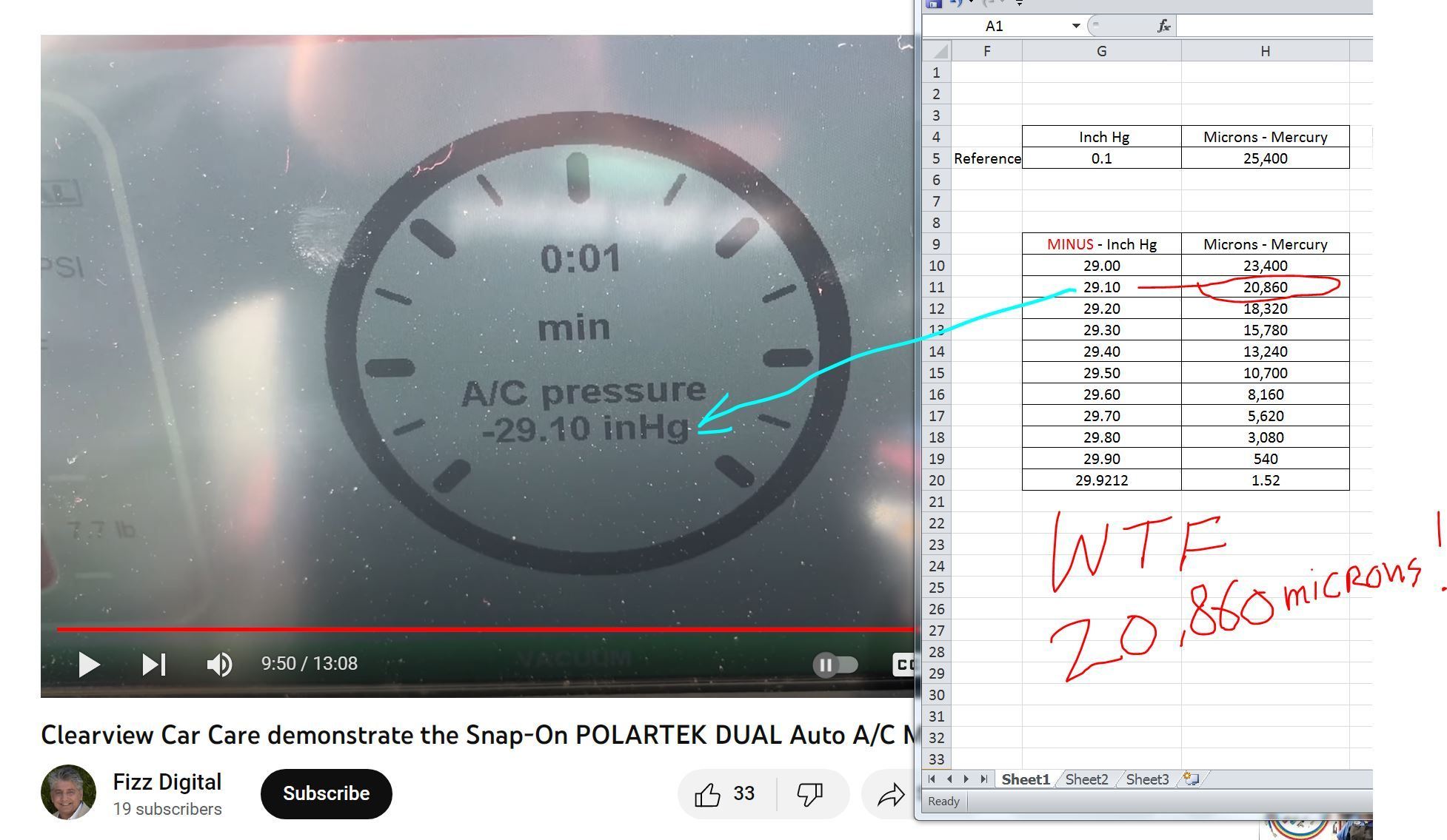

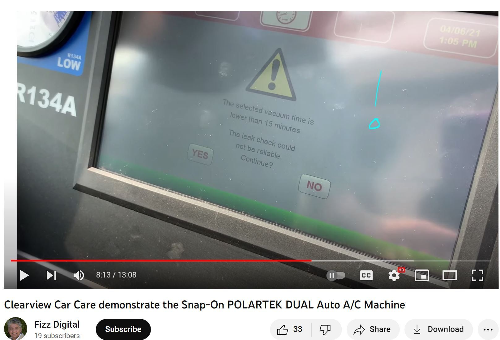

Lazy azz, typical vacuum setting of 20 minutes is being bypassed to be 10 minutes.
20,860 microns after 10 minutes is most likely a poorly maintained vacuum pump inside the Snap ON 334B.
15 hours is the oil change as per Snap On user manual. I cant find this top end dual gas user manual yet, I got the Snap On single gas user manual.

In my world MICRONS is a distance measurement
per my engineering books 1000 Microns = 1mm
How are you converting to pressure?
Pressure = Force / Area???
Reply 0
Mar 5, 2023 | 03:34 AM
Well micron is not only for Length.
https://www.sensorsone.com/micron-hg...pressure-unit/
Think of a person using a ruler with 1mm precision and then need a micro-meter or a dial-gauge which can do 1/1,000 millimeter for works demanding such accuracy.
I too never knew about vacuum micron ( imperial ) instrument, because I never needed such resolution, until I find the need.
Think of oscilloscope vs a DMM. Why do we need it for ?
Why do we need 1 second of time to be seen at 100,000+ data points on a scope where the regular DMM see it only 4 data point per second ? CAN BUS data is why .

I get what you were doing now;
when you say MICRON you mean Micron of HG: like IN of HG.
You just drop the HG part -
Your shorthand is confusing is all when you leave "of HG" off the units.
Reply 0

PROGRESS UPDATE.
01. Vacuum hose size and loss of suction power from small standard 1/4" hoses, well before testing on car HVAC system.
02. Checking all my valves and hoses end seals for vacuum integrity.
Learning of the current gear I have and its limitation.
3/8" vacuum rate hose with one end being 3/8" and one end being 1/4" will arrive at least 2-3 weeks more.
Amazon Amazon
When the time come, I will do single hose deep vacuum and will not use gauge manifold set. Vacuum pump direct to LP port in the car.
Baseline Test
Extra 2.8 minutes wasted to get to 9 microns from a mere hose length so short, I think hoses ID are rough surfaces.
Current 1/4" hose extended test.
SUMMARY
AA. Single 150cm hose with core depressor removed, if evacuation/vacuuming done for 10 minutes best achieved 233 microns, and with such poor rate of 2 microns per minute evacuation because of
the hose itself is too small a diameter, $$ invested in a 8 CFM pump will use so wasted as to get 500 microns at car HVAC system will take too long.
BB, If vacuuming done using gauge manifold, 2 of 150cm hose will be involved, the result will be totally not useable.
If core depressors not removed from both hoses , below :
If core depressors removed from both hoses, below at 8 minutes duration.
514 vs 468 microns. Damn, 56 microns lost from such a simple 2 of valve core depressor dot.
At such slow rate of 5 microns per minute and will be lower as deeper vacuum achieved, it will take hours and hours to "dry" my car HVAC system with such severe efficiency loss
from these 2 small hoses.
A well used ( dry ) hose and in area with less humidity than my city, this guy can get better result but its a single hose end test too and not on a car HVAC system, yet.
Good vacuum hose is a must have, otherwise vacuum pump investment is wasted. He is using a 6CFM and mine is an 8CFM.
02. Checking all my valves and hoses end seals for vacuum integrity test.
I fear my ball valves will fail as they are not the high quality one, and indeed, all failed
Vacuum failure contribution/s : The blue color big knob valve at gauge manifold. This is low cost China made, brand is VALUE .
Low quality MasterCool 2 of ball valves from this test kit :
Amazon Amazon
+-425 microns to 852 microns in a mere 2 minutes. FAIL too !!! At least now I know how to be extra careful when using this kit to see refrigerant oil color as it needed to be vacuumed down before use.
Duugggghhhh !!! Got to invest, again !!!.... in a good vacuum rated Appion CRT ( valve core removal tool while HVAC under pressure for 1/4" SAE flare fitting ) Kit,

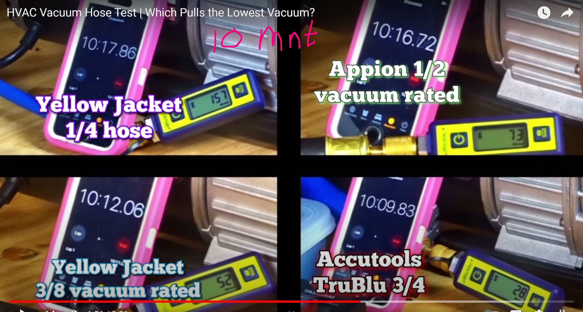

This is a 2 hose vacuuming method and these are vacuum rated hose, the red one is a 3/4". 180 microns in less than 5 minutes and the HVAC system is bigger than my car. No gauge manifold will ever be used as it is a parasite for vacuum work.
I will smile ear to ear if I can get 250 microns with such method but on a single 3/8" vacuum rated hose, at 1 hour on my car.
Single hose TruBlu brand silicone one, a 3/4" size vacuuming method is also popular.
Below test has a very good vacuum decay result of only +20 microns or from 180 to 200 in 10 minutes... DAMN such a tight ball valve !!! Those are Appion CRT valves.
I shall re-test again and update when my 3/8" yellow Jacket vacuum hose and the vacuum rated Appion CRT valves arrive.

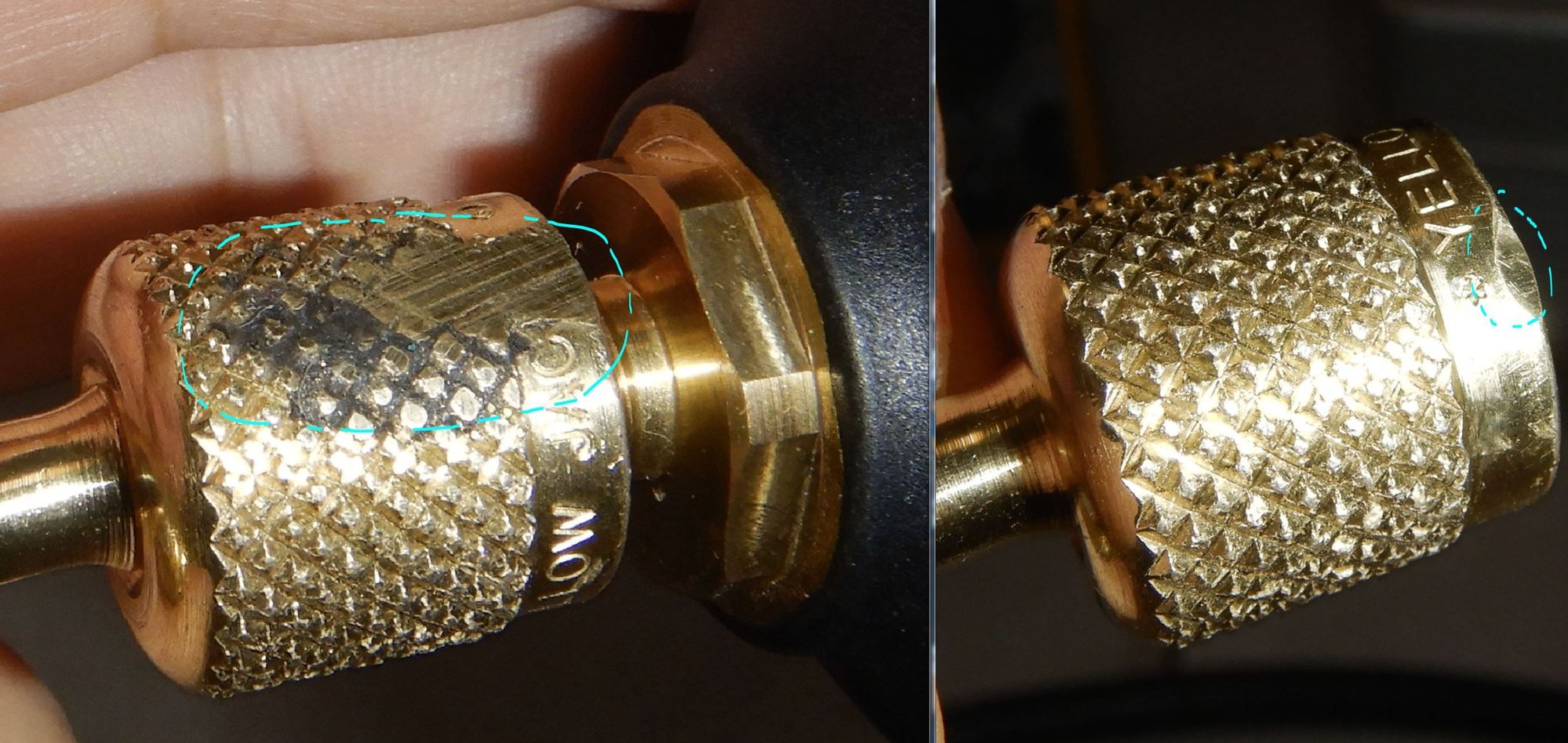

The 3/8" yellow jacket vacuum rated hose arrived a few days ago.
It works well. , down to 41 microns in 10 minutes yipe !!!!.....but factory QC is kinda bad, looks like Godzilla took a bite
Indeed, looks like Godzilla took a bite
Since I can't get the recovery tank, I decided to re-purpose my 13 years old 63CF scuba tank which I will retire in 2025, as a refrigerant recovery bottle for the sake of weight measurement of captured refrigerant.
3,000 PSI service pressure and tested to 5,000 psi, is so much stronger than typical 400psi service pressure of commonly sold refrigerant recovery bottle.
63 Cubic Feet of air at 3,000 psi is a 8.6 liters of water content or volume. Good enough.
While a W212 single evap HVAC system overall water volume equivalent would very unlikely be above 8.6 liters, the amount of restriction from its modern super fine holes

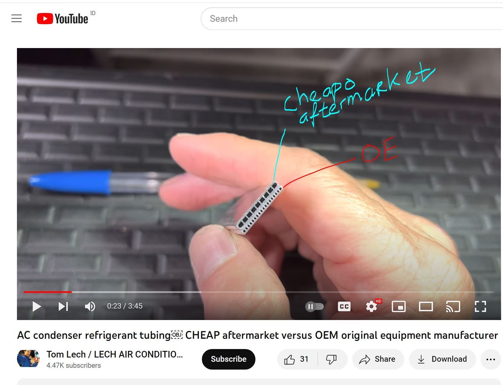

micro channel evap and condenser is a nightmare for vacuuming.
My good valves from USA have not arrived yet, but my Ali Express toys have arrived. I get to test them. Its not bad for what it cost but my target is a super-tight working hardware with least permeation , let alone leak.
220 ish micron "leak" after 1 hour. The positive news is the 1 to 2 micron per minute "leak" rate for a non branded fittings.
Here no hoses involved, so not much permeation from hose material , except at the o-ring/seals of each coupler ends.
6 hours later it was 800 ish microns and still 1 ish micron per minute rise. So 700 micron rise in 6 hours or average 117 micron per hour.
760,000 / 117 = 6,496 hours it will be back to ATM sea level, in 270.6 days.
If we are allowed to use this in opposite value, its like 1 BAR loss per 270 days.
My car r134a pressure at static and at 30C is 6.6 BAR. If I use the same leak rate for fun sake, 6.6 x 270 days = in 4.89 years I loose all my r134a
I will overhaul the scuba tank valve soon to make sure I can remove the tank as the bad variable and re-do the test again with the AliExpress valve, and when the Appion brand arrive from USA
I would have proper data to compare.

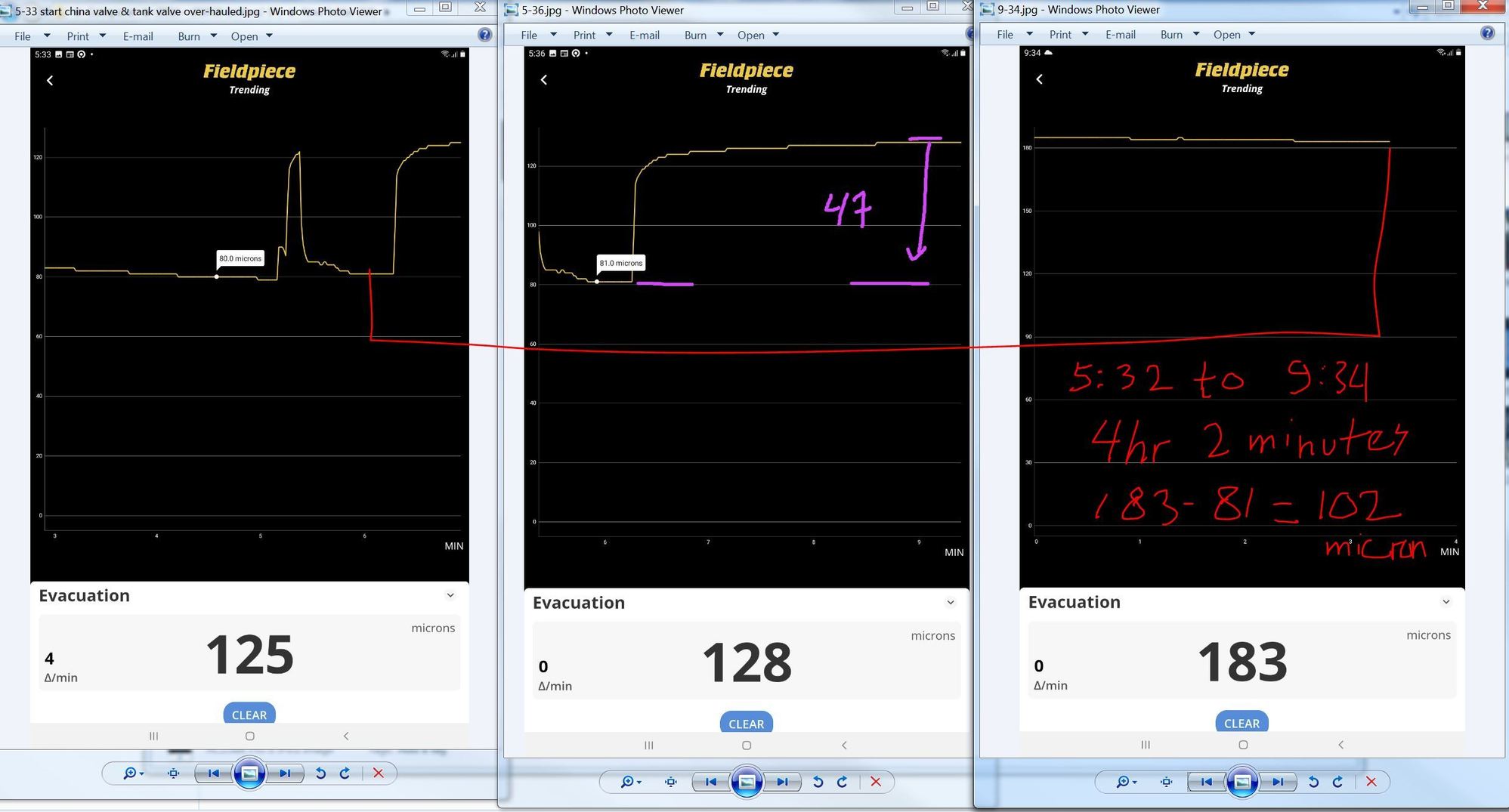

Re-purposed scuba tank valve over-hauled. I get better result.
In 4 hours, the leak rate or gassing off, only 102 microns
So the china low cost valve is not bad.
The digital scale re-tested, it is doing its job. Awesome !!, 8.6 liters or 2 gallons of air by weight it can read. it will serve me well.
When tank down to 10,296 grams under vacuum LEFT IMAGE. Allow tank to "suck" back ambient air of 8.6 liters, weight of tank shoot to 10,306 grams RIGHT IMAGE or 10 grams more.
The US made Appion valve and Nylog seal/lubricant does not disappoint.

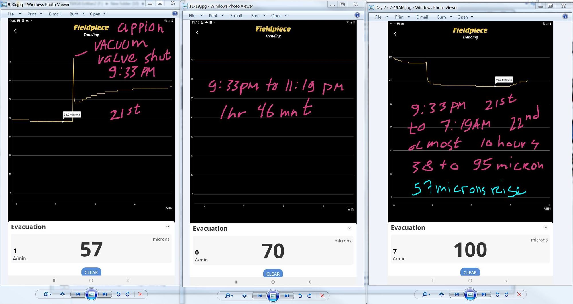

90 minutes of vacuuming to dry the newly arrived still "wet" Appion brand valve. 57 microns rise only in 10 hours for leak or gassing off, indeed worth the $$.
Labeled the scuba tank as r134a recovery tank
