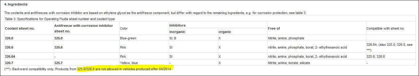

Originally Posted by pierrejoliat
Also should be listed in your owners manual
https://operatingfluids.mercedes-ben...sheet/310.1/en
It says - Backward compatibility only; Products from 325.0/326.0 are not allowed in vehicles produced after 04/2014
So I think 325.6 is a safer choice?

Originally Posted by michaelyjko
I am very confused because I don't know the build date.
Provide VIN.

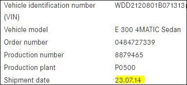

https://operatingfluids.mercedes-ben...sheet/320.1/en
325.6 Antifreeze or 326.6 Premixed
https://operatingfluids.mercedes-benz.com/sheet/325.6/en
https://operatingfluids.mercedes-benz.com/sheet/326.6/en
Old Apr 20, 2023 | 12:33 AM
michaelyjko's Avatar
Joined: Mar 2023
Posts: 12
From: Seoul
E300 M276
Vin-WDDHF8BB0EB071313
Thank you!

Look in your door jamb drivers side for build date, if before 4-2014, blue, if 5-2014, Pink. Looks like they changed it in the last 2-3 months of production of the '14 models
Thank you!
Ignore color recommendations. MB spec from the operating fluids site is definitive.

Old Apr 20, 2023 | 10:47 AM
konigstiger's Avatar
Posts: 15,901
Likes: 4,630
From: North Scottsdale, AZ
'71 Pinto
File Type: pdf
