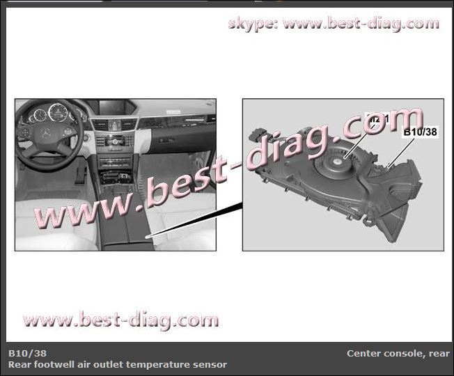

Could be temperature sensor, actuator motor, or rear operating unit best to have someone pull codes using Xentry (MB diagnostics) before replacing part(s).

This exemplify how many parts can cause the rear A/C issue you are experiencing.
You may want to listen or feel for the central console fan blowing air = good!
This is an easier problem with an easier fix than dealing with the main dashboard unit.
Let the scanner guide your reality with clues.

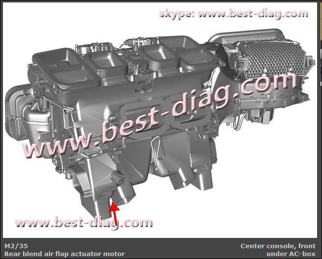

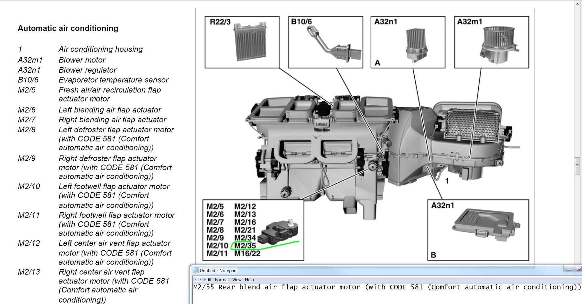

You're on the right track!
Rear fan blows good
Broken footwell sensor replaced
A/C serviced.
The blend door actuators are built with unsoldered electronics for limited reliability. Here it does look like they require additional service. There are 6 of 'em all identical...
FYI: you may have a bad actuator combined with zero fault

I have 580 , so no rear blend door. Xentry can activate this door/actuator to test.
