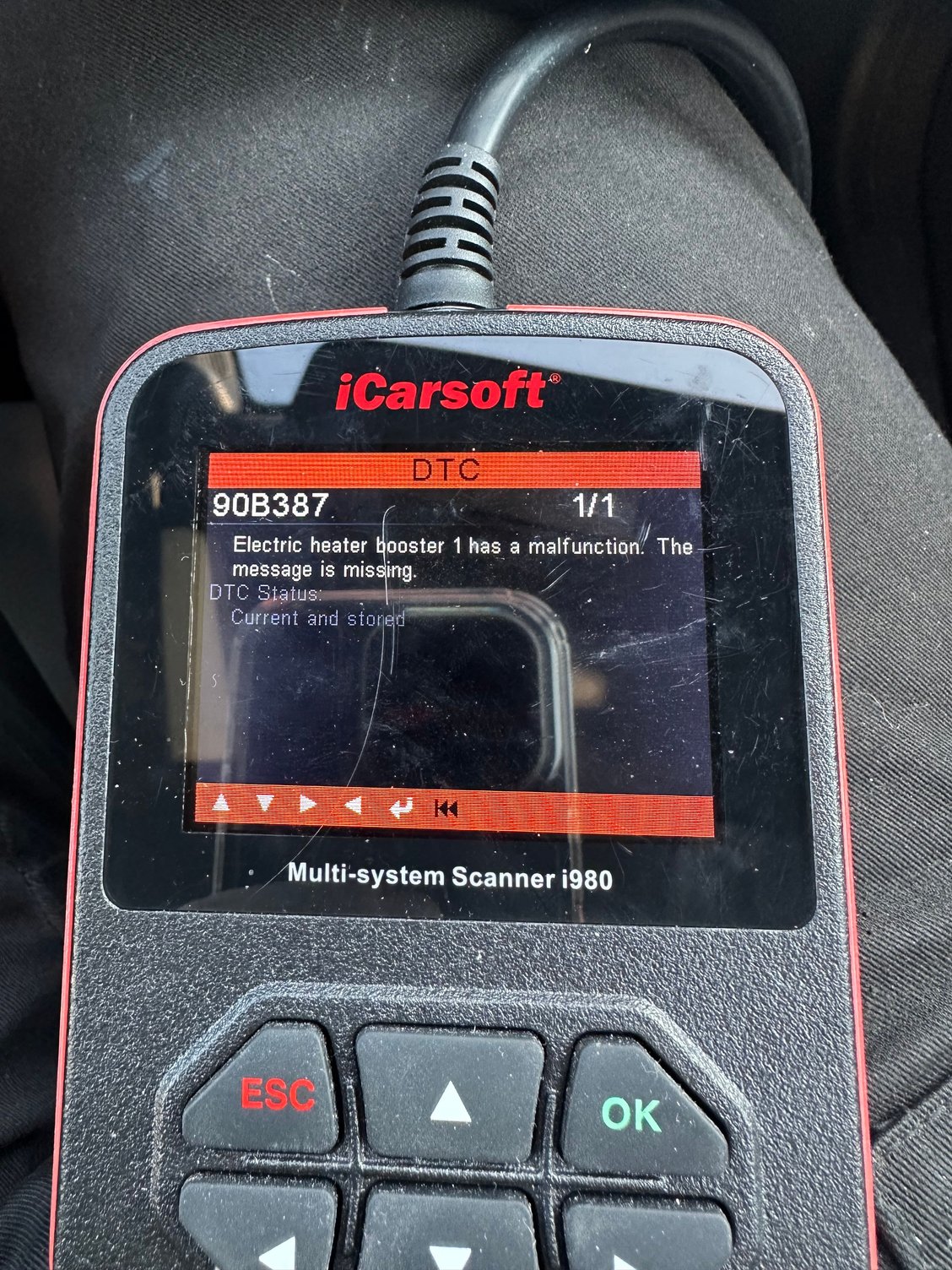

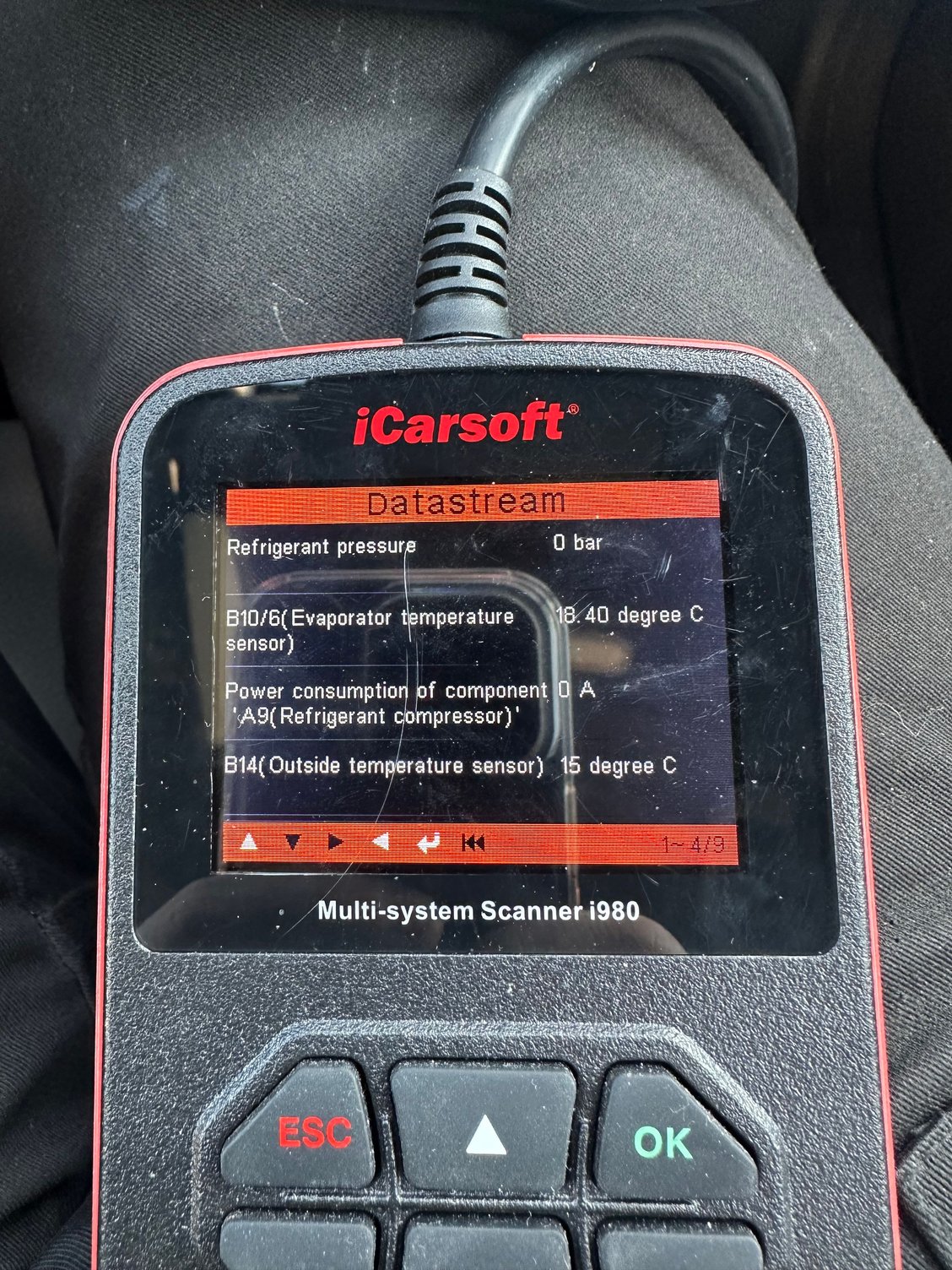

SO here’s my results from what you said, I’ll attach photos
first one is the only error code showing up
second is going into the live data

Zero BAR is your refrigerant R134A pressure sensor. Assumed this is accurate data.
So you have a leak big enough to drain your R134A all out.
Do not run the AC compressor, loss of R134A is also loss of partial compressor oil, so double bad.
MB WIS has a guideline to what amount oil refill in such scenario.
But you need to address the leak first and this is no DIY job from start to finish.

MB cooling fan has two Bosses. Big boss is the engine and the smaller Boss is the HVAC.
Since it is a single fan design, it is thus a shared design.
HVAC SIDE : Fan at maximum sonic speed is a safety measure when and if refrigerant pressure too HIGH, for too LOW I personally do not know, I seen the too HIGH issue.
HIGH can be really high R134A pressure or fake one because on sensor drift/wire broken, like here : https://mbworld.org/forums/e-class-w...mum-speed.html
The refrigerant pressure sensor is not connected to the AAC computer, but to the N10/1 Front SAM computer which is also your fuse box in engine bay.

Wonder if we can verify if the pressure sensor reading is "no refrigerant" or "bad sensor" by disconnecting the sensor, and re-scanning the vehicle and see if we get a new DTC. Something along "signal from XXX is implausible" or the like and that was not there earlier. Alternatively, there is the "spit test" (using goggles of course), i.e. take the cap from the low-pressure AC connector, "a bit of spit" and with a toothpick or small screwdriver put pressure on the Schrader valve and see if something comes out.
If the system is empty, this work is not for an inexperienced individual. If the system is still full, we can discuss the next steps here.

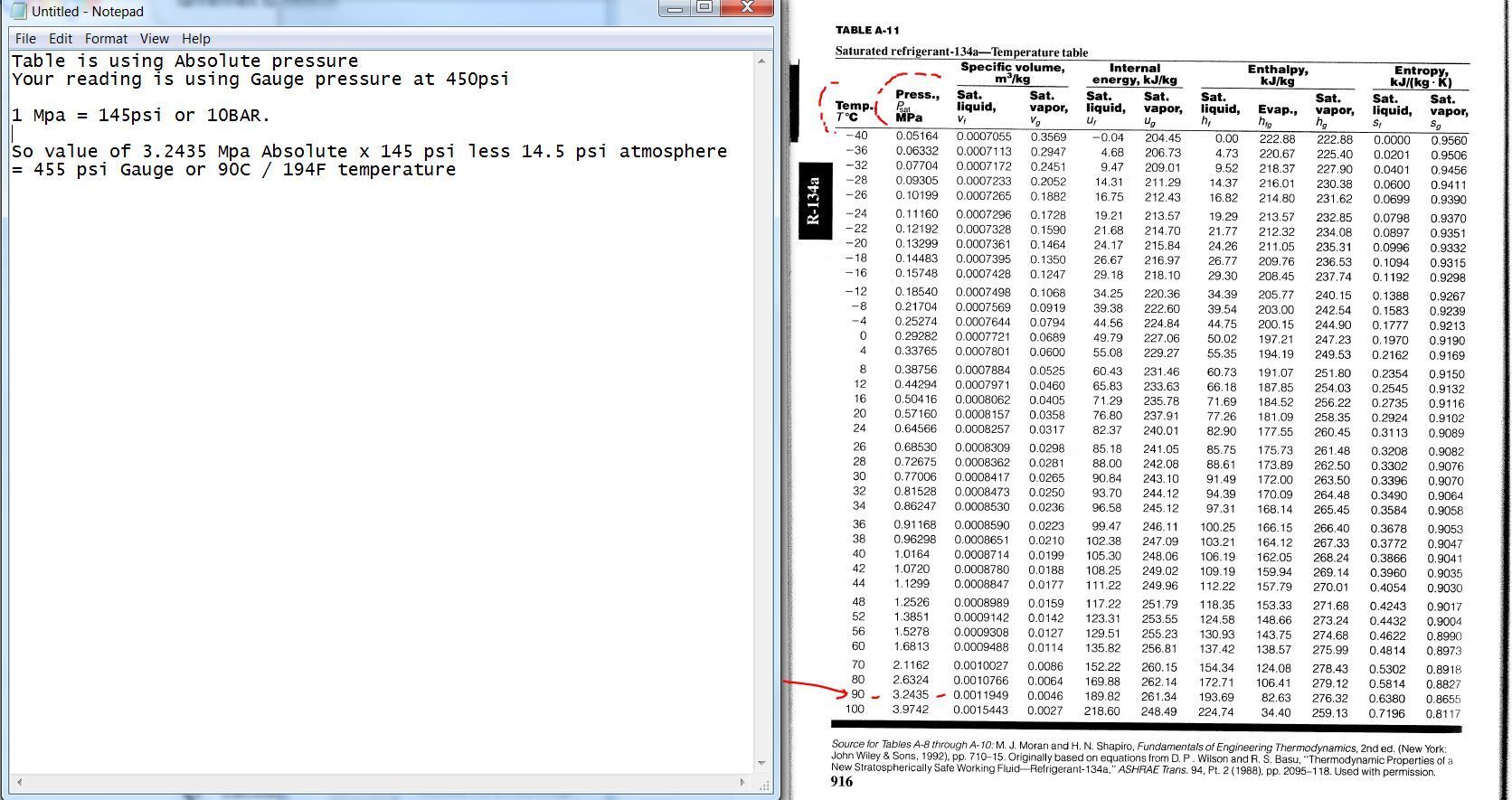

That is the problem of HVAC in countries with HVAC "friendly" weather, it never have to work hard till certain hot and humid season and baked in the sun while being parked....and there then you know its not healthy.
450 PSI high side is about nearly 90C / 194F condenser output temperature.
R134A pressure is temperature based.
I think your compressor has its life shortened by XX percent.
Even me in the tropics, cooled condenser temperature does not go beyond 60C / 140F ( 232psi gauge) in worst stuck zero speed traffic jam at 35C / 95F and humidity of 85% or more.
If radiator fan is running maximum and yet you still see 450PSI ( 90C ) on high side which is COOLED side of condenser, the compressor output surely is above 100C and
the R134A has reached its critical temperature/pressure of 101.1C or 214F. A pressure/temperature R134A no more can be condensed into liquid.
Poor thing your compressor close to 100C /212F its BAD for compressor, 100C+ is a killer for compressor.
If you do not get this fixed fast, a total loss of HVAC system will happen.
I really mean TOTAL LOSS as in 100% HVAC system need to get replaced including all hoses and TXV, Evaporator and Condenser. Only the cabin blower will be OK.
The compressor piston vs liner will be grinding itself and the metal particles will spread to everywhere.....and you can't clean them,
no way to clean them on modern micro channel condenser and evaporator.
I do not know how much will a TOTAL LOSS HVAC cost to replaced in USA, but I I would think the labor is the killer part.
Hardware wise US$2K surely is enough, HVAC parts in USA is cheap even MB genuine/sourced ones.
I said cheap compared to what I have to pay here at 250% to 300% of USA price.
Go and fix it fast please.......
