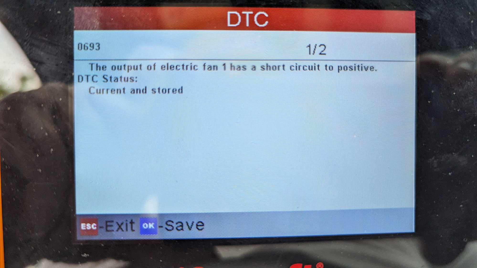

Thank you for that feedback, i scanned it last night and here are the 7 codes i'm receiving that has when i went into the radiator fan options. i'm currently looking them up to see what to look for but maybe someone here can guide me if they understand them better. Remember the car doesn't have a check engine or any kind of light normally. It seems to me that it's saying the radiator fan has shorted?
i was told by a mechanic just by talking on the phone that it's most possibly the coolant sensor and to change that first, but can a coolant sensor really do this?

Out of the 7 codes, only 2 are current. Would you mind erasing the DTC codes (you already took pictures anyways), and restart the engine to see what new shows up?

Amazing Benz GND.... 👏
I don't think your temp sensor is involved this time.
My clue is none of the codes point to sensor...
So to me this mean, sensor is likely off the hook for now but we keep it mind to go read its data PID - Nice & simple troubleshooting - no wet finger guessing for divers
big clue!
When you consider the string of DTC faults... they involve the fan. That's a call to focuss on testing it.
I translate "... short circuit to positive" as bad GND circuit!
The next step is to locate fan GND and clean it better than factory new.
Please take before & after pictures for us.
Do remove power before dealing with live 100Amp circuit

thank you guys for the nice points so i got working again on it today and here are some more screenshots. here is what i did
1. checked fuses and relays and all seem good.
2. i reset the DTC codes above and only 2 came back on (see pictures below)
3. i decided to look more into the data while car is running and found that the coolant temp is running pretty high - around 125 celcius, from what i'm finding it's supposed to be from 80-100.
4. last thing i notice is that i don't beleive the fan is getting the signal to go high but it's still going to 90% but again correct me if i'm reading this wrong.
correct me if i'm wrong but this tells me that temp sensor is working. specially that i see it going up and down few degrees. or could a sensor be reading wrong?
thank you all again for the input

looks like a GND trail
that's looking like a match for what I was on-to in post#7.
Temp sensor is doing just fine working from where its hosted (block or rad?): no problèma.
ie. Bad GND deliver trouble 👏
I blame all this fun on the fan GND nearby. Have a physical encounter with big bad connection..
in 20mn finished.

You seems to have 2 issues.
01A. If indeed your coolant temp sensor is correct and read 127C, that is already overheating and I believe it should have triggered overheating which if I remember correctly is 125C.
01B. You may have a coolant temp sensor drifting its value and seemingly 127C while it is not......... well this thermistor will drift overtime and bye-bye.
02. It seems you did not get the 10% duty signal from ECM to fan controller module, hence FAN module will give 90% or full power as safety measure.
This 01 and 02 will produce the same maximum speed fan command at 90% duty cycle or emergency step is probably a better description.
Try to tell us per every photo, which module produce those DTC ?
Those DTC does not exist in MB modules...... A10D1 at least. There is no "A" as far as I know in DTC list.
Like this one : Starts with P or what ? There is no P2357 in my engine computer DTC list
Why can't iCarsoft simply follow MB DTC like all others ???
