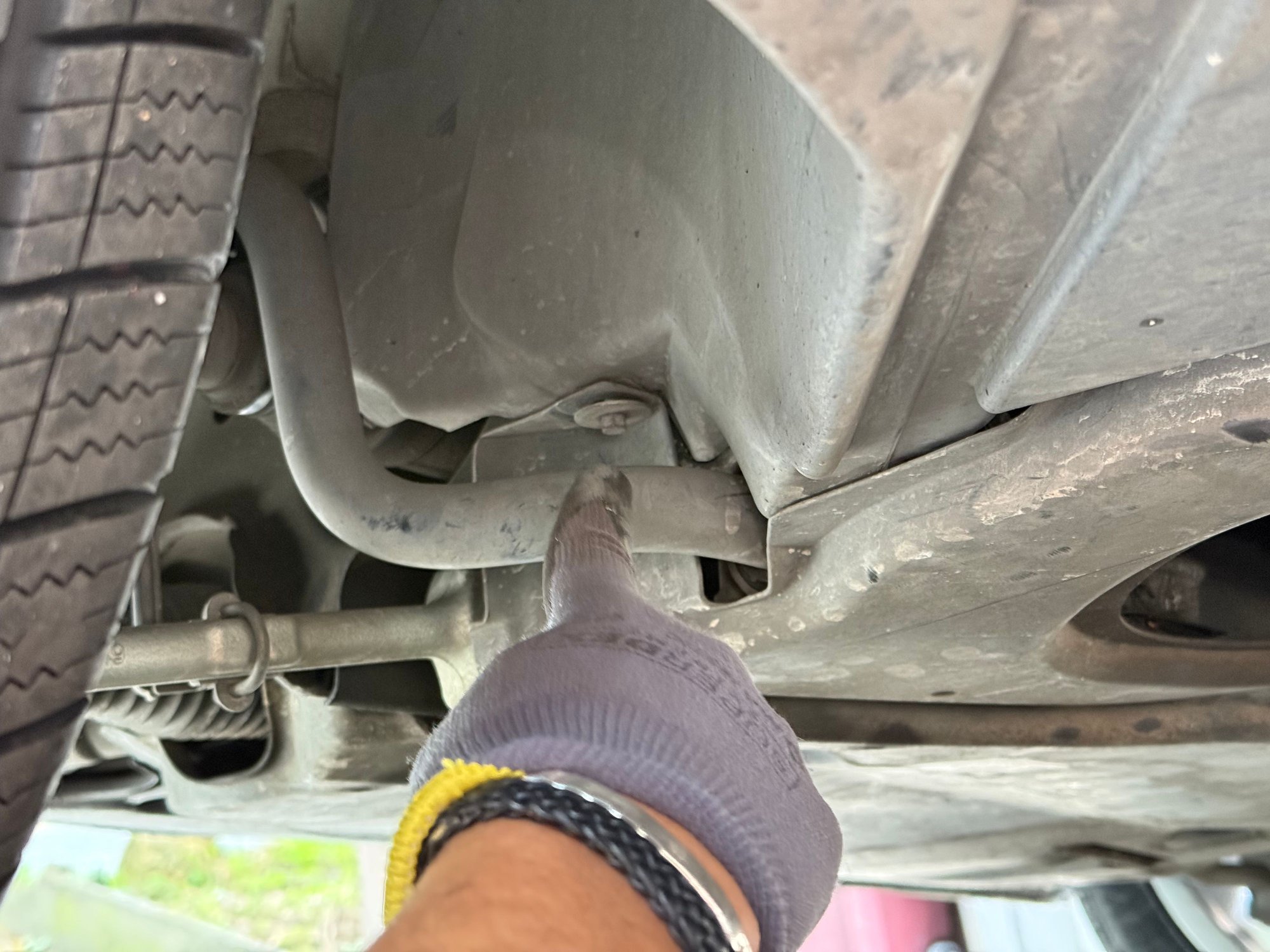

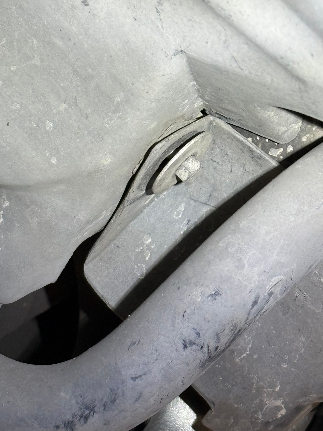

as soon as i got home, I lifted the car and checked for loose parts, and I found this loose screw. Pic below. I am going to tighten it and drive around.
when I tap on that plastic shield, it does make a similar buzzing sound cause the washer oscillates against the screw head.

After tightening the screw and also adding a missing screw to the other side, same location, I drove it around and the sound is still there.
I’ll poke around some more.
one additional observation, I can make the sound happens if I accelerate past 40mph, and then let off the gas allowing the wagon to coast in gear. A few seconds later, the sound starts. If I accelerate a bit, that sound hiccups. After this tiny pause or hiccup, the sound will return. But if I pump the gas a few times as if to accelerate fast, the sound goes away. Almost like I jostled something back into place.

Update.
after tinkering under the car pulling on shields and tightening screws, the sound didn’t go away.
one morning the sound was there but more faint. So I decided to run it at 100mph in a safe empty road for about 1 minute.
then the sound has not come back after a week.
i wonder if there was something stuck on a rotating part that got unstuck or flew off at high speeds.
thanks for helping. I have no idea what it was but it’s gone now. Crossing fingers it doesn’t return.

Good news it is gone, but if it is the shaft hitting the shield the noise likely returns when the rubber center support bearing holder sags a bit more and shaft lowers.
If the noise returns take shield completely out and see if that makes noise go away. If it does, then you know FOR SURE it is the shaft hitting the shield. Fix is to replace center support bearing and holder.

thanks! I took a screenshot of your reply and will text it to the mechanic. He is also baffled. But this makes sense.
will keep tabs and post any update.
