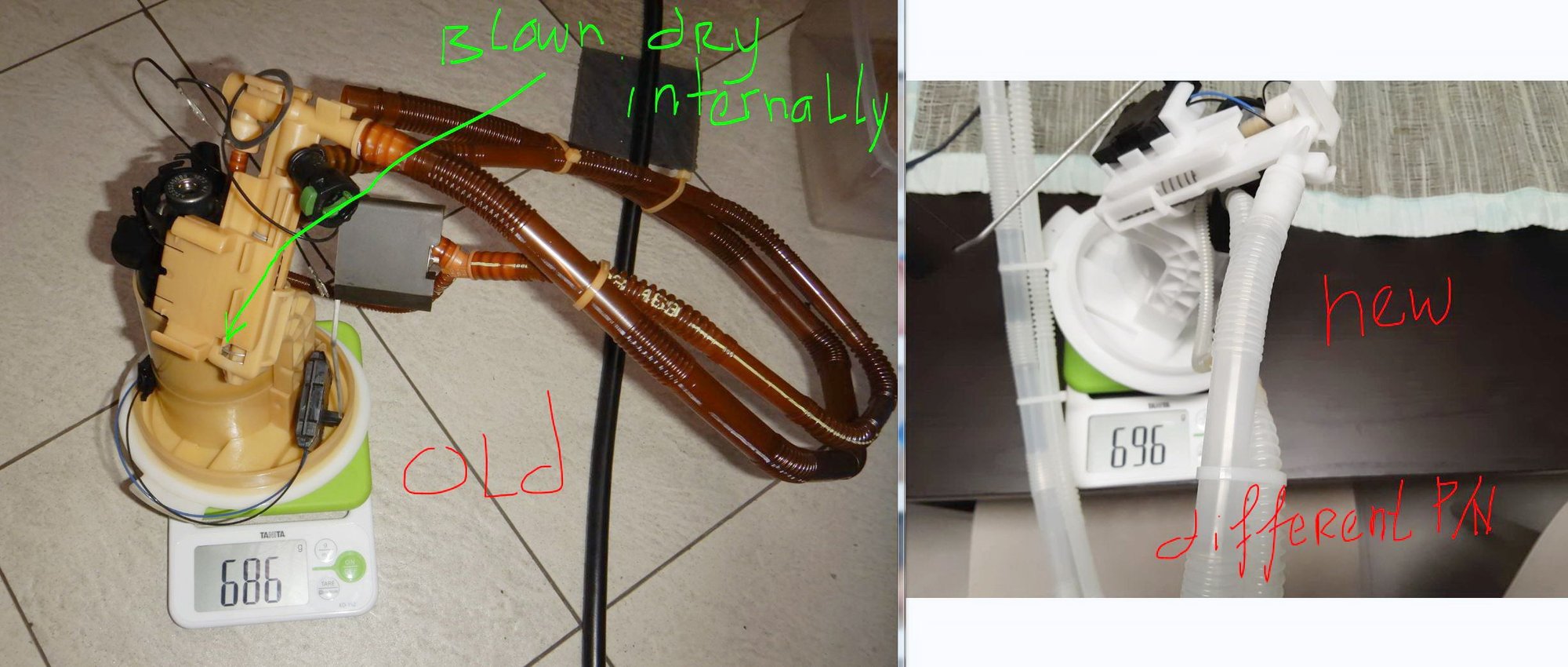

A good example, probably M272 engine like yours. The fuel pump is not yet a 3 phase motor from the wire count.
15 years, dirty or not that flter, replace it anyway.
Here is why :
01. Its paper element glued to the plastic base of the filter ELEMENT maybe too old. Hence the filter is actually not very tight to small debris...as you can see on mine albeit only at 8 years old.
You can read my autopsy report here : https://mbworld.org/forums/e-class-w...er-change.html
02. The small clear plastic hoses, 2 of them which criss-cross between fuel filter at LEFT rear to fuel pump at RIGHT rear get hardened and may loose its good sealing quality.
Since MB design of fuel filter has a return feed to fuel pump called JET PUMP ( venturi effect ) those 2 hoses, one is exposed to about 7ish BAR and that is 105PSI.
8 years old, approx under 35,000KM and a new one

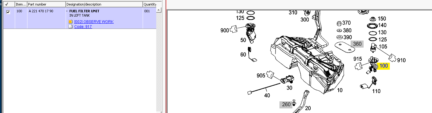

You first must check if your fuel filter and fuel pump lock ring is like the video I linked or different/newer like mine. You need special tool if yours is like mine.
You need to remove BOTH fuel filter and fuel pump, because of that criss-cross clear hoses.
You need to drain your RIGHT side fuel tank which is FUEL PUMP location, as it will have more fuel than the LEFT side which is FUEL FILTER. This is how fuel pump can suck fuel all the time and is cooled by fuel.
Your fuel gauge can not tell the true fuel level at RIGHT side fuel tank, because it uses two fuel level sensors at Left and Right side of the saddle tank and average it out.
All above information , in the link I gave you when I did the fuel filter change.
Good luck............
