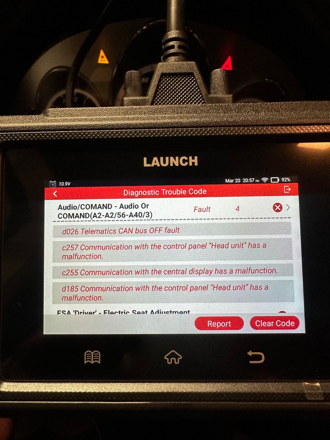

I got these codes. Any help will be great

First line is the root cause
Well, the right tool really helps
CMD BUS issues
You have a 80% chance the display can not work due to telematics having issues. This stops the CMD boot enumeration.
Now I think top job is to troubleshoot line 1. Telem. Module either in the rear left or center. See it with scanner.

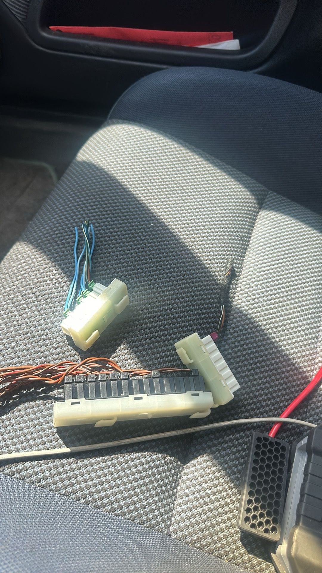

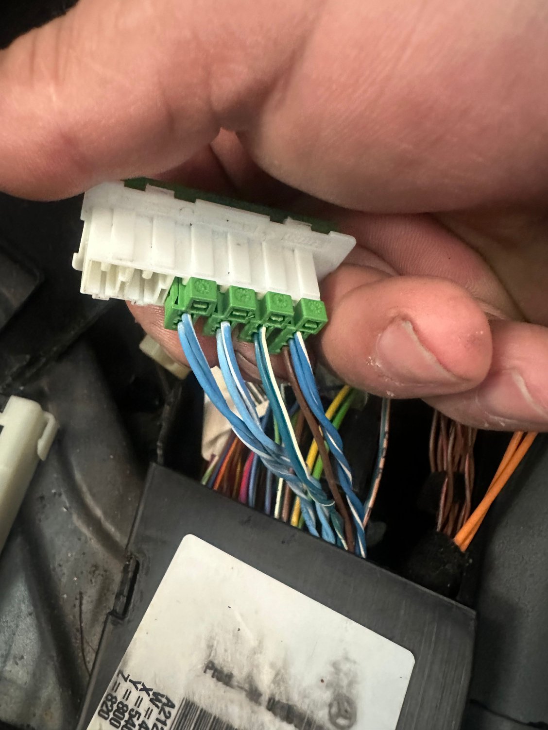

Old Mar 26, 2024 | 05:02 PM
viper123's Avatar
Joined: Nov 2018
Posts: 14
98 Nissan 240sx, 91 Mercedes 300ce

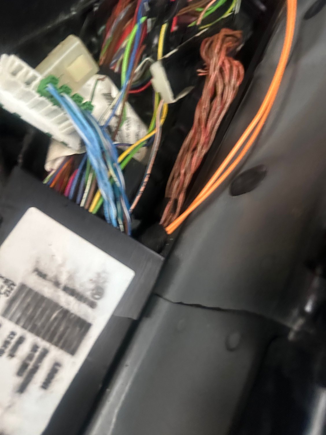

So I got it fixed. It was the com bus it had green corrosion. I got another one and boom it worked. Thanks for all the help guys hopefully it works for some
one here.

yes the carpet comes up easy. There is an aluminum box take off the 4 nuts. In the black cover by the rocker panel you see wires open that up and you see these can bus. See if you see any green corrosion.

Old Mar 27, 2024 | 05:27 PM
CaliBenzDriver's Avatar
Joined: Apr 2019
Posts: 11,923
Likes: 6,776
From: Silicon Valley
W212 MY'14 M276-3.5NA @75kMi
water intrusion
The same CAN BUS B crosses over from driver to passenger footwell... both sides have distribution bars. Takenpictures and mark your wires before getting creative or mad with tiny wires.
