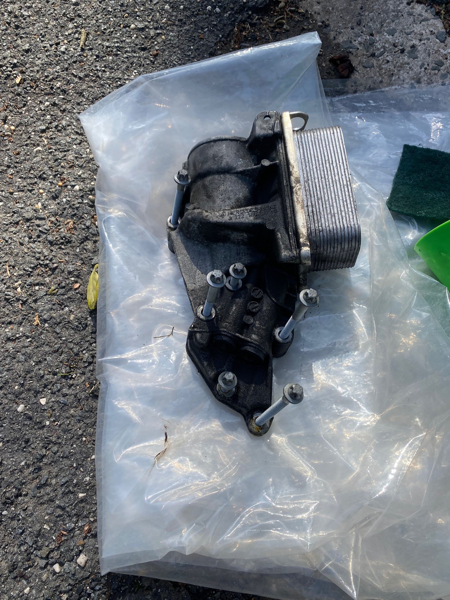

I replaced the oil filter housing yesterday....
Process of gaining access to the oil filter housing bolts.
Old unit removed and the various length bolts placed in their appropriate location for the new housing.

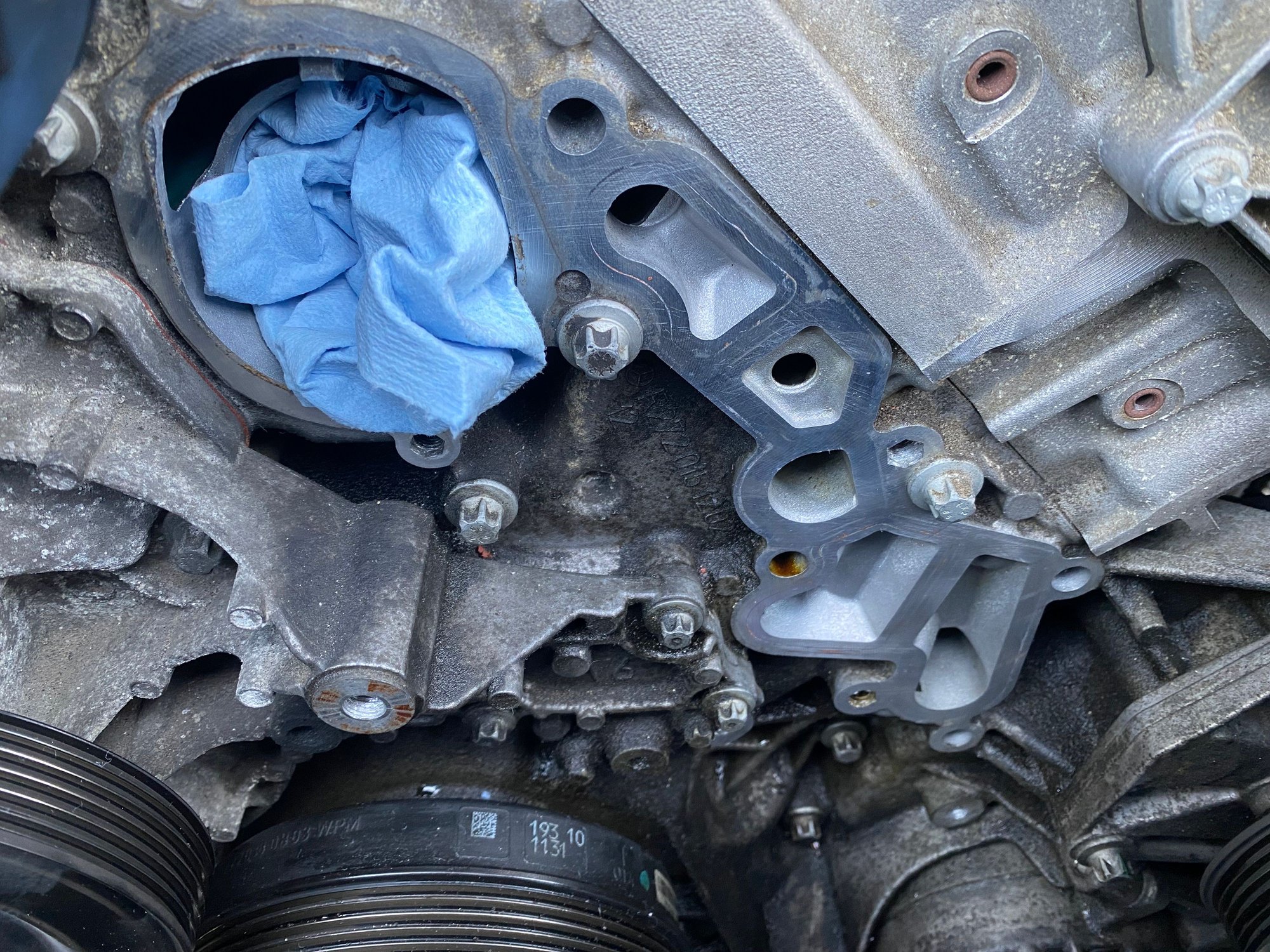

Mating surface cleaned and prepped for new unit.

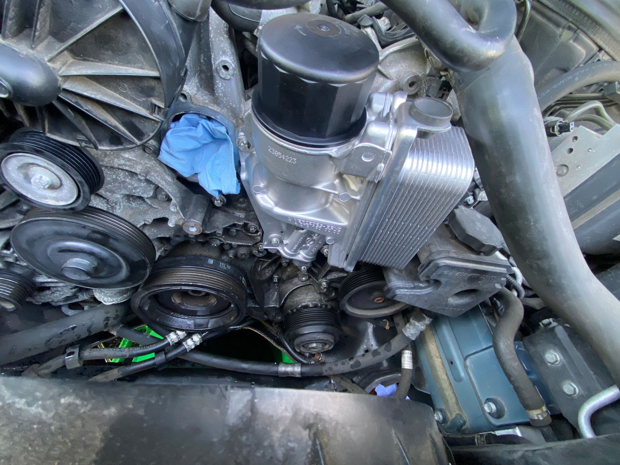

New unit bolted, torqued and reassembly of related components.

Don't want to rain on your accomplishment, just a heads up, but maybe you already know. Most, if not all, aluminum hardware is one time use. I have been having to order from Mercedes since FCP only carries a few sizes.
Old Apr 15, 2024 | 04:55 PM
CaliBenzDriver's Avatar
Joined: Apr 2019
Posts: 11,924
Likes: 6,776
From: Silicon Valley
W212 MY'14 M276-3.5NA @75kMi
finger tight filter cap...
and while we're there...
Personally I install my oil filter cap only finger-tight.
It makes zero difference for the O-ring that is not under any compression torque.
It prevents tugging on the long aluminum fasteners and popping the hardened seals you've just replaced.
I think OEM specs calls for 20Nm... ouch!
