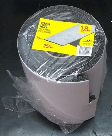

Some annoying noises in the doors and interior panels when you drive over bad road surfaces.
The clips that hold the side cushions can move in the slots, so can the clips that hold the rear seat.
I fixed them in position with a tube of silicone applying some to each end of the clip (arrowed)
The door panels have screws that secure trim parts and can work loose, so I tightened them all
There are loose cables and things floating around that need to be strapped down
I bought a roll of adhesive backed 10mm foam to cut in strips as required to hold things down or pad between things and the door panel
Some bracket type clips that hold the trim panels on roof lining at the rear need to be packed between the clip and the roof to stop them moving
I packed between the two bolt fixing of the door panel to the door with the 10mm foam
The bolts that hold the panoramic sunroof had worked loose and you hear a "crack" when going over bumps
I pulled the roof lining down to access the bolts and retightened them (there are Youtube videos how to do it)
I didn't use any thread locking glue though, I'd rather just retighten them again.
There are a couple of small screws tucked away that are easy to miss so take care that you have tightened them all
