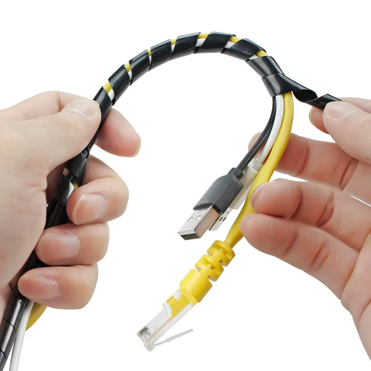

Originally Posted by MB2timer
We used to use a consumable material called chafe strip. It was a Teflon impregnated plastic maybe 1/16inch thick. It came on a spool, but as it paid out it would deform into a helical resting state, to make it easier to wrap around areas prone to wire chafing, or hydraulic and fuel line chafing.
U mean this type of spiral one ?
They don't come in super small size.....
Old Jul 1, 2024 | 01:02 AM
Left Coast Geek's Avatar
Joined: Dec 2020
Posts: 2,412
Likes: 1,482
From: 122W, 37N
2016 E350 4Matic wagon, 2019 Ford Expedition, 2019 Chevy Bolt EV
no, thats just cheap spiral loom...
