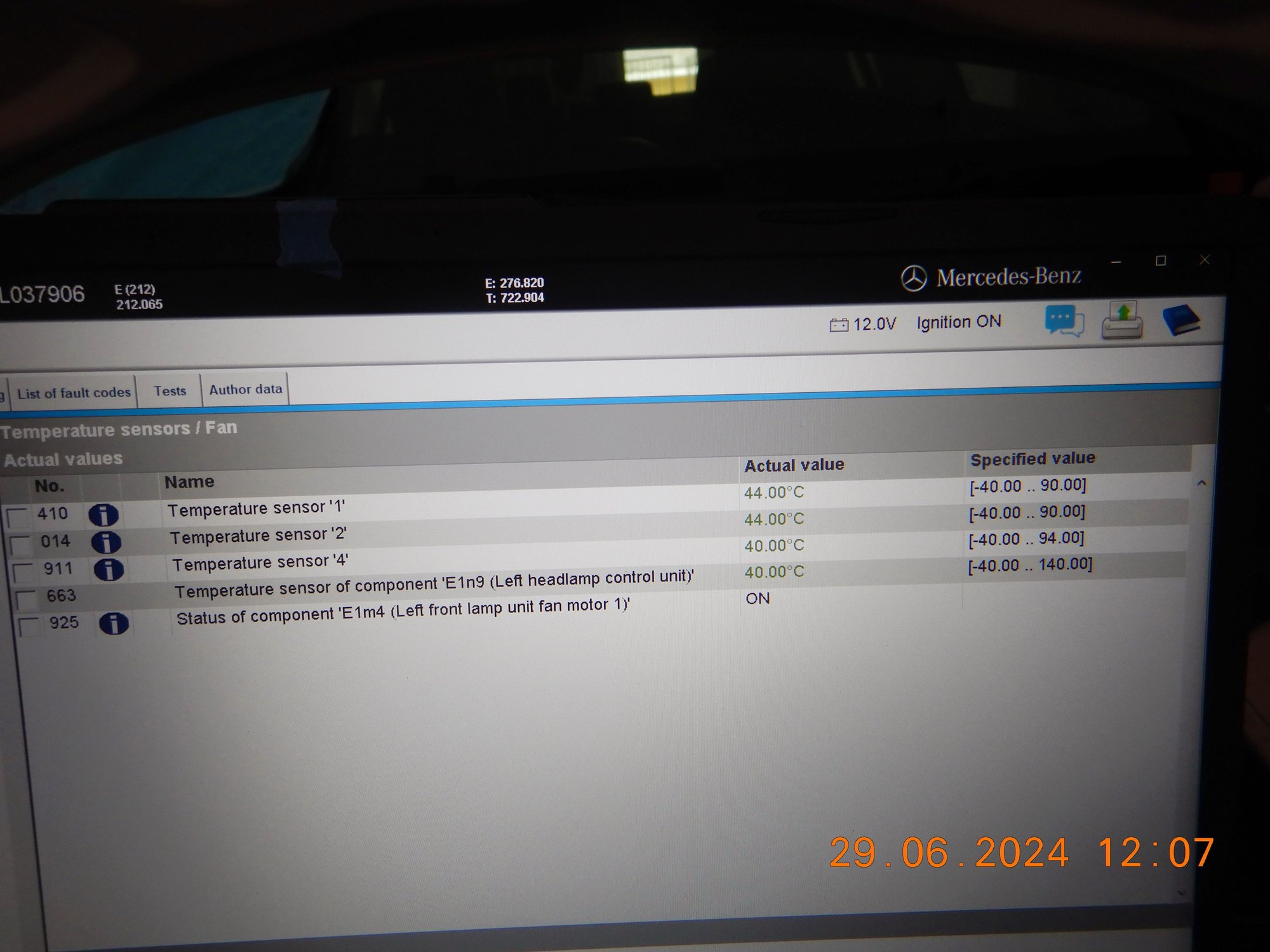

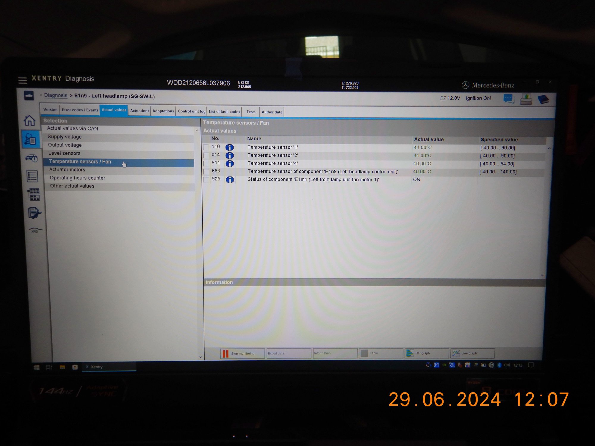

When and if ambient air temperature sensor at the bumper goes bad or loose connection, it may make headlight cooling fan run more.
One time I forgotten to re-connect the ambient air temperature sensor because I was removing the bumper, and then the LED cooling fan kicks in when it was not supposed to.
Read here : https://mbworld.org/forums/e-class-w...ip-sensor.html
LED headlights has many temperature sensors inside it and also at the modules.
