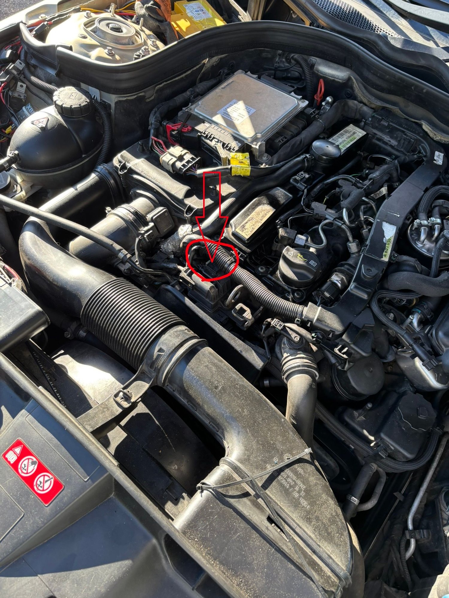

Hi everyone,
buckle up, I’ll try explaining this as best I can, I apologize on beforehand in case I am explaining anything poorly.
Car: W212 250CDI 2011 Blueefficiency Avantgarde, i.e OM651.924.
Symptom: Car randomly shuts off while driving, so far only when engine is up at working temp. Some times car can be started right after it shut off, at times it can be started after ~10 minutes.
This weekend for example I drove 50 km one way, car shut of after 27km, started right up and went well the rest of 23km the way there, on the way home it went just fine.
Other days the car refuses to start, always when the car is warm, never been an issue with a cold start. Whilst it refuses to start it has so far paid off waiting 30 - 90 minutes before it finally starts.
All whilst not generating an engine lamp, although there are fault codes, listed below.
Fault Codes read with Autocom (Photo in attachments):
  • P0340 - Intake Camshaft position timing (Bank 1)
  • P0344 - Camshaft / Crankshaft position sensor row 1; incorrect adaption
  • P2A00 - Lambda sensor 1, bank 1 malfunction
Other observations:
The extra water pump by the coolant resourvoir is whining at times.
Prior to this issue the car would go into limp mode of going uphill in speeds above 115 km/h where it would complain of P0252 (Injection Pump fuel metering control A Range/Performance(Cam/Rotor/Injector)
I’ve performed a leak test of the injectors and gotten even values on all injectors.
Parts I’ve changed and done somewhat recently:
  • Fuel filter
  • Fuel filter holder
  • Camshaft sensor (Year ago and didn’t correct first fault code)
Less related stuff but in case I’m naive I’ll list them
  • Fuel return line from the injectors
  • Charged both batteries
  • Handbrake rear both
  • Shocks rear
  • Changed my oil
  • Had Mercedes service gearbox
  • Brake pads
  • Windshield wipers
I’m going mad trying to troubleshoot this, any help or idea to throw at me would be apprechiated.
Thanks
William

First off, sorry for not getting back to you, I lost my temper and got a company car for 1 month (Tesla, yuck) and then drove my dads clio
I've driven the Merc for a week now, mostly been fine but I've had 2 occasions where it shut off.
- First time it shut off on the highway, I was driving ~110km/h and it shut off, but it started again before I was at a full stop and was fine to keep driving
- Second time happend yesterday on the highway ~ 130km/h and it shut off, this time I had my iCarSoft with me and began troubleshooting.
Whilst not starting (Data from second occurance, video on it as well)
- Rail Pressure = 450 - 477 bar
- Injection Quantity = 0mg/Hub
- Power consumption of component Y94(Quantity control valve) = 146 - 151 mA
- Power consumption of component Y74(Pressure regulating valve) = 650 - 675 mA
- Status of synchronization between crankshaft and camshaft = Synchronized
- Low fuel pressure = 4,00 - 4,09 bar
- On/off ratio of component Variable fuel pump = 93 - 100%
- Fuel pump = Avtivated
I must admit I am lost as to what to change, maybe there's gunk somewhere? Due to the rail pressure I doubt it's either one of the fuel pumps but rather gunk or faulty valves.
Image of leak test performed, its 4 cyl hence 2 empty.
Video from where it actually started
Error codes

I did not consider that at all, thanks for pointing this out, one thing to note is that that is with AC on which I believe should up the voltage due to the YOYO as I've read on a somewhat similar post.
Although it should be said that what you're seeing is a hot engine at idling which I deducted may prompt the voltage to be low once started but it's below 12V and I see the gravity of your point and agree.
Main battery has never been replaced during my 2.5 years of ownership, aux battery has been replaced about 2 years ago since Hill Assist didn't work and I measured low voltage, non oem battery.
To further validate your point I have gotten different dash situations when the engine stops responding, sometimes the lights on the dash light up and sometimes it doesn't.
I'll record the voltage when driving later on today, I try to keep myself only driving when there's light traffic
I look forward into speculating whether this could be the battery/alternator or some more in-depth issue.

I think there are two good point to check next:
1. Your alternator output as your battery voltage with the engine on should be close to 14VDC even in idle.
2. Your rail pressure with the engine under load which should be close to 1.600 BAR.
Your low pressure fuel system seems to be fine, hence electrical fuel pump and fuel filter can be excluded. Based on knowledge from other diesel MB engines, I suspect your engine has two methods of controlling the fuel supply to the common rail; the fuel metering unit (which controls how much fuel is fed to the rail) and the pressure release valve (which "dumps" the rail pressure when needed). Is the issue is not related to the low voltage or a bad high pressure fuel pump, I would try replacing the FMU as it could be preventing fuel from going into the rail before going for a injectors replcacement.

I would change the crank shaft position sensor. It fits well for it to fall when hot and then return when cooled down.

Crankshaft Position Sensor has yet again been exchanged for a brand new Bosch one, the car keeps on throwing the code of P034031 which the iCarSoft translates to
"Position sensor 1 for the intake camshaft(cylinder BANK 1) has an electrical fault. The signal is not present" - Code is current whilst car is running and historic when car is off.
The above makes me suspect that the wiring is the issue here or possibly the cars computer. Although I do not think this is related to the car shutting off as this code has been existing since I bought the vehicle and according to Autocom, for ~66 000 miles.
However! I received a new code when the vehicle shut off today which I haven't noticed before, went to current whilst trying to start the vehicle for a duration of time ~5 minutes.
U143364 - "An unreasonable signal 'state of circuit 15' was received. There is an unreasonable signal"
Thought I'd start of by chaning out more or less all the fuses in the car due to a lack of a better idea, although I realize that the signal shouldn't be affected by a fuse?
Any info on what Circuit 15 is would be greatly appreachiated, currently reading through another forum post which describes it. https://mbworld.org/forums/e-class-w...-87m-50-a.html

Swap both camshaft sensors between the banks to see if problem follows the sensors.

I may be mistaken here but I thought there only was one camshaft sensor on the OM651, are you sure that you’re not confusing my engine with a V-Engine?

Indeed, m651 has just one camshaft sensor.
"Position sensor 1 for the intake camshaft(cylinder BANK 1) has an electrical fault. The signal is not present" If this Fault code is still present, you can try start the engine with this sensor disconnected.
If engine starts and runs the same, than this Fault Code is real and you have to find the "electrical fault', meaning wires and connectors if the sensor is new and suitable for your car.

Yes, thought it is a v6 engine. Did not see clearly anywhere the engine detail and then the error code talks about Bank one like there was another bank. If only one bank no need to mention bank number.
But, does it not have cam sensors for both intake and exhaust shafts?
If not then replace the one sensor you have unless you did already.
