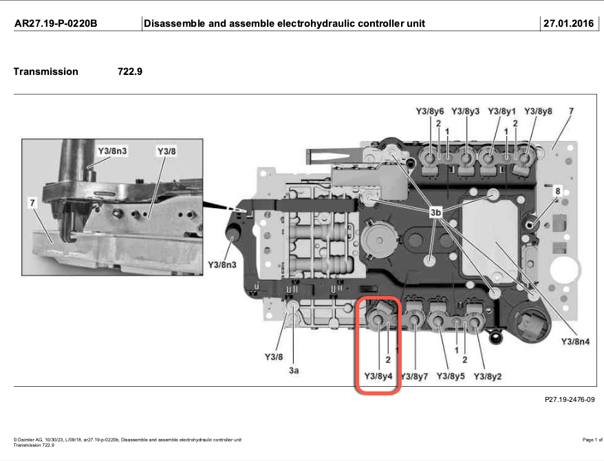

Hey MB owners, My name is Jeffrey and I am new to this page. I drive a 2011 E350
. Hope to get information and share information as I like to work on my car from time to time. Currently having issues with the transmission going into limp mode. It started a while back and I would just cycle power to get it to clear. That worked until it didn't work no more. I went ahead a changed the oil in the transmission along with the filter of course. Removed the Conductor plate while I had the pan off and cleaned it. The code that I was getting was a 2716 which populated a faulty y3/8y4. I didn't change the solenoid out of ignorance and since the given symptom could have been cause by dirty fluid. Oil was in obvious need of replacement but the pan had no signs of metal or heavy debris. I used a multimeter to check continuity on all 8 solenoid and the checked out good. After the oil change the problem went away but it recently came back. I have order the solenoids to replace them and hoping that it does the trick. Thou, I am uncertain if the solenoids need to be calibrated some how and also if I need to replace all the bolts that holds the pan since I changed them 2 months ago. If anyone has had a similar issue and would like to chime in it would be greatly appreciated.

Did you change out the 8 solenoids? How exactly did you clean them?
I read in one of the transmission threads that the solenoids are matched to the valve body and that they are not designed to be replaced. That doesn't make sense since you can purchase them separately from Mercedes. You do, however, need to perform a gear selection adaptation of replaced solenoids. There is also a video on YouTube showing how to clean the solenoid screens with a magnet.

This may also help. Please note that the document has an error. When you read it, it will show pictures of the ends of the solenoids. Caption of picture B says you can reinstall the solenoid. This is wrong because further in the text it says to replace any solenoids that look like pictures A or B.
EDIT: After watching the video again, picture B may be OK.

No, I did not change any solenoids that time. I just cleaned them using break cleaner which according to the video is a no no. I do not recall seeing anything out of whack. I am wondering if the car will not run if I proceed in installing the new solenoids. I dont see how the solenoids would be programmed since they are just that, solenoids. I may be wrong!
I will be at it this Saturday and I hope I get it going.

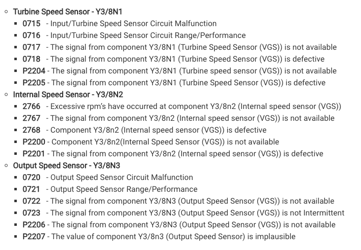

I have used CircuitBoardMedics and they know their stuff. $400 may be worth trying before spending $2000+ with the dealer. The local shop doesn't know what they are doing -- unless it is a full rebuild of the tranny -- or maybe they do to get your money. You can get a certified rebuilt tranny for $3500 from https://fdt-online.com/722-9.html. I would certainly get details on what they propose doing.
Since your DTC identifies the K3 Clutch Control Solenoid Valve as failing, this may be helpful.
There you go: the infamous K3
this 722.9 needs frictions... NOT a control module
that's a different job all together
Time + money saved txs to @JettaRed
