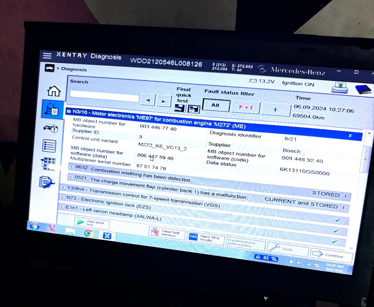

oh no. I think i got bigger issues... got the Launch scanner and seeing this DTC 0521 "The charge movement flap (cylinder bank 1) has a malfunction". Quick search points to needing a intake manifold replacement!!! yikes!
Other threads point to this fix

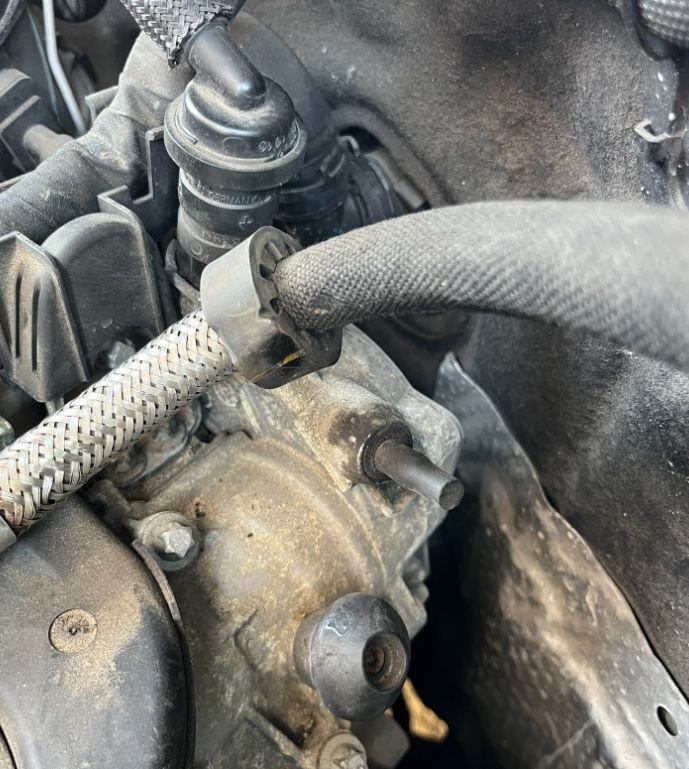

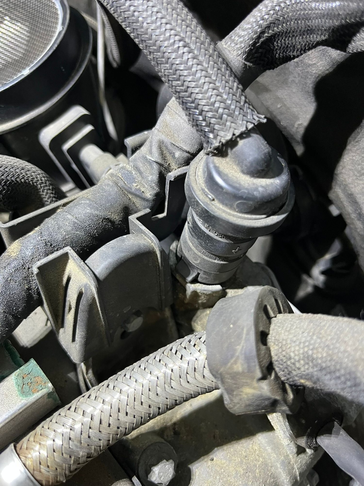

if your engine uses a vacuum pump then double check its small check-valve is not wasted. (A $5 part instead complete intake plenum)
i do have a vacuum pump. what small check valve? This one? How do i know it's bad?

Here's info on the check valve. Not sure it is exactly the same on your engine.
https://mbworld.org/forums/w212-amg/...ve-repair.html

Could something else give me that DTC 0521 "The charge movement flap (cylinder bank 1) has a malfunction".

The link @JettaRed gave you
shows a small check valve that is used to feed vacuum to intake diaphragm actuators.
MB vacuum check-valve
This is consistent with your error code... Your unit may look different yet same job to hold vacuum built by the pump.
> SCENARIO:
-- The ECU actuates solenoid valve to enable intake flap vaccum but nothing happens because there's no vacuum to work with.
-- Check that you have vacuum available,
-- Check valve is ok and
-- Check actuation command with bi-Directional test with your scanner. Don't assume it's good until your testing shows it's working.

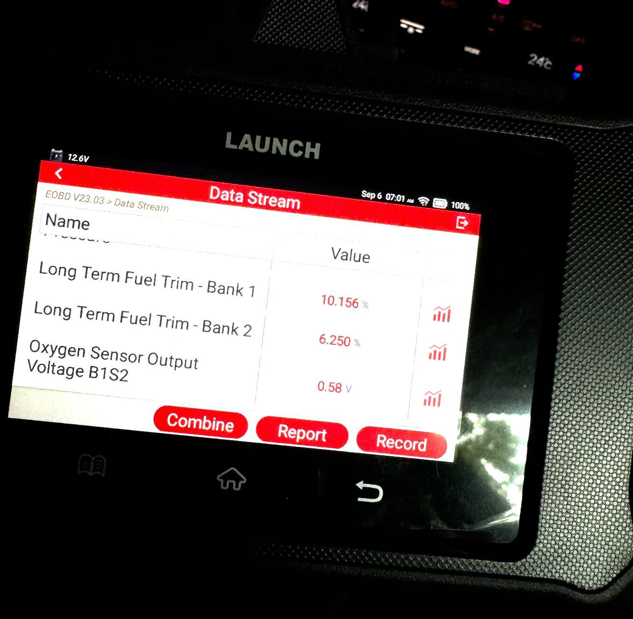

One more thing, can you check the Long Term Fuel Trim (LTFT) figures on your car? I want to compare with mine (I have issues with that for a while)

How do I check the Long Term Fuel Trim (LTFT)? Can i do it with the Launch scanner?

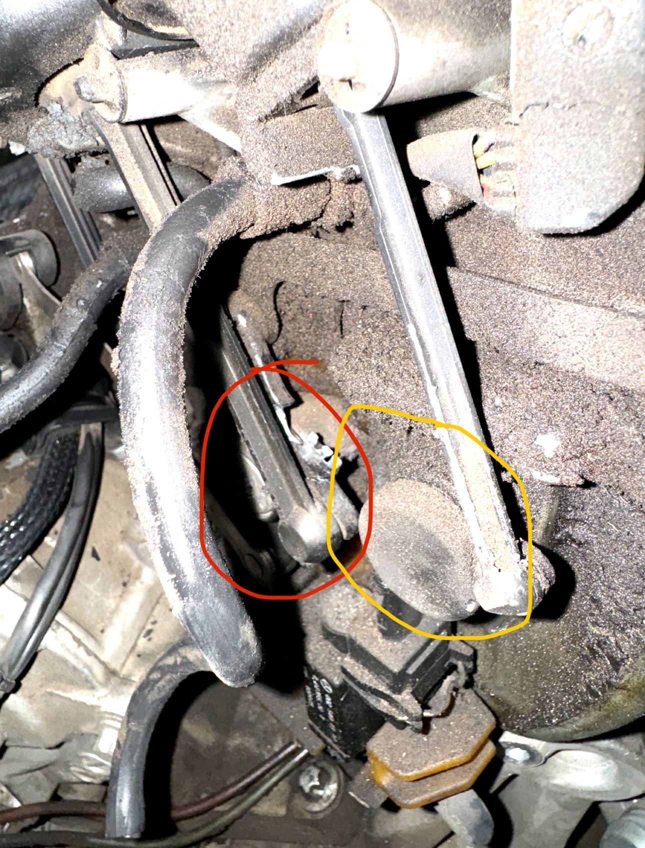

I have the 0521, oddly this was not detected on launch until a shop check using xentry. (maybe coincidentally the lever just broke very recently)
red one is the broken lever, yellow one seals are started to failing. a lot of oily dusts there
i also use launch, you can see fuel trims number on obd2 mode
Initially I only replaced the parts that broke, but a month later I purchase the whole intake assembly (pierburg).
When replacing or repairing the intake make sure you also change the manifold gaskets and injector seals

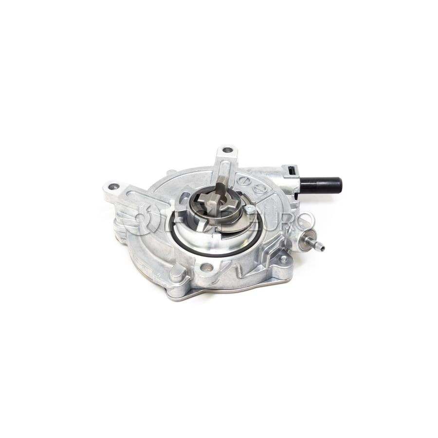

so my vacuum pump don't have the same kind of valve. mine looks like this and it doesn't go anywhere. there's a small hose that just cap it off after about an inch. Does it still apply?

Your vacuum port #2 is metal... the later model good upgraded to plastic .
The tiny check-valve uses a membrane and that has a limited life being in a hot oil bath. Test it to see it can hold vacuum.
No vacuum means no power available to actuate intake flaps.
(1: to brake booster) - 2: to vacuum accessories
Do you have good vacuum to accessories diaphragm?
Use your scanner to command vacum ports.... use 12VDC if you have to (without computer in circuit).
If the small check valve failure has materialized... don't replace the pump, simply add one inline. $5!
The big garage-door spring benefits from being lubed because the coil develops friction winding and unwinding... lithium grease.
Dual springs setup better than single one!
My vacuum pump looks like this. the small valve doesn't connect to anything. Can you explain how to test the vacuum like for dummies book? Haha.
Yea, I'm having the garage repair install two springs while he's working on it. thanks for the tip on on lithium grease!!

pumping down CC-pressure.
Our galaxy is a small world!
It just so happen that Master Surya is doing exactly that right now!
M276 has a similar vacuum pp setup (minus the air-injection pump into exhaust).
I am not entirely familiar with your M272 setup...
having said that, the vacuum pp small outlet should be connected and must have a working check-valve in-line as mentioned earlier (don't replace whole pump for $5 rubber piece!).
This is aiming towards... high engine blow-by neagating what vacuum the pump is trying to build.
MS! is pointing at the fact drafty engines have nearly no crackcase vacuum and that impacts the pump output.
The vac. pumps down x-PSI below the crankcase pressure present at the pump exhaust port.
Case in point... the brakes improve when the piston rings are well sealed. ie. more vacuum is noticed by brake vacuum booster. Conversly drafty engines have a hard brake pedal!
When drafty crankcase shows some positive pressure, vaccuum is reduced by the difference above zero PSI.
Reduced crankcase pressure is achieved with lower blow-by production and that can be achieved when dirty rings get unstuck by better oiling.
+++ CIRCLING AROUND...
Your current issue has a pretty good chance to be caused by poor oiling and the many issues it brings in the name of "saving gas".
Last edited by CaliBenzDriver; Oct 13, 2024 at 03:55 PM. Reason: added MS. link to Vpp

Mine has oil squirting from the small port #2, the vacuum still somewhat worked (the intake manifold flap still actuates). Can I add the check valve inline if mine squirting oils?
