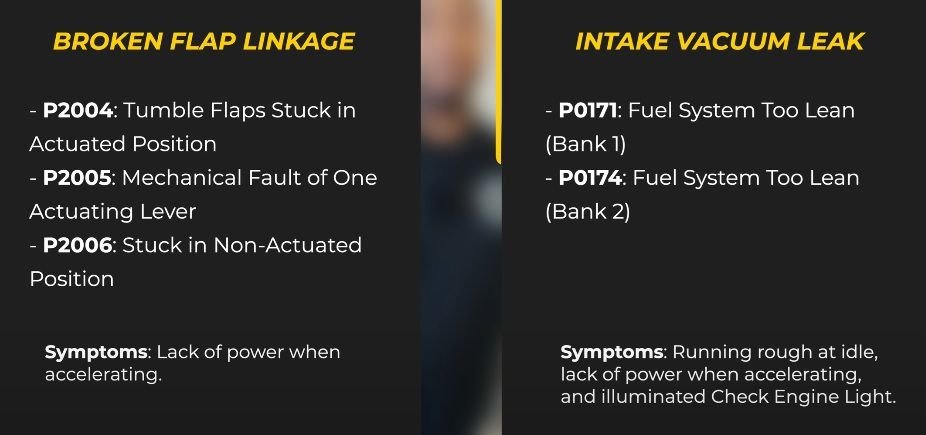

Wow suddenly the M272 Intake Manifold been going bad plenty within this 2 weeks. 3 cars including yours.
Get a Pierburg replacement unit complete. Cost a bit more.
Here are what can go wrong with this intake manifold
And your vacuum hoses will be cracking too by now, those with curved shape and made of rubber.

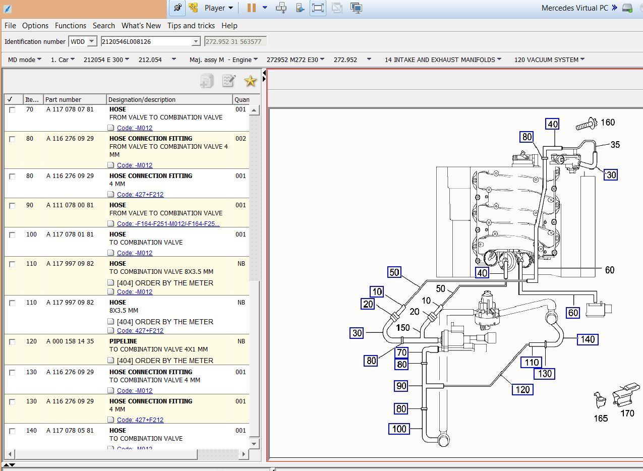

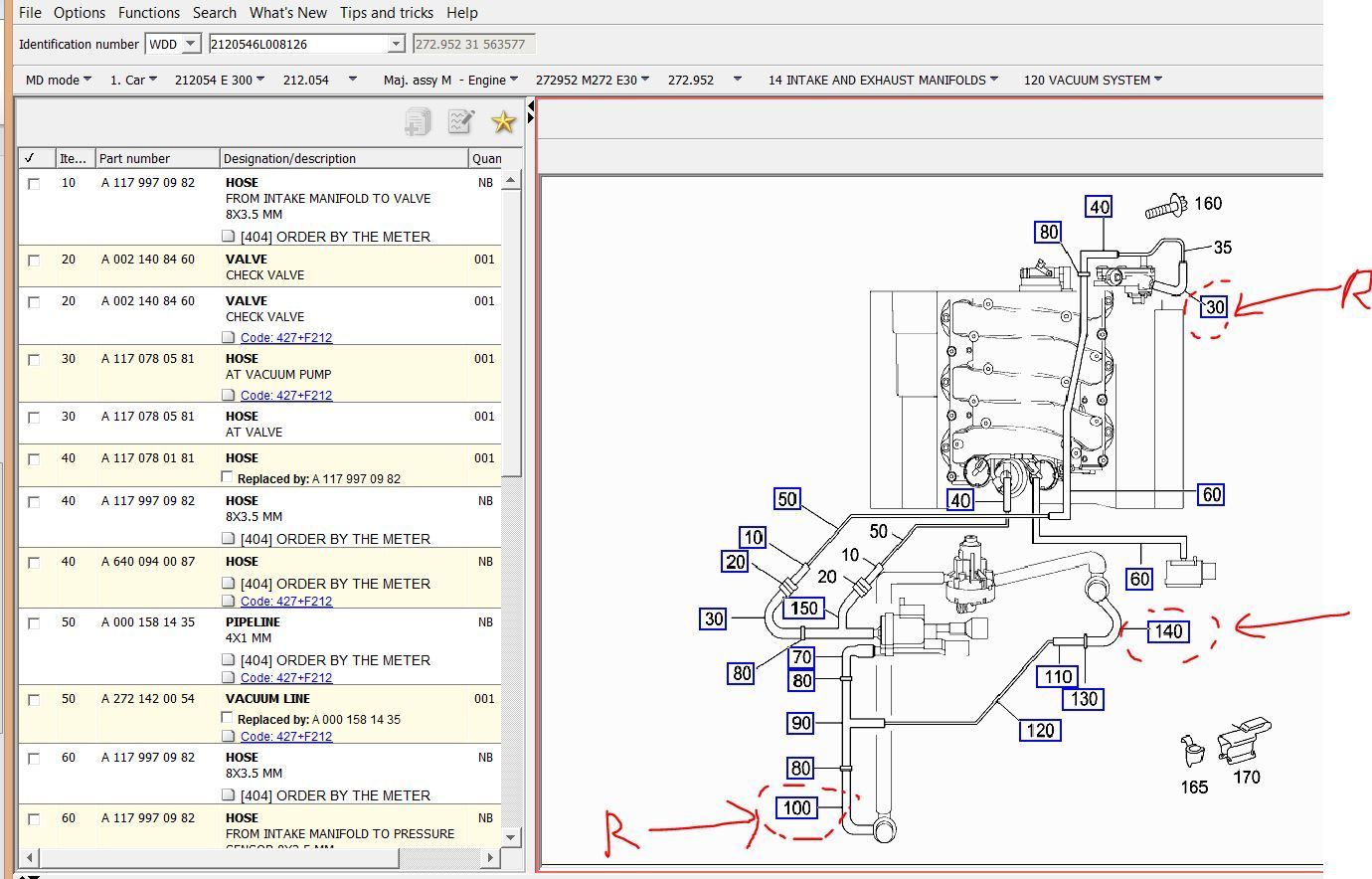

Oct 13, 2024 | 08:13 AM
I was just helping a member yesterday.... read post : #150 https://mbworld.org/forums/e-class-w...ml#post9047578
Those in red and with R is already torn. In red without R, is risk of tear soon.
Since I can't see item #40 & #60 hose, I can't comment but Tesna's car being a 2010 , that hose will tear soon.
Item #50 seems to be hard plastic line, that could live longer I think.
Item #70 and # 150 are thicker rubber than the hose. May live a bit longer.
In my car, all these equivalent hoses ( my M276.820 Turbo 3.0L not so much hoses like M272 ) get replaced by 10th year. It's done already.

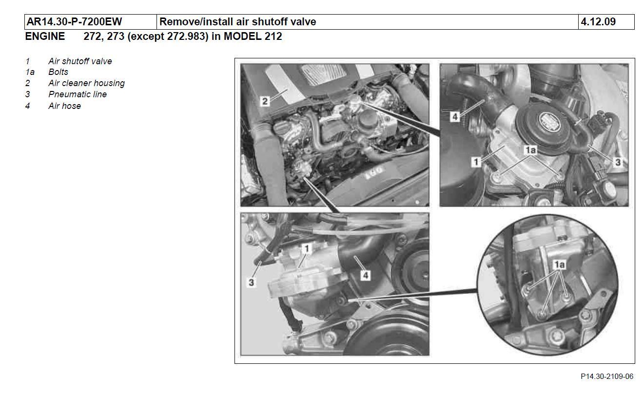

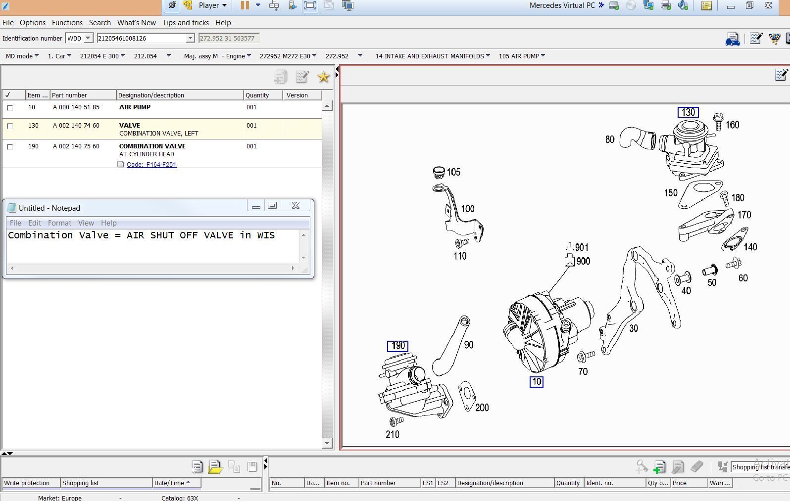

Oct 13, 2024 | 08:18 AM
Combination Valve is = AIR SHUT OFF VALVE, some people call it EGR valve
