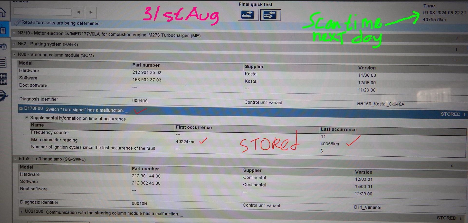

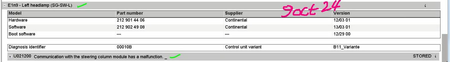

Had twice so far this DTC event, and always on a long trip. The 2nd event on 9 oct 2024, I did not loose function of my turn signal.
The first time, back in 31st Aug, the turn signal won't work till engine off key off and back ON again.
Too bad till today I could not find W212 type steering column full teardown video or photos to see how the signal light stalk mechanism is.
I seen older MB version.

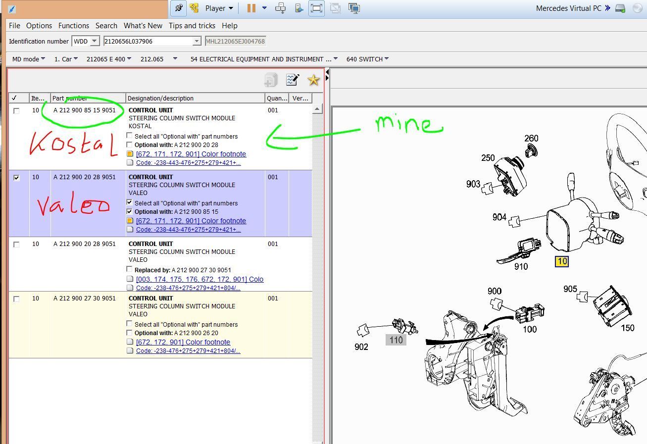

Up to US$650 in USA, but back-ordered and has new updated part number :
Mine is : A2129008515 9051 the 9051 means BLACK COLOR
Left Headlight DTC will also be triggered, because the signal light is at the headlight unit. Left headlight is the Boss of the two headlights, kind of.

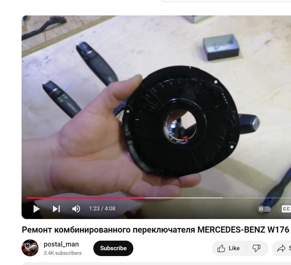

I know you have tear down yours, please share best photo archive you got.
I am curious on the turn signal switch + wiper + headlight stalk

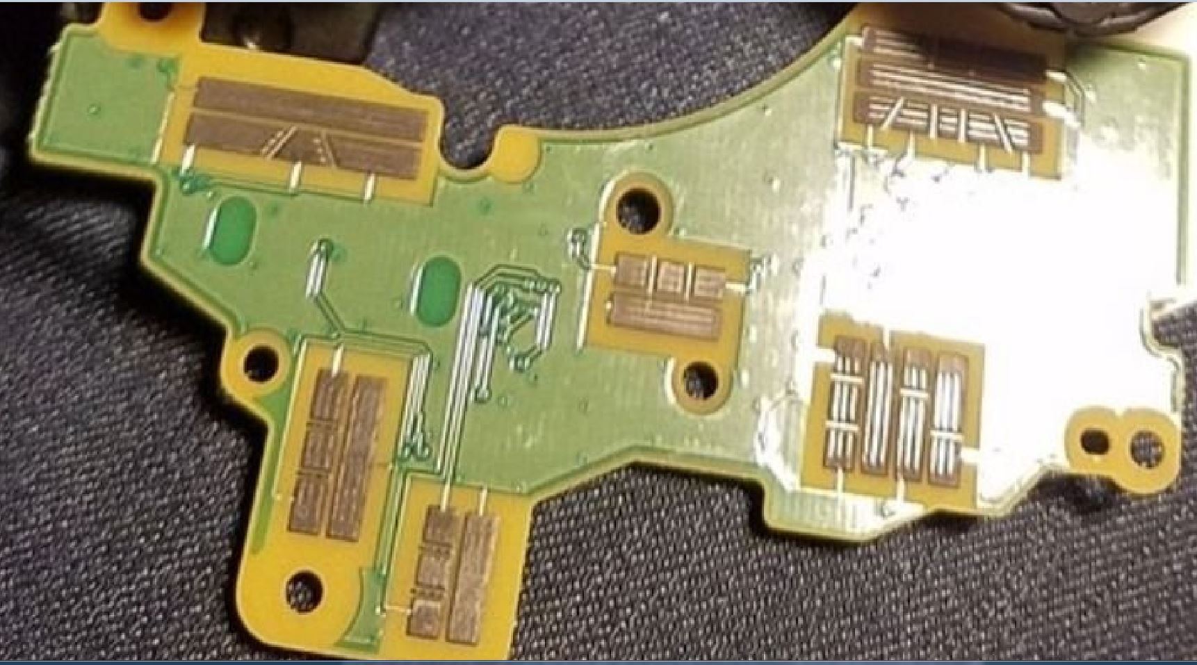

COLUMN COMPONENTS
SCM sandwich is not worth the time to research all the PN#... way too many!

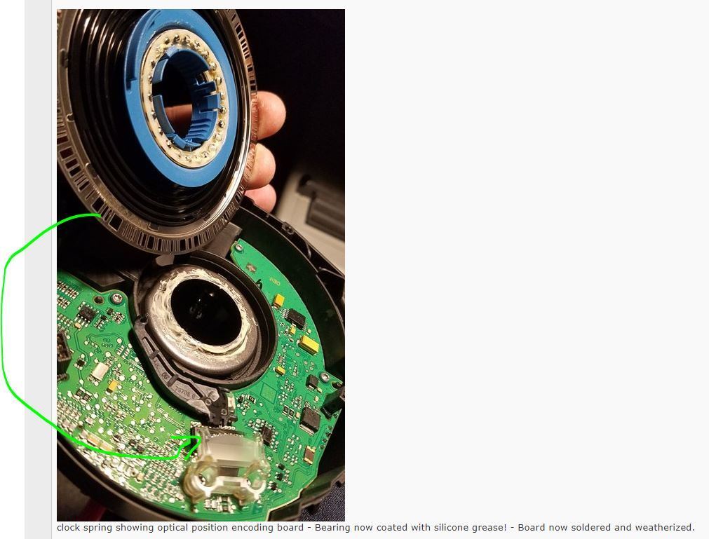

I have this dismantled there....
The T-signal itself is likely not too bad but a surrounding PCB has marginal loose pins....
here it is waiting for attention
I lubed my carbon tracks/sliders with electric silicon grease after gently cleaning carbon with alcohol.
The problem is mostly developed around the premium loose pins used to cut down useability.
Rework solderless + dried grease of:
  • steering wheel boards
  • steering column sandwich
  • tilting column lube
  • EIS solderless
  • A/C flaps modules dried/ solderless
easy access with column removed
impossible with column installed
+++ You'll want a somewhat clean environment to work with SCM + EIS optical sensors. Not a dusty garage bench!

ohhhh, so that is how the contact points looks like .. Arigato Cali San
Folded type springy mini copper bar as pressure maker.

ASK :
Are those round thingy your encorder tone wheel ?
If so, how to remove it from the optical encoder reader without breaking it ?
I mean the other model ( Valeo ) is a pull up removal of clock-spring, hence I wonder how can the encorder tone wheel not break for ur model ?
I keep seeing this model only in utube, I think VALEO. The tone wheel is there and not with the cover ( clock spring ) like yours.

SCM + EIS
the SCM you're showing from Internet does not have the tilt steering option, it looks a bit different as the envodong wheel stays down when module is opened up.
different style from a Youtube.... chassis ?xyz?
yet its similar because it's an easy assembly... it may be impossible to get the top and bottom out of sync. There is no fancy relearning nothing procedure necessary: IN/OUT: Done!
easier than fixing the front/rear SAMs.
the only case that could require a new replacement would be an odd electronic failure.
Repairing circuit without schematic is a 50/50 chance. Usually its the power supply section that overworks caps from crappy Main_GND_Strap.
Power needs minimal ripples. SCM is really low power (unlike MFK is built to be a hot can with limited heat removal).
MS! this is not electronic repair, it's a rework to complete missing soldering. I've seen your electronic tools set: that is well within your wheelhouse.
Disonnect batteries
Pull steering wheel out
Remove footwell lower cover
Unplug SCM connector...
Pull SCM out
open the oyster shell
operate your magic steps ***
slap back in reverse!
(No Xentry procedure needed)
*** steps being:
lube the dry column ball bearing (brakes silicone)
lube dry slider contacts (electrical silicone)
inspect to solder each loose solderless pins
this SCM unit is easy cake walk unlike amazin' Mitsubishi COMAND with its 50 different screws all different sizes. I am gonna have to fix the day it calls Cali san!
Don't be afraid of SCM if you are careful. Nothing much to fix do much reward with good CAN-Bus.
+++ Now also do EIS VIP right nearby with rear access!
