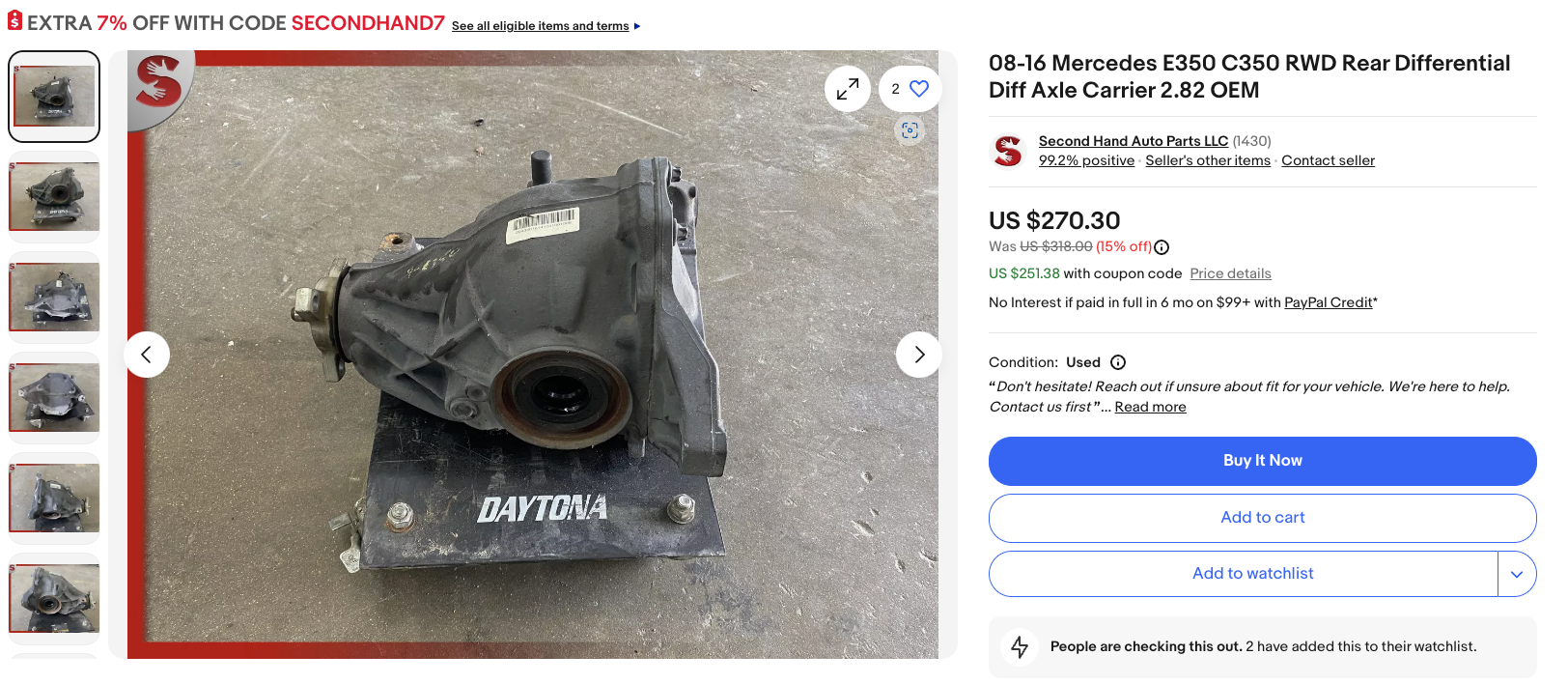

If you are handy, you may be able to replace the rear differential yourself with a used part.
https://www.ebay.com/itm/18663388798...mis&media=COPY

that is a good deal 🤗

Thanks for the replies!
I'll look in to it and if its coming from the diff, the used ones here in Europe usually cost 200 - 500€.
In best case i can sort it out in this week with the help of pro mechanic and stetoscope and post here if we got any progress.
