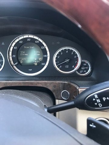

My car is same year and model as yours with 150k miles. It idles at 500 RPM when warm and in gear and its is so quiet and smooth in the cabin that you don't know that it is running. It had the mounts replaced 20k miles ago but before they were replaced it wasn't as bad as you describe. There was a little vibration off idle.

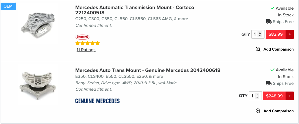

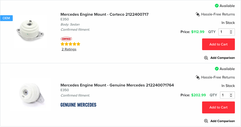

Corteco is the OE manufacturer for a lot of Mercedes parts. Though Corteco is shown as OEM on FCP's site for your car, they are shown as OE elsewhere. I have no problem recommending them. Lemforder is shown as the OE for the tranny mount.
If the shop does use Genuine parts from Mercedes, half the price they quoted would be parts. But, instead of Mercedes Genuine you use Corteco, you can save quite a bit. It's really up to you.

The shop would probably not use anything else other than genuine parts since they work on really
high end luxury cars, and some indy’s do this to make more money. The end difference is only about $300-400 if I use Corteco rather than genuine parts. With mounts being so essential, I would rather pay the extra and not have a headache later although I’ve heard Corteco is the the exact same thing as geniune MB.
Sure. Just providing options. And, if you are paying for labor, you don't want to have it done more often than necessary.

My idle speed with very smooth idle. Took this yesterday
