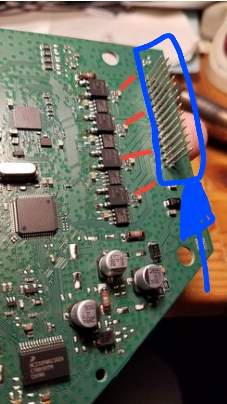

loose pins collection
loose pins actually detune engine with poor ECU timings
Mercedes dealer could never figure why my car alarm would hunk at me after Unlocked and opened driver door - I got fed up and started to fix A to Z...
the worst finding is even the ESP module is quietly impacting ECU/engine.

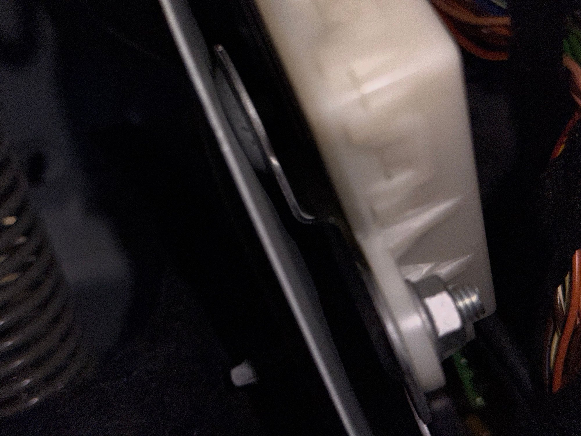

@CaliBenzDriver I just couldn’t figure out how to get that module out of the car! I could only see one bolt…

It's easy to get this entry level module out...
1- DISCONNECT ALL BATT PWR.
2- locate module above R-Sam
3- loosen #10 nuts
4- lift up module out of slotted holes
5- open up enclosure latches
6- keep your hands off PCB... edges better!
7- assess overall condition (post pictures)
8- deliver the fix with hot solder iron
9- (optional PCB conformal coating if you have it)
10- mount back / restore chassis pwr.
11- chassis scan for bus fitness
Now your KeylessG works perfectly better than factory new module.

Do you have any pics of the module case where I might see the attachment points? As you know, this is all done blindly except for the one visible nut in ‘bottom left corner’ of unit…at least on my e63s sedan.
I must be bigger size than you lol…I have to crawl in my trunk, shove my gorilla arm up behind sam…and fumble around 😅
snap a picture I'll point things out (my trunk is all dressed up right now).
Plan B is eBay pictures from p/n.
Took one the other day when I was exploring…but it’s a bit too close up to help I think. Sharing it anyways

EXTRACTING MODULE....
trust yourself, this thing is going to come down before you know!
Use a mirror + flashlight to help yourself if you have to.
There's a chance the plastic enclusure is fastened to a mounting braket that's attached to the chassis.
Take your time, it's not German rocket science.

Sorry you have to put up with keyfob nightmare.
This is an unbelievably bad testament of shoddy work! How in the world did this even function properly from the factory with solder joints looking as poor as that? Wow!!!
I haven't addressed my half-working taillight lens but have read it's a similar malady with broken/cold solder joints ...ridiculous!
And thanks for the post/pics!

PURPOSELY DEGRADED BASICS.... 👏
Edward
These are not exactly missing solder joints forgotten during manufacturing... nope!
These are "pressed pins". They could be mistaken for an attempt not to use soldering if they worked well.
Pins could nearly be okay besides the way they are implemented to cause poor connections. Significant resistance causes voltage drop.
Many paralleled connections should be used for CAN network to lower in-line resistance.
The only thing good is what happens when pins are easily soldered. Modules start working spectacularly well. Every single module I've reworked delivered outstanding network performance So I tend to conclude these pins are premium engineered chaos.
Pins wouldn't be amazin' without the ECU/TCU being so sensitive to network latencies.
This is how cancelling solderless is rewarded in performance transformation.
There is foul play when high error rate of VIP CAN-C modules is concealed below-radar threshold to deliver poor performance.
Somewhere I wrote about the contrast of very nicely CRIMPED + SOLDERED GND wires that end up on a solderless pins.
Can we guess why engineered weaknesses are designed in selected modules and not ECU/TCU?
Because powertrain can be disrupted remotely.
EIS provides the "NoCrank-NoStart" and CGW provides exponential latencies. All this sofistication amounts to mandatory maintenance.

-- Right now Keyfob and KeylessG modules appear responsive... no reason to replace anything without cause.
-- The chassis scan will show if any chaos (footwell/SAM soaker) is actively disrupting basic processing.
-- Current condition has a chance to discharge your main AGM while parked or while driving. Use a float charger to keep up chassis electricals with normal currents to preserve starter.
-- Let's see what your chassis scan leads us....
Use a Launch MB Elite scanner or pls research english code descriptions.
Thank you for the reply.
Im not sure if I understand what you are recommending I do to troubleshoot this...
The short-term steps may be...
-1- SCAN the chassis...
-2- REBOOT the chassis...
The long-term steps may be...
-1- RESOLDER marginal CAN+B modules
What I did was loosen the 3 bolts that attach the metal bracket to the chassi and them remove the keyless-go module from the bracket. One loosen the 3 bolts, the bracket will move up and the bolts head will go trough the enlarged holes on the chassi (see the pictures with the red arrows). Just remember to unclip the red plastic handle for the emergency fuel cap release from the bracket as it will prevent it from moving around. My hand couldn't reach the top mounting nut that attaches the module to the bracket.

thank you Andre for this W212 detail.
Disconnect chassis batteries before any module.

Thank you so much, GREAT PICS!!
