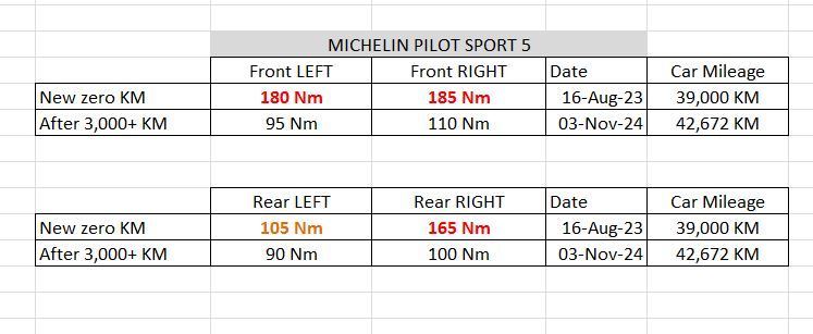

So, 3rd time wheel bent is a charm & Mich Pilot Sport 5 review
Dang.......
I thought my wheel was zero effected by the impact of pothole in this post : https://mbworld.org/forums/e-class-w...are-wheel.html

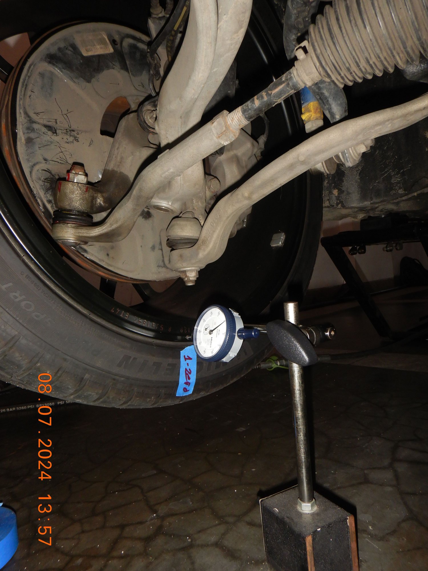

I even used dial gauge to measure / inspect :
The best way to measure is not to use dial at all, but video it and use marker during edit...or go to a wheel balancer shop for them to spin the wheel
The damage is very minor and it is not side way damage thus dial gauge is not effective.
Here is the minor damage.
It does not shake left-right, but produce a very mild resonance at 100 MPH.... but smoother at higher speed.
I got pothole hit on 7th July 2023, Below log is 31st July 2023 I went out of town and has access to a decent highway and quite low traffic at some areas, here I assumed the resonance was from the Pilot Sport 5
which all 4 were having bad RoadForce values.
So next time I will use video instead, save time and easier to do anyway.
So total 3 wheels now and I am out of spare wheels and can't buy from Germany untill BBS Germany sort of their Chapter 11 thingy.

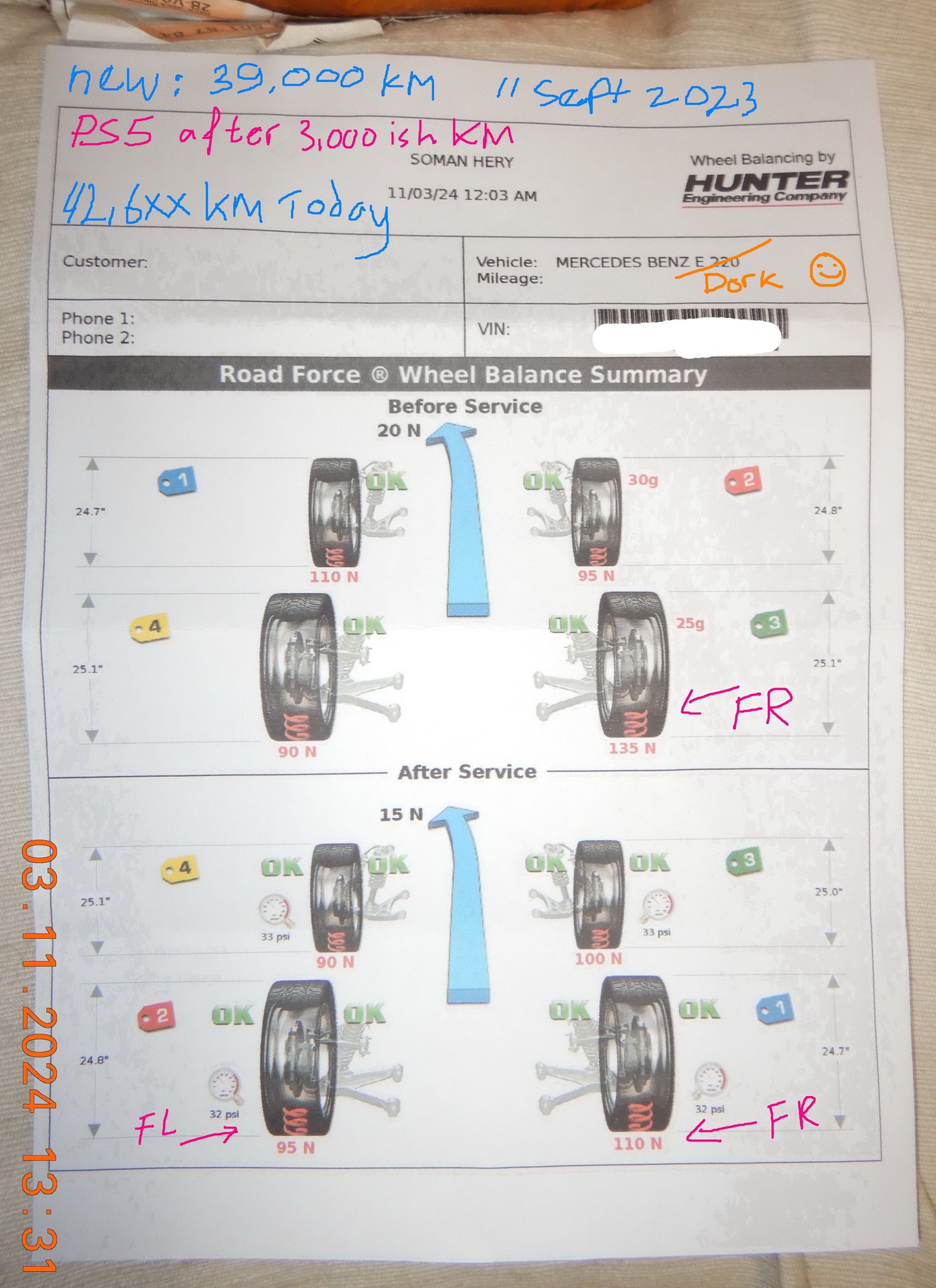

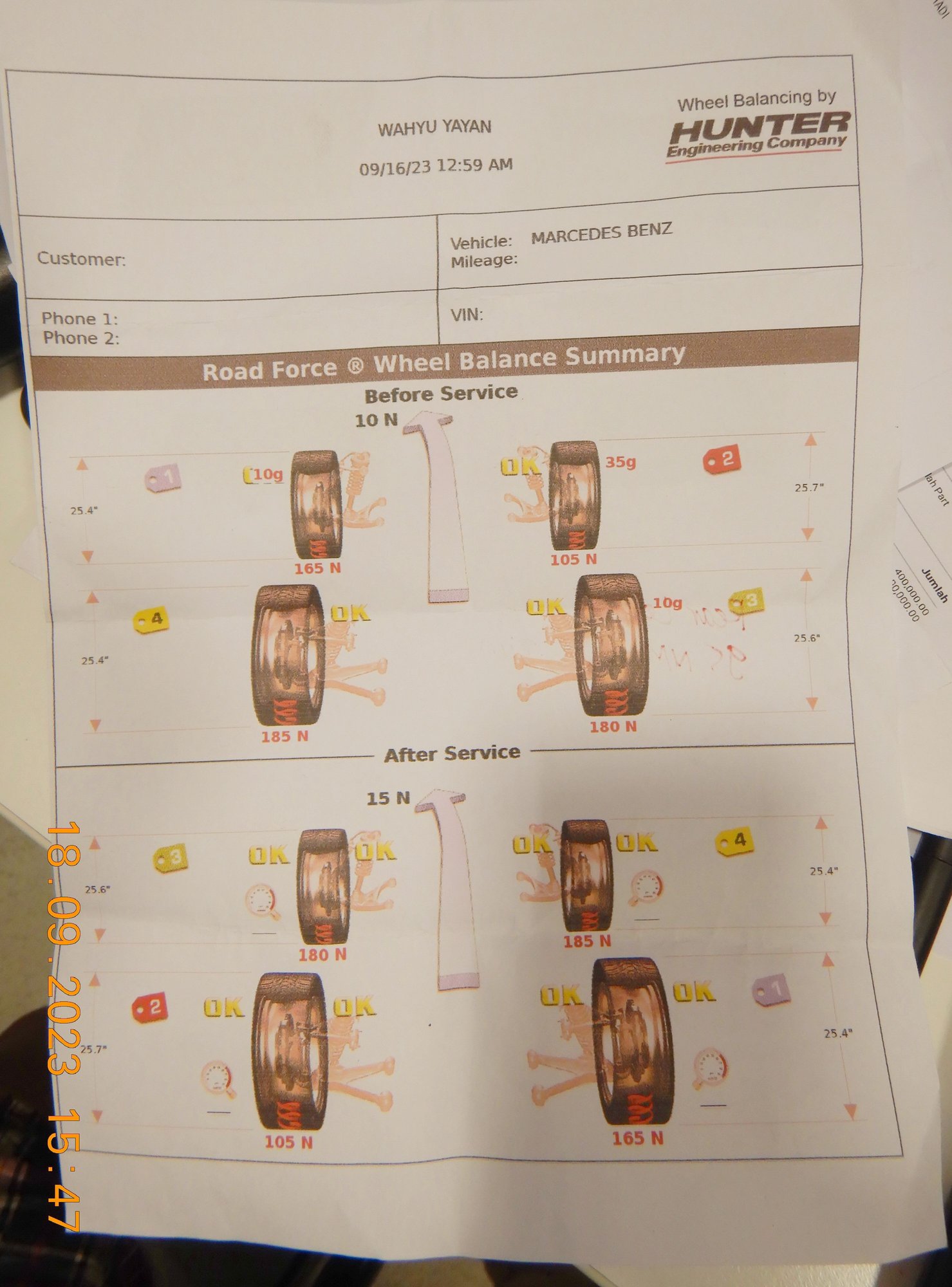

MICHELIN PILOT SPORT 5 - Anything close to 70Nm is bad. Thailand factory.
I am hoping by 5,000 KM of use, it will improve again this RoadForce value.
When new and first installed. I sent my driver with a minibus, my car stay at home.
For my Pilot Sport 4, I have consumed 2 set, so total 8.
Only 1 was a 110Nm RoadForce and I replaced it and I managed to claim a new one. All others were at 50NM or lower.
If only 1 tire at 110Nm roadforce, the car ride like a horse kinda jumpy when at 160KM/H or faster.
Now seeing all 4 of my Pilot Sport 5 having such high RoadForce values, I think this new tire model production run in Thailand was not yet properly calibrated, their machines or what ????
How in the hell 4 out 4 tires so bad ??? this is a 100% failure rate.

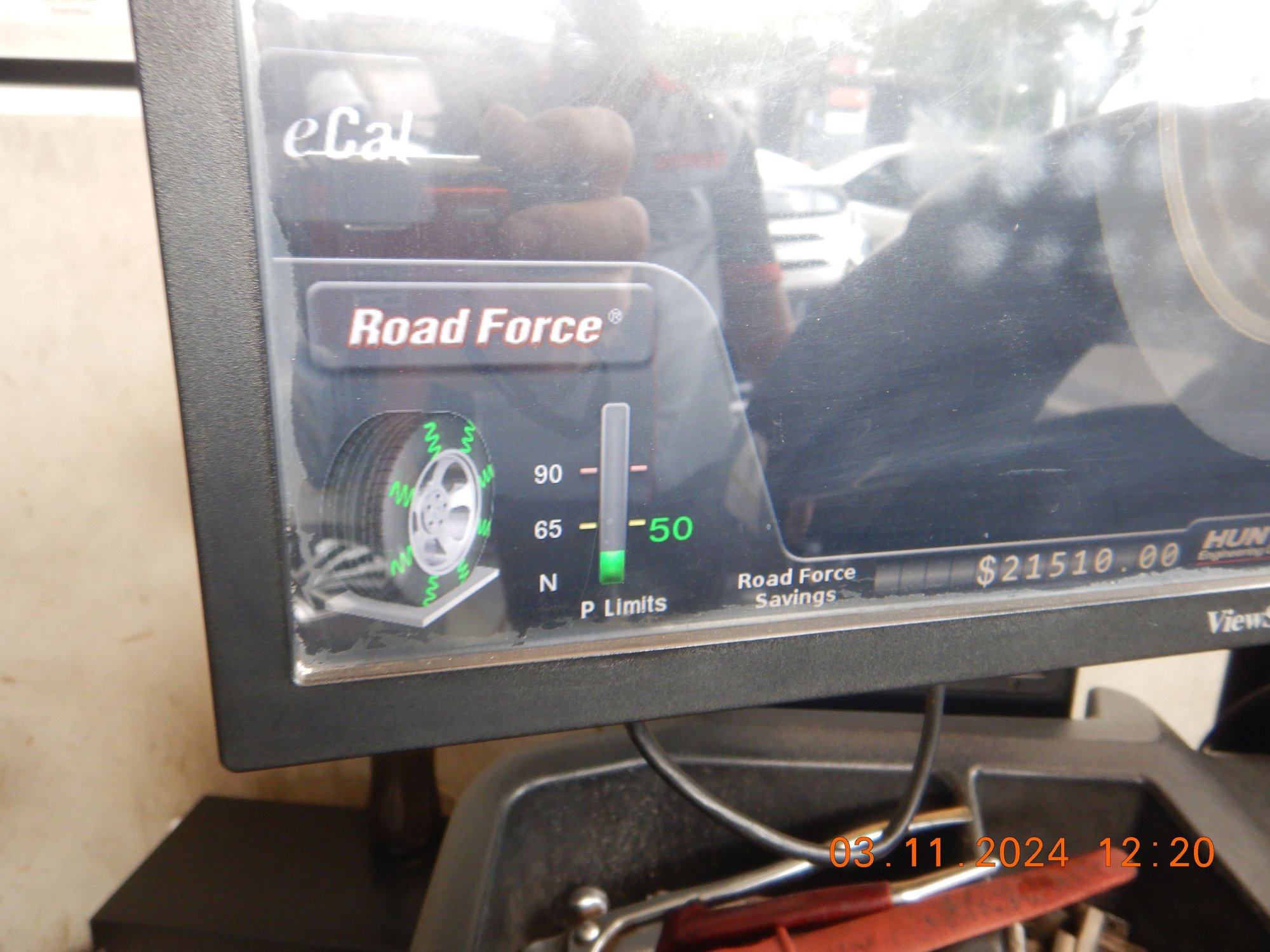

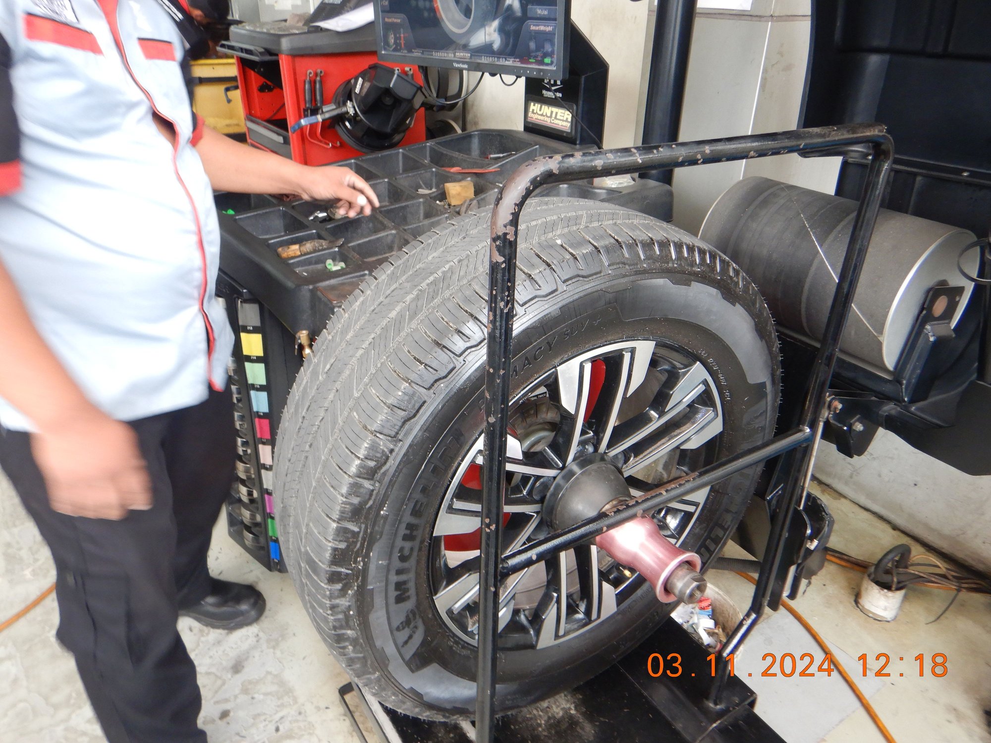

With this RoadForce machine, tire makers are pissed
This is a Michelin Primacy SUV+ which so happened a customer after me and he has good result. I like taking notes that other tires are OK, this way we know the balancer is not the one out of whack ....LOL

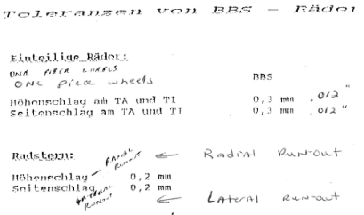

I have just completed testing all 4 last night, their dimensional run-out. Confirmed, only 2 is useable for high speed. One is Excellent, one more is Good. One is BAD and one more TOTAL LOSS.

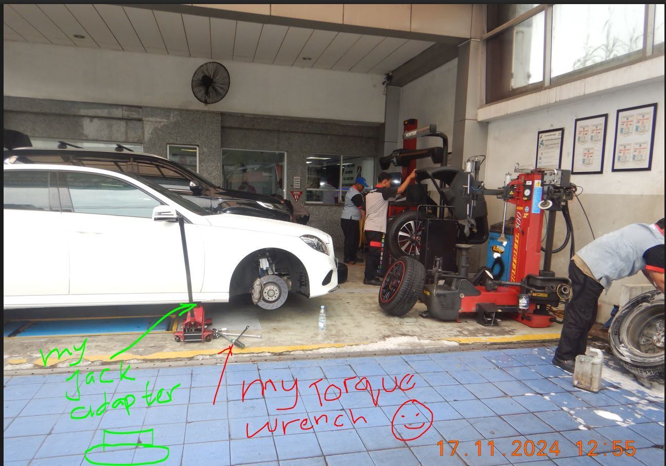

This is supposed to be the top wheel/rim repair facility in Jakarta.

Got the bent FRONT RIGHT wheel replaced, with the best of the pre-owned wheel. Unit 4 of 4.
The bent wheel measured without tire. Some zone maxed out my dial gauge which is only maximum 1.5mm range.

30/1000 inch is 0.762mm.
This number 4 of 4 pre-owned wheel is not bad, 0.36mm inner side and outer side at 0.48mm
I read new wheel should be 0.30 mm easy or 11.8/1,000 inch.
I will measure the new BBS forged RI-A next year when I get it end of 2025. I am curious.
Will also measure the then removed Flow Formed , BBS CH-R Germany ones, the Left Front and the two rears, never measured yet.
My second best pre-owned wheel, number 2 of 4 is 0.88 mm inner side and outer side 0.58 mm
The other 2 other pre-owned ones :
Number 1 of 4 is a total loss as the mid barrel probably 1 mm radial run out, too lazy to measure but visible when I spin it.
The inner wheel side is 0.98mm and outer side is 1.10mm radial run out. Also bad.
Number 3 of 4 is bad at outer side 1.15 mm and inner side 0.75mm. Still useable as desperate emergency spare though.

Correct!, from BBS on the Forged wheels
