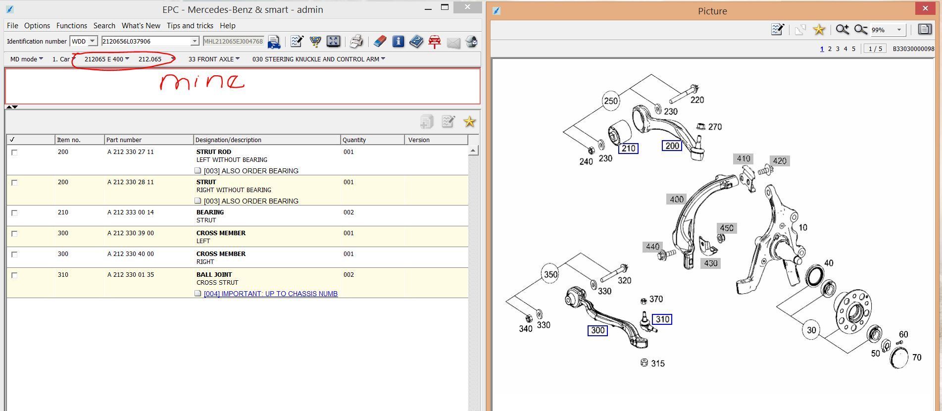

Question: Do you think that it will be possible to remove and rebuild and reinstall the strut and not need to have the front end realligned?

I am ok with rebuilding the struts with new mounts and bearings and I will replace the sway bar link while I am at it as I only replaced it on the other side.

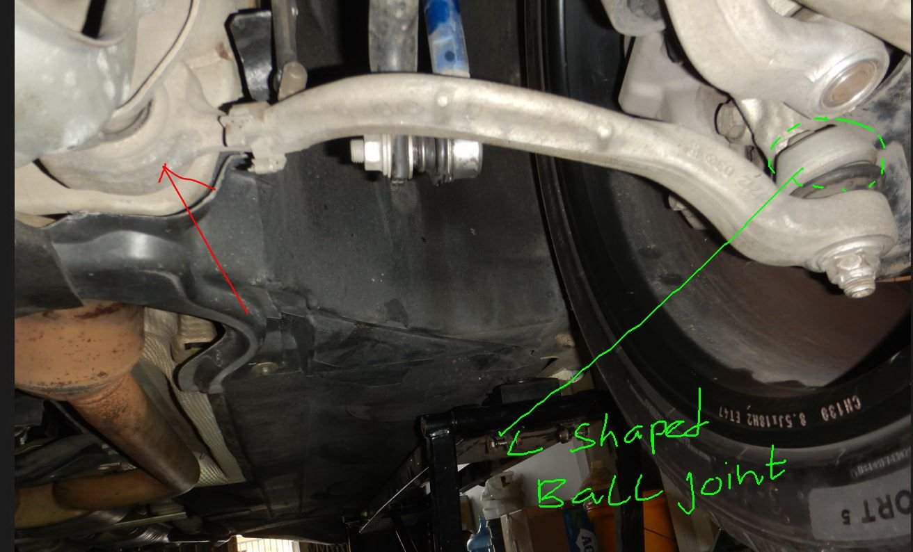

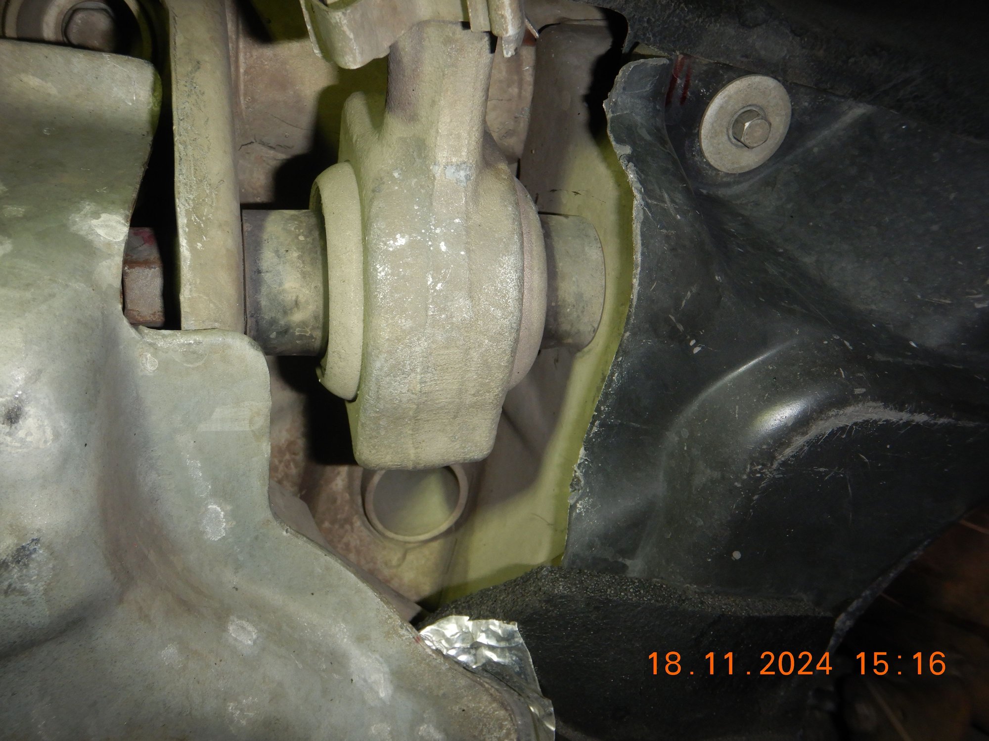

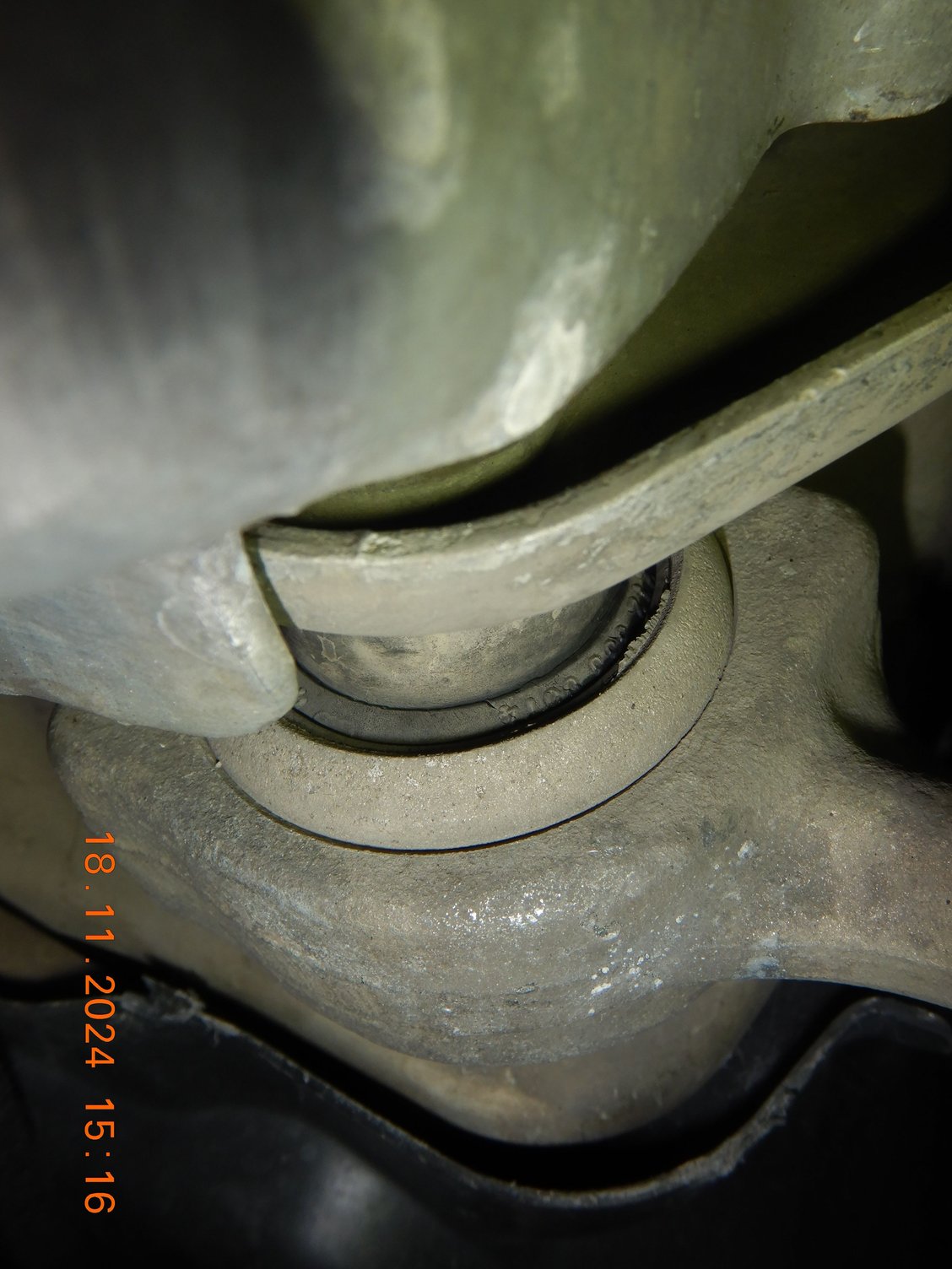

Here u go.............. should be up and running in 20 minutes after I post.
Old Nov 8, 2024 | 10:00 AM
MBNUT1's Avatar
Joined: Oct 2002
Posts: 4,975
Likes: 1,343
From: Cincinnati
2010 E350 4Matic
Thank you for doing that! That is what I expected. But to be completely clear that is the thrust arm also called the upper control arm, the one that connects the wheel to the forward frame member, you perform the caster adjustment to this bolt correct?
Assuming that is the case, it looks like the newly installed bushings have already broken. I don't understand how that happened because I did support the weight of each side of the car with the wheel prior to tightening them.

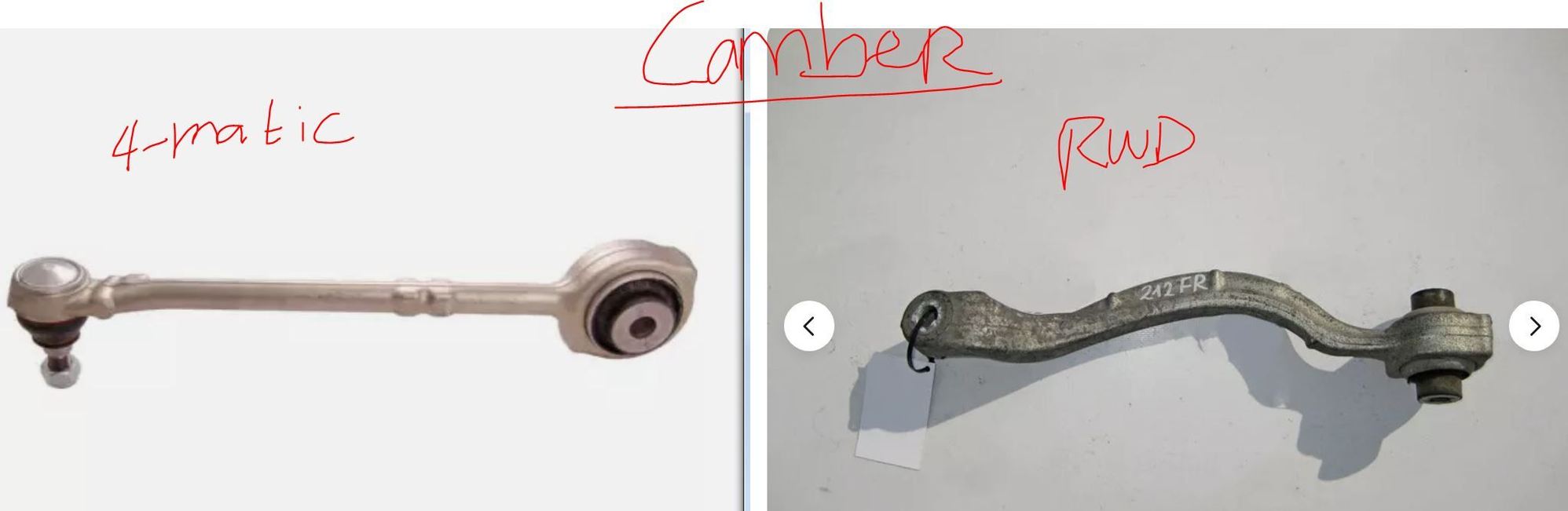

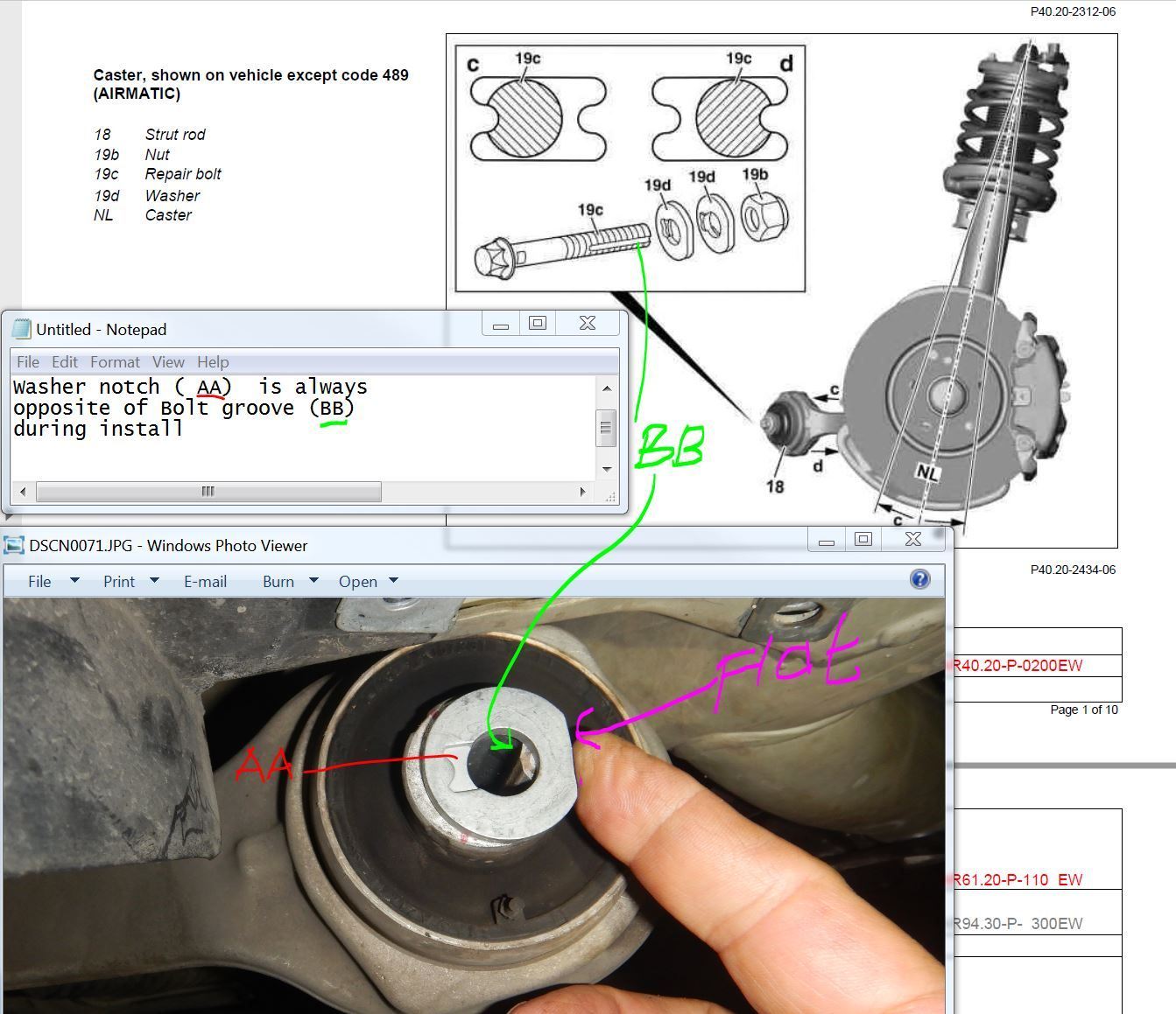

S-Prihadi's Avatar
Joined: May 2018
Posts: 6,600
Likes: 6,547
From: Jakarta-Indonesia
WIS call that arm as Caster Arm.... but not EPC
The Rear one is called CAMBER arm.
I find it easier to name the arm for its function or when correction bolt is needed.

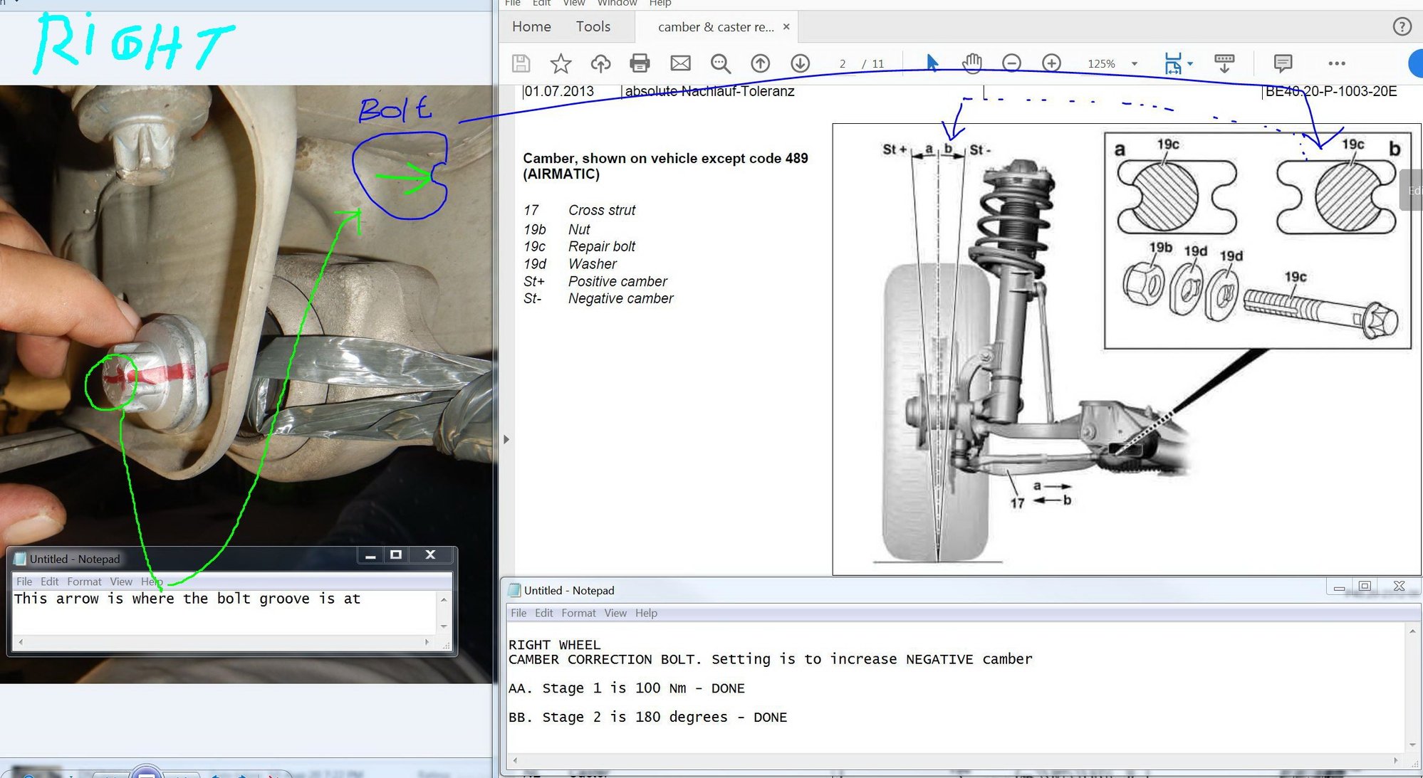

Ok Did you manipulate the caster or camber arm? I am concerned about the caster arm. Though truthfully I expect the same result.
Old Nov 8, 2024 | 10:26 AM
S-Prihadi's Avatar
Joined: May 2018
Posts: 6,600
Likes: 6,547
Yes, it was a really great learning process....... that is why I am very familiar with ride height pre-tension on the bushings and the DO and DONT when doing suspension arms.
Read here : https://mbworld.org/forums/e-class-w...adventure.html

I kind of suspected it was the camber because of how long the bolt protruded from the nut.
Still not sure how the caster bushings will behave if you twisted those the same as you did the camber arm.

Fred,
I am under the car again today, so I thought of your car......
On the subject of the CAMBER arm.
I tried playing with it and it is VERY VERY tough to twist of shake, because its rubber bushing is on purpose made very thin, as to not allow much freeplay.
This is based on my RWD Camber Arm, item #300.
I do not know your VIN, so I am using W212.087 as 4-matic with M272 engine which yours is , being a 2010
Just to make sure component wise you have replaced the correct bushing P/N :
01. Your CASTER arm bushing #110 is not the same as mine, if bought bushing only. Yours seems to be the hydro version, hence it has 2 end caps item #115.
Your #110 bushing A212 333 03 14 ( called bearing LOL ). Yours has 2 end caps #115. Attached its WIS in PDF
Mine #210 bushing A212 333 00 14 ( called bearing too ). Mine no end caps.
Our Camber arm difference.
See how thin the rubber part of the bushing is for my Camber Arm :
Mine - RWD
Mine
Your Camber arm has its on ball joint, I marked it as A.
Me, I got to buy separate ball joint, it is L shaped #310.
This L shaped ball joint is a comfort ball joint and does not last very long. I have replaced mine after track use. Its okey, no sound , but its not as
tight as new anymore.
Any ball joints cam also create a knock if it is worn out.
You have two of them, on your Camber and Caster arm ends.
This is why best to replace Camber or Caster suspension arm as complete assy, easy and worth it if in your case where they both have ball joint at the end.
Happy troubleshooting..........

Thanks for the comment. The bushing of concern is the front caster arm bushing. Based on your prior comments I am assuming that it would provide similar resistance to being twisted as you demonstrated on your camber arm. That being the case I think that the bond between the rubber bushing and the OD of the inner pin must have failed. I have to say they act similar to prior to their replacement which is what prompted the request from you. Part of the point I am making here is that prior to rebushing them and replacing the struts. I had zero noise in the front end. So I am guessing even though they are not right, since they seem similar to how they were previously, I am thinking based on comments from Calibenz, and the other thread were the gentleman had noises that he cured but replacing the mounts, that the noises are strut mount related. Unfortunately we are headed for a bit of a cold spell and my garage isn't heated so it will be a little while before I get the struts back out and take another look at them.
Relative to buying new arms vs rebushing mine. I did consider doing that but; a) My ball joints seemed tight and it seemed like a shame to through them away particularly considering that the part without the bushing cost over $500 each at the dealer. b) could not find arms that contained the OEM bushings and when I researched reviews of the other brands I was very concerned that they weren't hydraulic and would not give the factory road isolation. c) If I was able to get them rebushed and installed myself for like $80 each that felt like a big win.
One interesting comment on your camber arms. They look much nicer than mine. Mine are more rod like whereas yours look more like the caster arms. Nice formed pieces. The must have improved them with the face lift.
