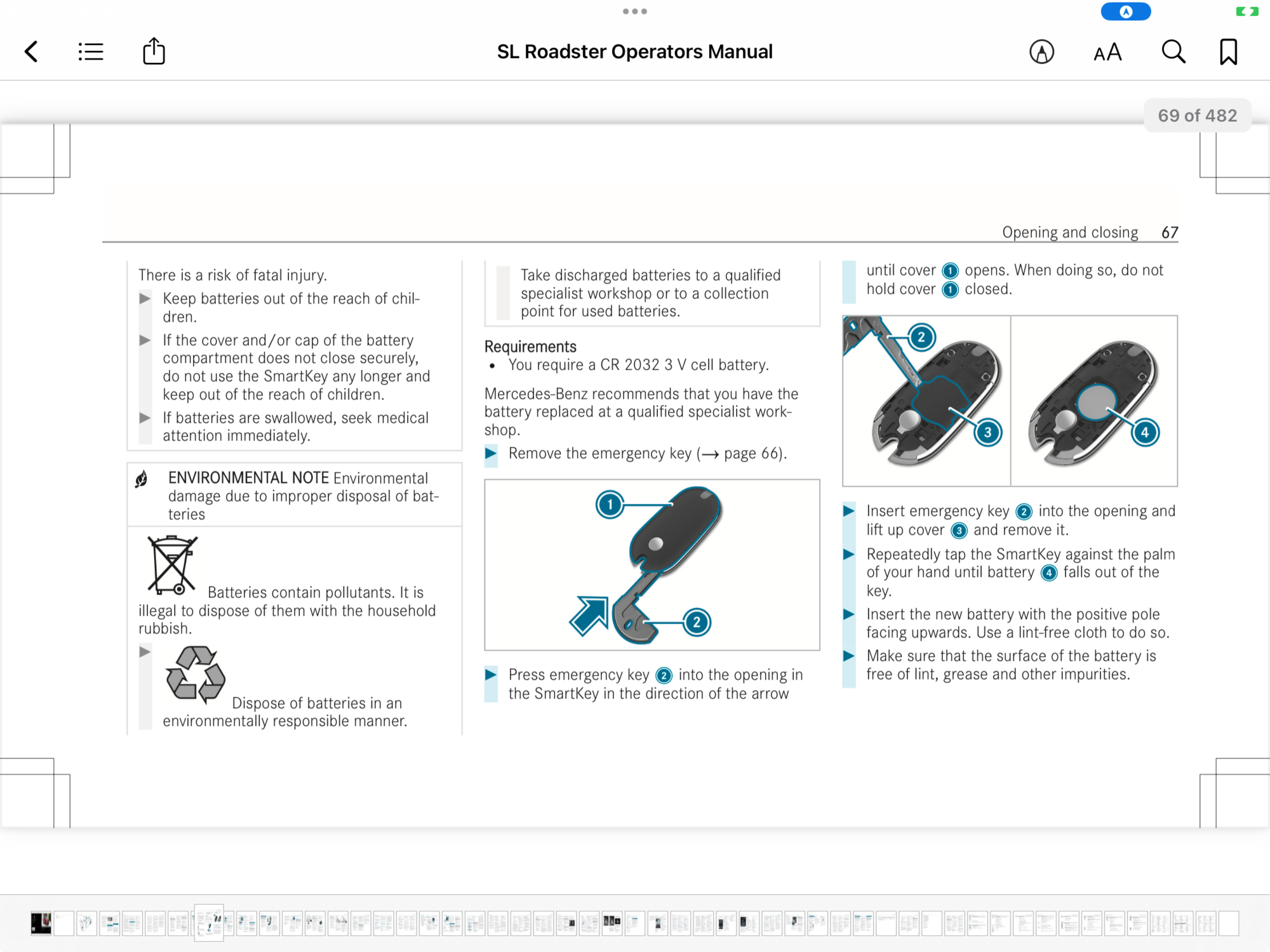

The 2032 battery goes in the R232 key fob.
Here is an excerpt from the owners manual for replacing the fob battery…
I probably should try to post this in an appropriate R232 thread, while I am thinking about it as well.
