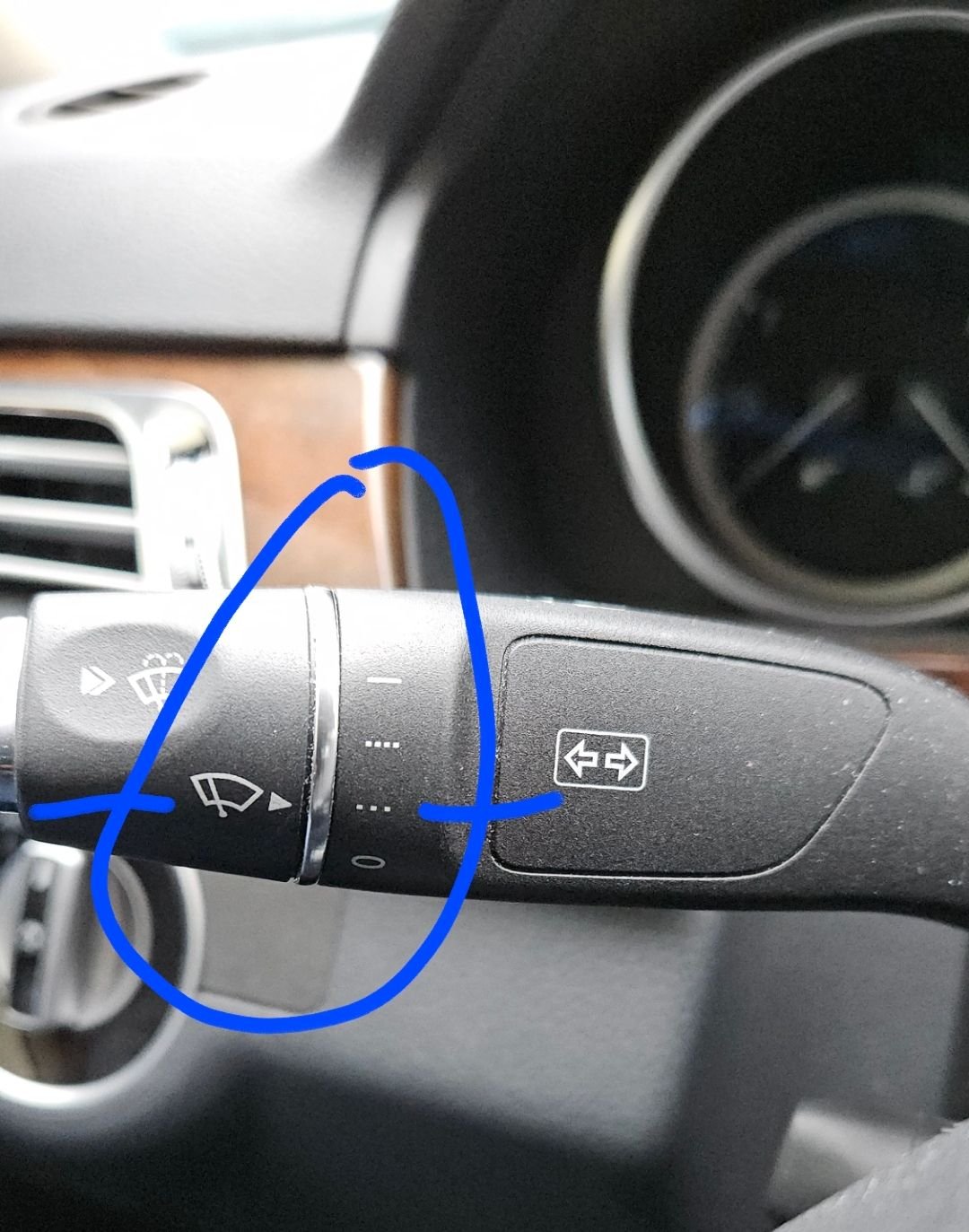

This morning I discovered my LIN wipers now speed up in relation with the car travel. I've never seen this happen in 10-yrs of ownership.
Before the windshield sensor would trigger wipers activation in different modes. Either delayed intermittent pulse according to windshield rain or running ON non-stop.
Now since fixing the ABS/ESP module my wipers speed also varies.
first notch smart wipers
It wipes faster at 40mph than it does at 10mph even in the first knob position.
Serial LIN wiper module is controlled directly by the F-SAM that chats with ESP. Many-many things use wheel speed data.
When solderless ESP stutters many performance go missing quietly such as ECU/TCU GDI timings.

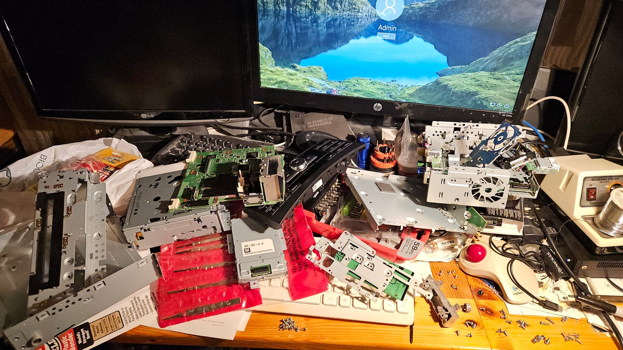

MISBEHAVED GATEWAY ENHANCEMENTS....
I am strongly motivated with dumping the bugs out my wonderful German system.
Canceling painted circuit GND and solderless modules has been very rewarding so far.
COMAND is a gateway...
COMAND is a gateway... Let's go see it then!
COMAND gets out
COMAND gets out
COMAND components being aired out
50 screws and a fair mind is all this took yesterday.
COMAND is thus proven not to be a solderless chaos provider.
This begs the question... :
- what remaining module is providing CGW with chaos ?
Let's see what shielded harness improvements give us:
-1- On the low speed busy CAN-B
-2- On VIP higher speed buses (to: MFK, ESP, ISM)

Back on topic, I've read my W212 owner's manual on windshield wipers (p 125-129), and I see no mention of "speed sensitive" wipers. Instead...
The "Intermittent" feature functions based on the amount of rain falling on the windshield. Naturally, the faster you drive, your windshield accumulates more water. BUT it's not based on speed (directly), but rather the amount of water hitting the rain sensor.
I keep my wiper setting on Intermittent as the default. Just as I see the wiper rate increase from 30-40mph, I also see the wiping slow when stopped at a light. Same amount of rain, just not the same amount falling on the sensor. You can think of it as speed sensitive, but it really isn't.

AUTOMATICALLY VARIABLE WIPING SPEED...
Thank you for checking the user manual for speed sensitivity.
Your explanation of sensor makes good sense if sensor supports measuring rain qty besides:
1- Wipers Off
2- Intermittent delayed trigger
3- Full On non-stop
4- [automatic wipe speed: really slow to extremely fast]
- It's not impossible but I doubt the windshield sensor has the ability to vary wiper speed based on rain quantity.
- I have never seen wiper speed vary automatically since I resoldered it many years ago.
- It hardly ever rain in Sunny California so I don't have a lot of benchmarking opportunities.
- Wipers do have more than one user selectable speed. I have never seen speed vary automatically based on vehicle speed or windshield rain film.
The owner manual should have described that better.
