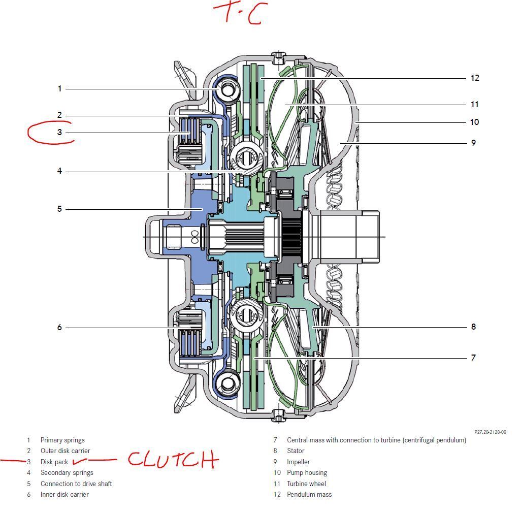

Wow...torque converter went bad in 2022 ?
What actually happened to TC according to MB guys ?
When TC replaced, most likely they will drain the tranny fluid as best practice.
If the TC shed its clutches material ( one of the failure mode), what you are now experiencing could be those "dirt" have traveled to sensitive zones.
I would think if and when a TC is replaced due to failure, they would at the least tear open up to the conductor plate and valve body and all the oil valves and flush the tranny oil cooler too,
to clean the shredded "dirt".

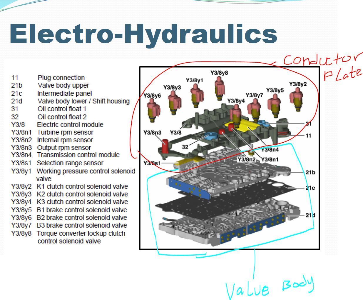

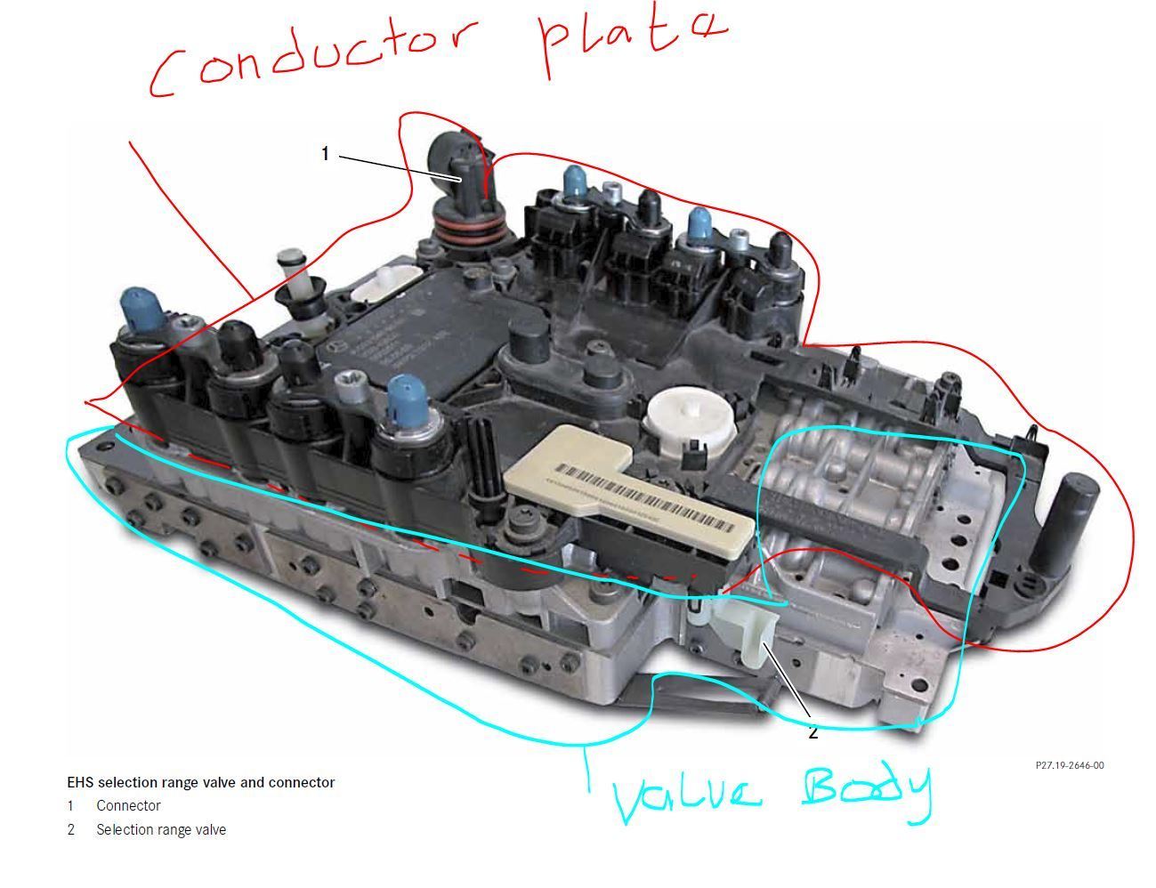

Want to see how small the oil passages are and how may small check ball , etc etc inside the valve body : https://mbworld.org/forums/e-class-w...-so-small.html
At the least replace your tranny oil + filter first, before doing anything else.
Thanks for the pictures. That is some awesome info for someone like me who don't know much about what is going on there.
For the TC replacement, I experienced shudders especially around 60 - 65 mph or when starting from a stop light. They diagnosed it as bad TC and replaced when it was under warranty. Kept it for about 2 weeks mostly I guess for the part to arrive but not sure what else they did. All I see is the part number and work info on receipt.

Oh boy... If the TC contaminated the transmission, i.e., left debris within the transmission regardless if MB changed the oil 100 times, the original work is still pending to be fixed. Summary: I am surprised MB only changed the TC and not the whole thing: torque converter and transmission.
If a fluid drain and exchange improve it considerably, here is my summary: the remains of the original problem is still there, i.e. debris, and you may need to service that transmission more often than the manual states.
