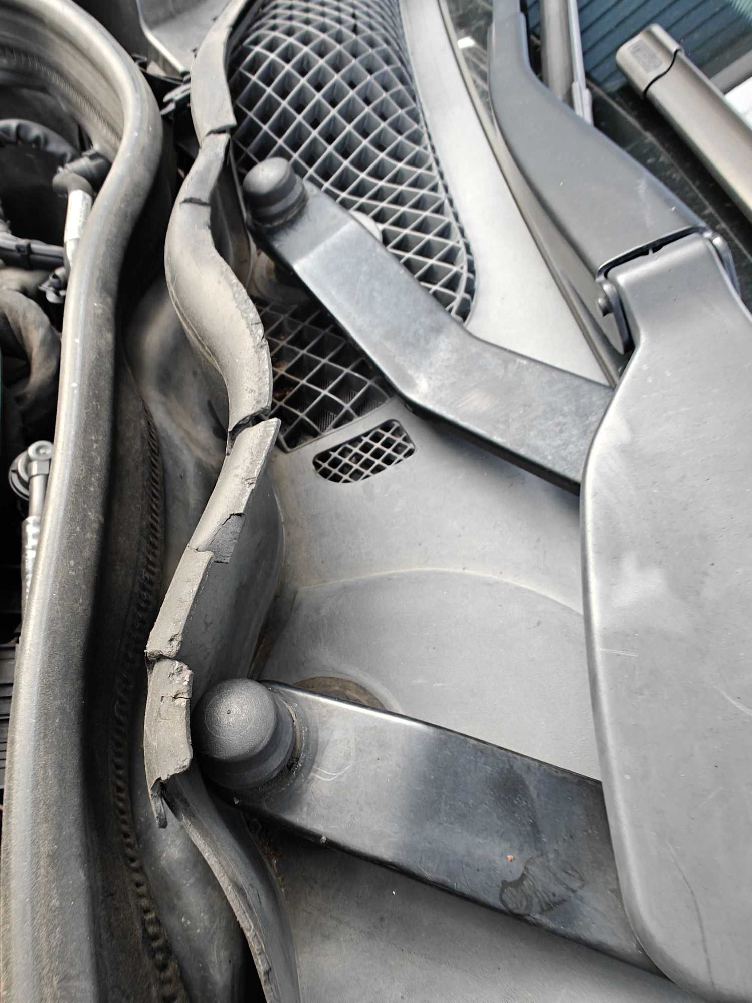

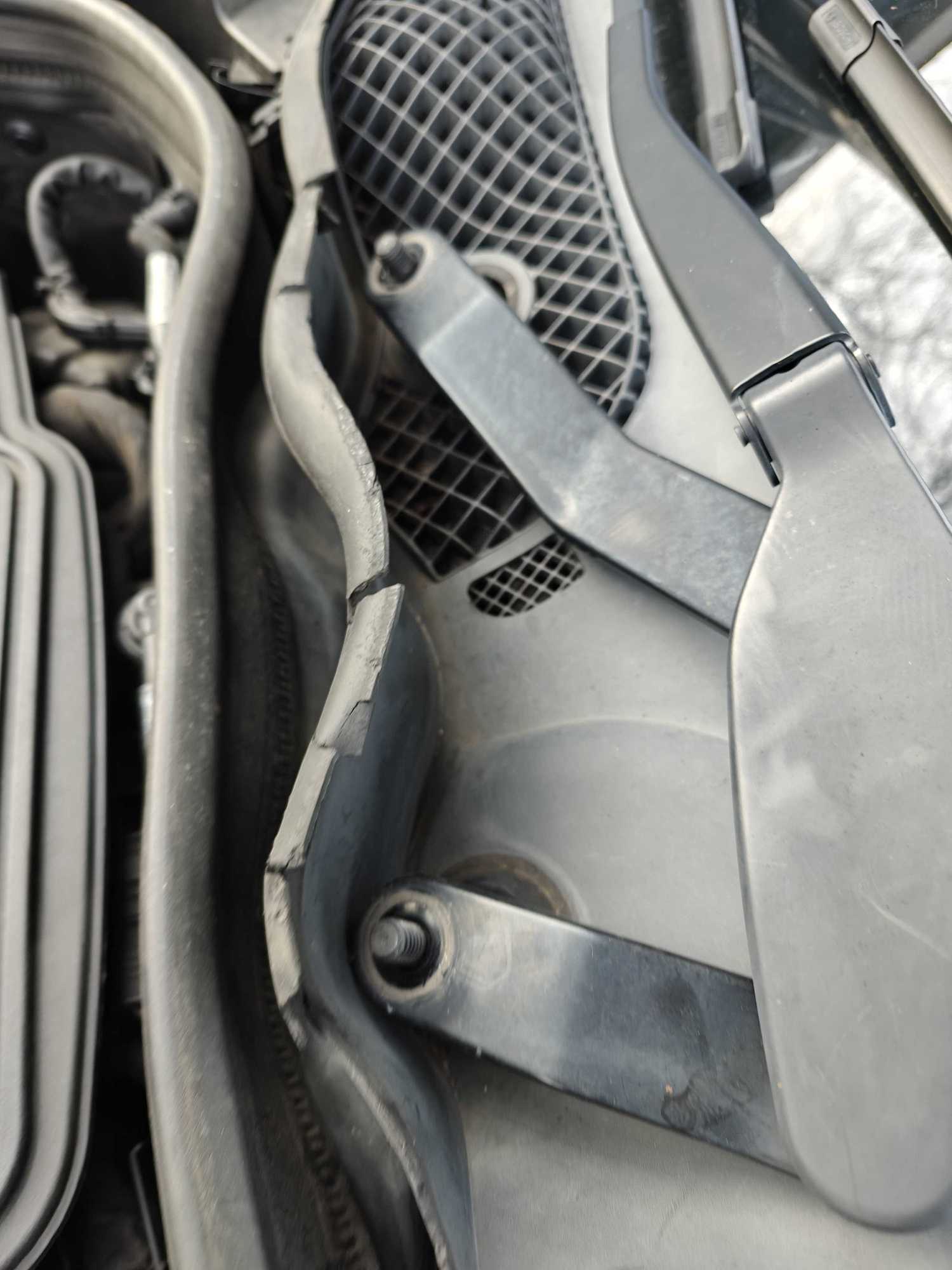

All right, getting down to business, I had parts for replacing my drip tray because the rubber sealing material was mostly missing and the squirters for no particularly good reason other than the hose felt a bit stiff. My wash bottle had been leaking since I got the car, so I decided to finally re-do the whole system. Previously, I replaced the heater line from my firewall because it was spraying out coolant like arterial bleeding. After this job, only the level sensor and squirter pump have not been replaced.

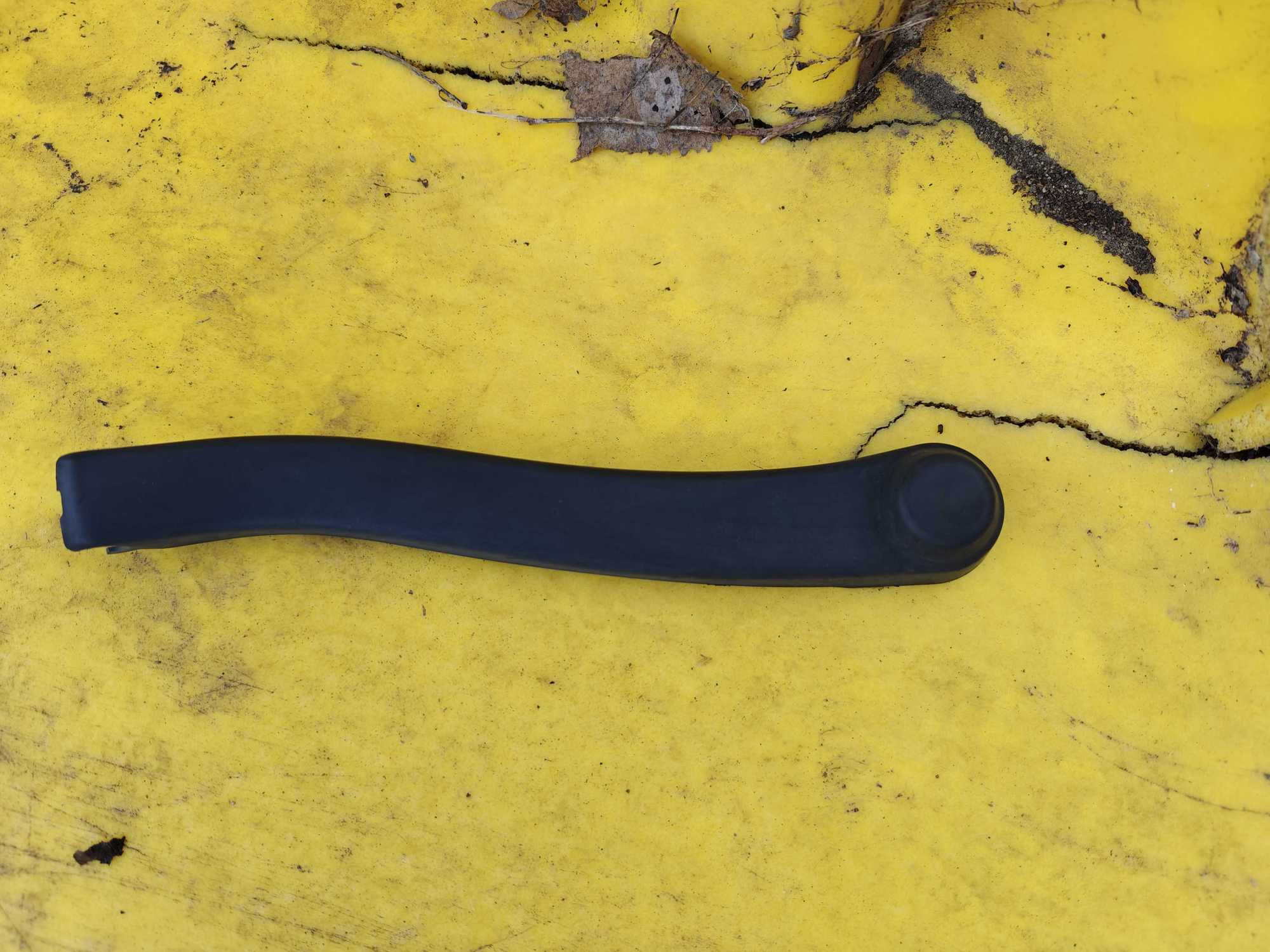

I started at the windshield and removed the covers to the wiper nuts:
These just pry off. The small round ones are rubber and you can't really break them or deform them. The large piece is plastic and just snaps off. Getting under it isn't a big deal.

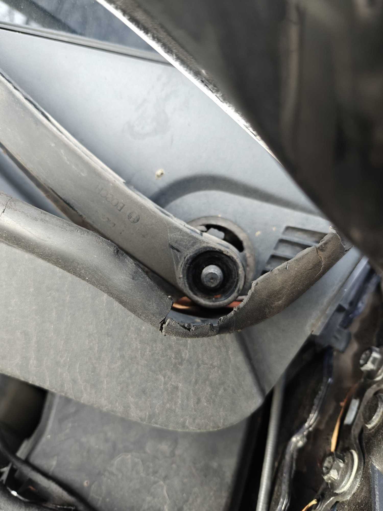

Getting the wiper arms off the spindles can be tricky. They are splined on. 2 of them came off with a plastic deadblow hammer but I didn't want to increase the brutality on the 3rd one and it wasn't budging, so I broke out a gear puller:
After the wipers were out of the way, I removed the plastic rivets holding the drip tray on:
There are about 4 of these, but one of mine was missing. No big deal. With the rivets out, you can just lift the drip tray up at one corner, get it out from under the windshield trim, and unsnap it from the groove below the windshield.

As mentioned earlier, the first 3 attempts at installing the wiper arms didn't go well, but eventually I found a position that worked. Then I snugged them down tighter and put the plastic caps back on.

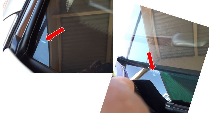

I tried to find the very detailed guide for setting the parking position of the wipers that I saw before for the W211, but I was unsuccessful. I found this diagram for the W220 though, showing the marks on the windshield that tell you where they should park:
There should be something similar for the W212. It's a bit sensitive, but I was able to get it right by trial and error. I think my wipers wipe better now than before I readjusted them inadvertently. There's only about 50% as much flutter.

Thanks for the links. One of the docs you posted does show where the park position markers should be. I couldn't find them, but they are smaller than on the W211 (dots instead of lines). I'll check again later when it's not raining.

Use a torch light and angled it some, the line is under the glass and very very NOT OBVIOUS if not using torchlight assist.
