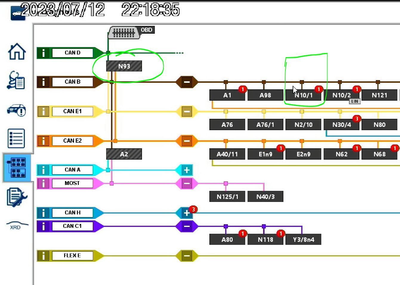

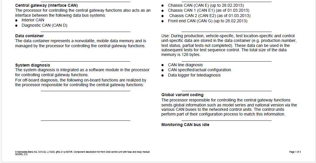

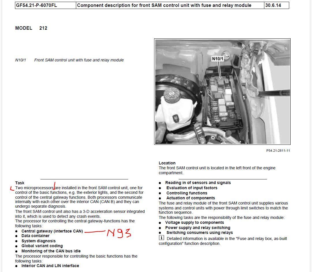

Meet CGW & F-SAM hidden as the engine bay fusebox:
the front fusebox is the main Signal Acquisition Module+ Gateway

Originally Posted by Plutoe
poster 13----where were you 13 posts ago as prior I have never heard so much mis information and sheer BS form so called wizardz in my life,but they love the comedy entertainment
Look at post 12 the SAM is not a gateway aka a router, te SAM is a control module
Look at post 9 there is no chaos built into the W212, W 211, W210 or W213 they all have organized electronic systems to manage communication
Usualy idiot have a loud mouth , but some who has so much hatred in his heart towards helpful members.... have even a LOUDER mouth.
Front SAM has dual duty dude !!, it also contains N93 Central Gateway. This is not the same gateway as the other gateway called N93/7 Chassis Gateway for Code 23P cars.
Go and spend your time reading on W212 CAN BUS topo, stop making a clown of yourself over and over again. See a shrink immediately.

@S-Prihadi what's your point here?
SAM - Signal Acquisition Module and it controls basic functions like light's, etc
On w212/204 chassis, as you already posted the N93 ( CGW) and N10/1 (Front SAM ) are two modules completely different ( 2 different processors...) integrated under the same case and PCB
The processor corresponding with CGW manage the functions like any other separate CGW from any othe chassis including Data Container, System Diagnosis, Global Coding, etc
On w212 23P, there is indeed a second Gateway, but this is a Chasisis /Drivetrain Gateway that manages some extra functions and hardware.
This is the precursor of CPC.
Both 23P and non-23P vehicles still use the common CGW inside the case of Front SAM for connecting to the OBD to broadcast messages to all CAN networks, to monitor System Diagnosis, to keep Global Codings and so on.
I see nothing wrong on @Plutoe statements.
I also strongly believe in this:
"no chaos built into the W212, W 211, W210 or W213 they all have organized electronic systems to manage communication"
