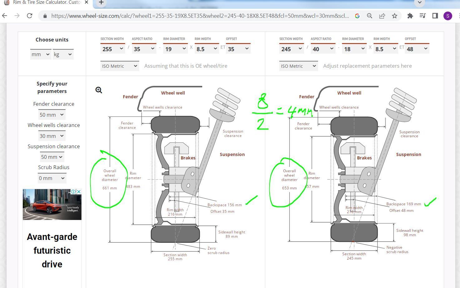

ET35 vs ET48 standard, 13mm your tire is going OUTWARD.
Well that is the mistake you did.

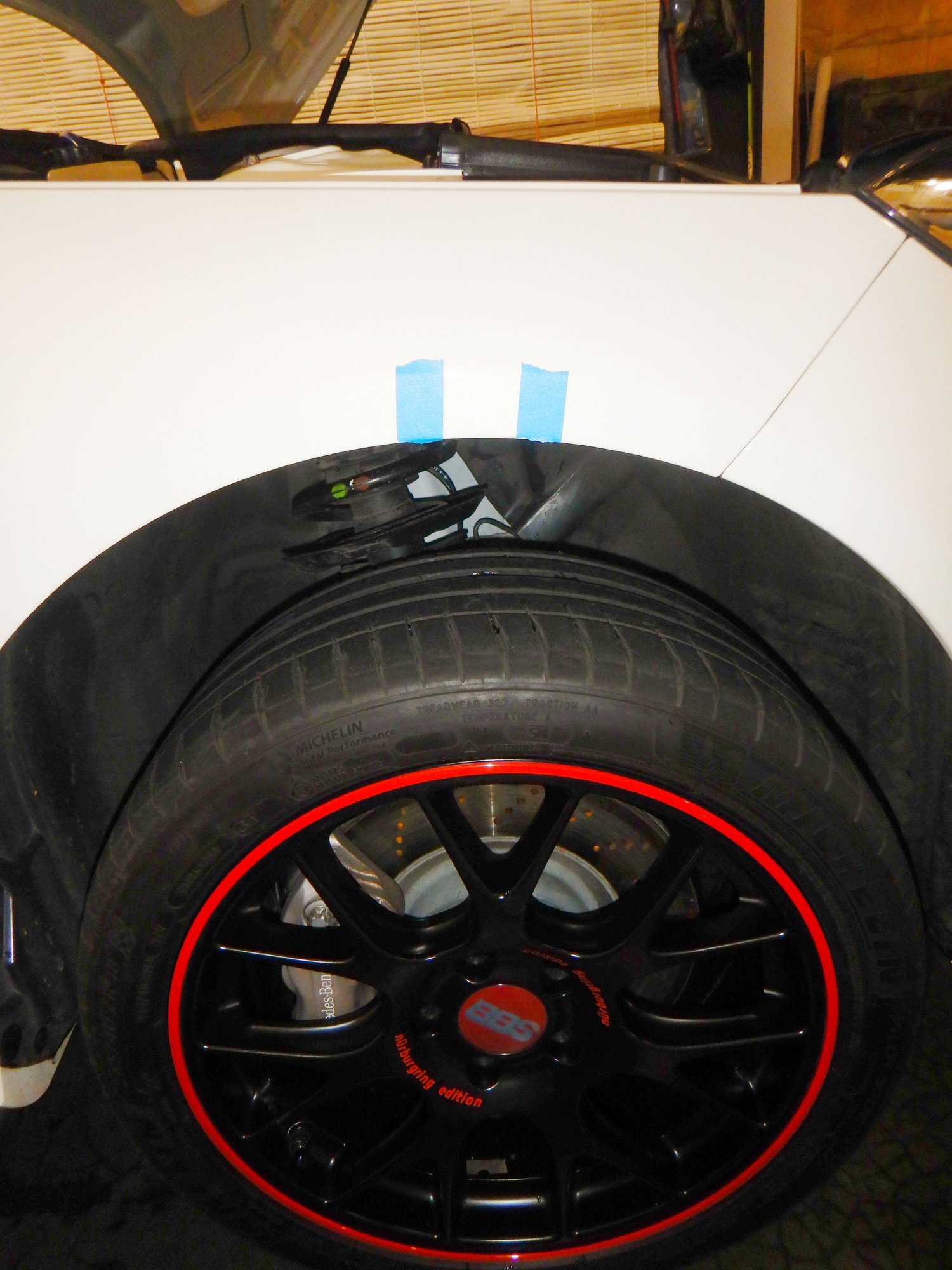

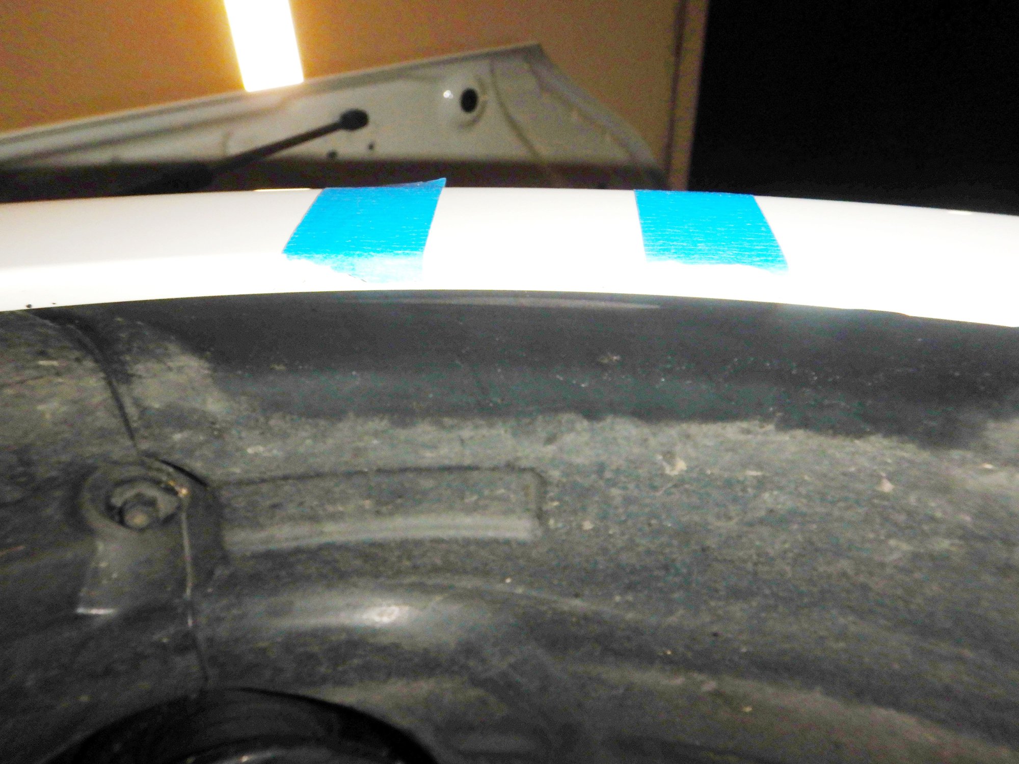

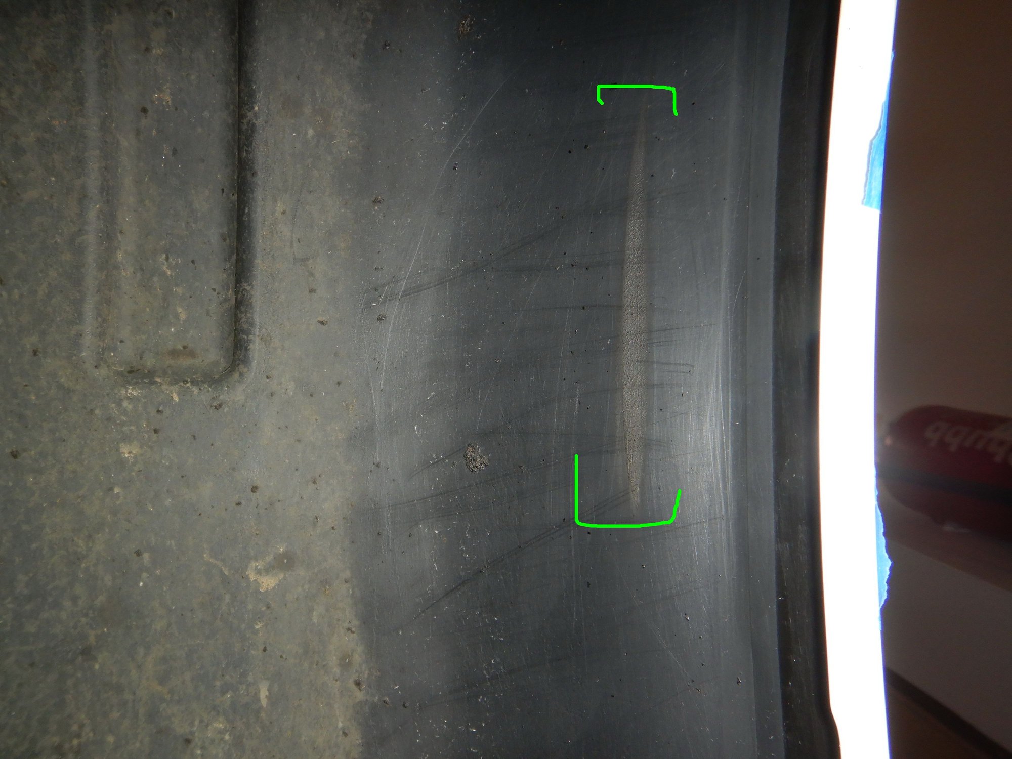

Even me at 6mm extra outward due to spacer and Et48 to ET47 , long story on the 5mm spacer....if I go really fast like 100-120 MPH and hit bridge to road joint, making my front suspension
full bottom out, I get scrubbing a bit. In normal use case, no scrubbing.
See photos below :
Keep this in mind : Fashion vs proper spec, proper spec must come first.

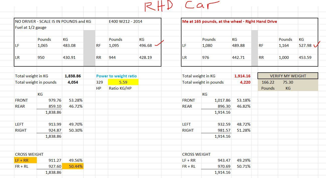

Mine had that single rub event on the driver side only. My car is RHD, yours is LHD.
I think its because of our body weight.
Where you sit, the suspension at that side carry more weight.
I do not know how many kilograms per millimeter is our spring type, but I suspect it is like 5 to 6 Kg per mm.
Thus my right spring get compressed more by 37kg or 7.4mm ( using 5kg per mm ) , compared to left side.
This is the same as my car is lower by 7.4mm at the right front wheel vs left side. So more chance to scrub the plastic fender.

Ooops, your tire is 255 / 35 - 19, ( I assumed 245 ).... its even taller than standard 245 / 40 -18 by 4mm. So more chance to scrub plastic fender too.
