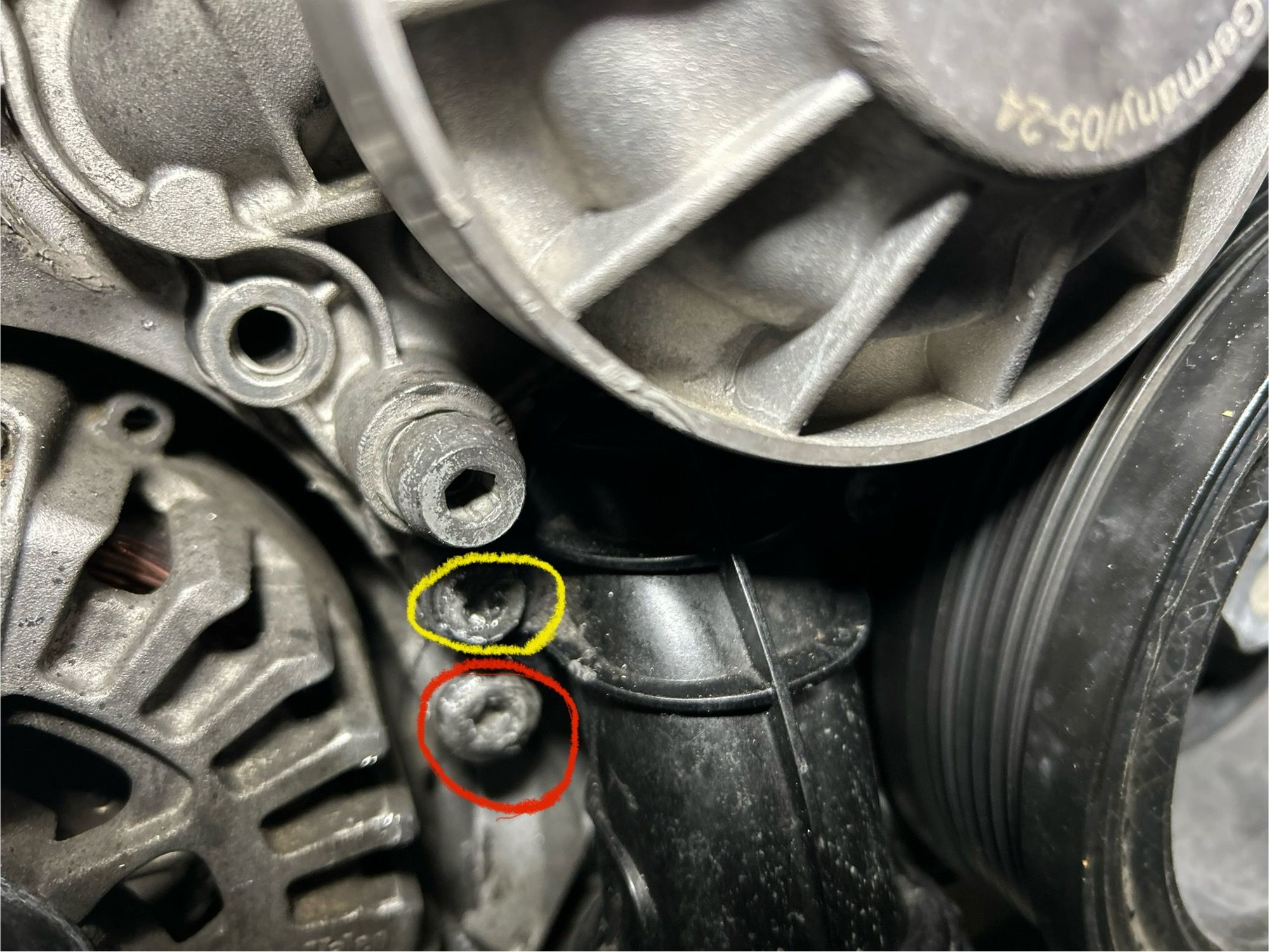

hi,
I am replacing the coolant pump, and I am stuck with a t40 that wouldn't budge. It is slipping very bad. So is the case with the T30 that is holding the coolant inlet -yellow circle. I tried pb-blast and tried twisting the screw with hammering with screwdriver. No luck. Any one have any experience with removing difficult screws?
[img alt="The red circle is the t40 holding the pump and the yellow circle is the t30 holding the inlet pipe. Both are slipping.
"]https://cimg8.ibsrv.net/gimg/www.mbworld.org-vbulletin/2000x1504/img_7870_d1ada22a9e888b60187160919cc255d765197e74. jpg[/img]

Many thanks to everyone for being so helpful. The T30 (yellow circled) and T40 (red circled) finally gave in today. I have attached the images.
Since both the T30 and T40 were slipping, I had to remove the inlet to get better access to the T40. I used my grinding tool to cut a slot into the T30’s head, then used a screwdriver and hammer to drive it out through the notch—you can see the final screw head! Once the T30 and the inlet were out, I finally had room to work on the T40. This time, the bolt extractor fit perfectly onto the T40 head and I was able to break it loose without issue.
