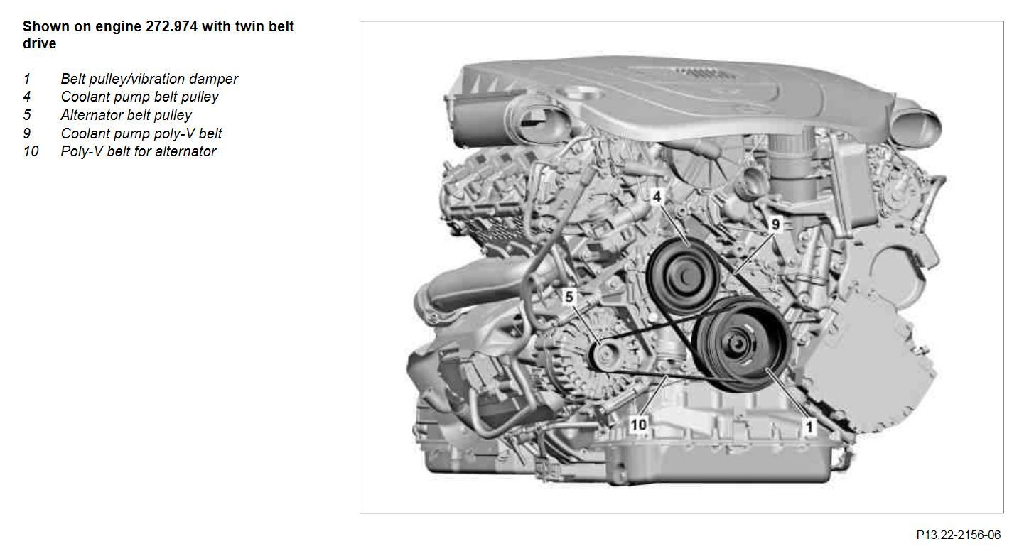

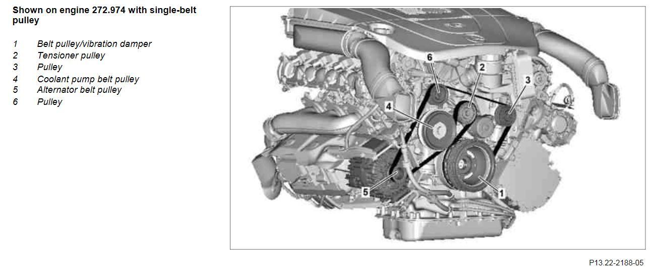

My belt fell off I’m trying to find the correct diagram online but I can’t find it …. Anyone know where I can get correct diagram??
what engine type/yr ??

Old May 6, 2025 | 10:37 PM
donny79's Avatar
Joined: Jul 2021
Posts: 184
Likes: 16
e350
No I have w212

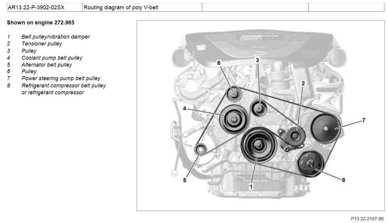

Old May 6, 2025 | 10:45 PM
donny79's Avatar
Joined: Jul 2021
Posts: 184
Likes: 16
e350
M276 engine I think I found it
Old May 6, 2025 | 10:46 PM
S-Prihadi's Avatar
Joined: May 2018
Posts: 6,600
Likes: 6,547
From: Jakarta-Indonesia
Take a wide angle photo of your engine front.
A few photos left to right to make a panaromic view of all involved pulleys , will be good.
We can figure it out with above photos because some pulley/s is only allowed to receive the back side ( smooth) side of the belt, not the ribbed side.

Old May 6, 2025 | 11:44 PM
donny79's Avatar
Joined: Jul 2021
Posts: 184
Likes: 16
e350
@S-Prihadi yes you were right that diagram you sent was it, I had to come outside because it was driving me nuts , that’s right one thank you

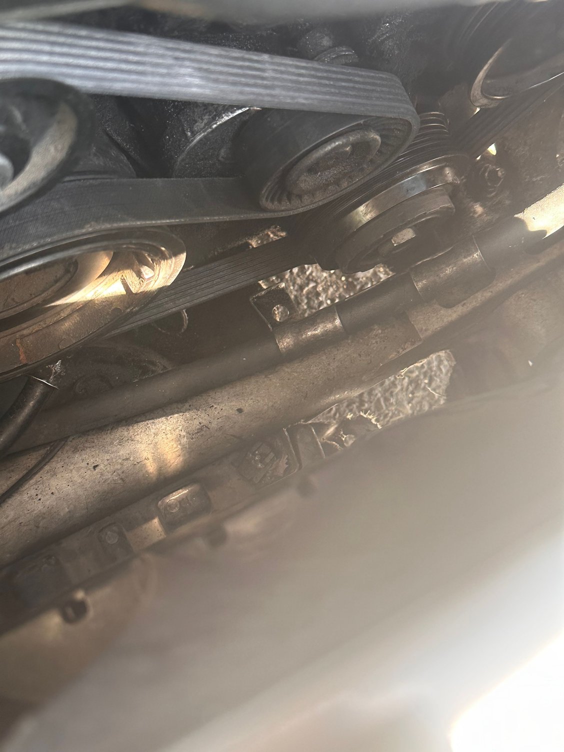

Is this right placement for the belt on tensioner? I had it in the middle and when I started the car it moved to the end and I shut it off, is this normal place for it on the end like that?
Old May 8, 2025 | 01:50 PM
CaliBenzDriver's Avatar
Joined: Apr 2019
Posts: 11,923
Likes: 6,776
From: Silicon Valley
W212 MY'14 M276-3.5NA @75kMi
NOT BELT.... KIT
that section looks right.
Compare that you did follow the whole routing correctly, true?
Did you check idlers freeplay??
Specialy the one after your steering pump.
BTW the old tensioner NEEDS to get replaced else your new belt will be short lived. If you must drive like this... do not run A/C compressor to prevent slippage.
FYI : this is potentially unsafe repair as your steering pump runs from shared belt.
Loosing belt stops steering assist without warning. I've had that happen to me while turning so I can warn you about loosing steering.
Service requires a kit: [tensioner + idlers + belt] at once.
Besides inspect steering high pressure hose for active leak.

Ya I did it pretty quick once I had diagram, new tensioner will be here Tuesday , I let it run for a while seems good to go I just don’t know if that belt to close to the edge, I had it lined up in the middle as it ran it moved to the edge…. Ya other day I was on real busy hwy right around a bend and I heard flapping , when I pulled over the belt was shredded, my tensioner I replaced 2 years ago the wheel had a slant and belt kept slipping I’m hoping I can drive this till new tensioner comes in
Old May 8, 2025 | 02:18 PM
Joined: Apr 2019
Posts: 11,923
Likes: 6,776
don't discount the plastic idler pulleys with the dry bearings.
They actively guide the belt in position.
When idlers are wobbly... then belt is all over the place as you describe.
You need to inspect every unit for freeplay:
  1. ALT
  2. Water Pp
  3. Idler pulleys
  4. Steering Pp
  5. A/C compressor
  6. Main harmonic balancer
Main crankshaft pulley also designed to require replacement. It uses rubber that turns into chewing gum to wobble 1st class.

It’s on correctly, belt in the grooves, no noises, I just wasn’t sure if belt was supposed to be on the edge like that, nothing wobbling or anything like that
